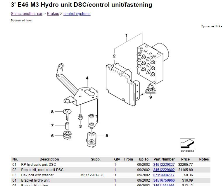

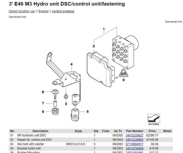

    According at my Realoem and the ABS part numbers installed on the M3, this is what I found:
    My part numbers might be 34512229827 (Pump unit) and 34512229802 (DSC control unit)
    Click image for larger version  Name:	qdN6UDc.jpg Views:	0 Size:	51.5 KB ID:	61568

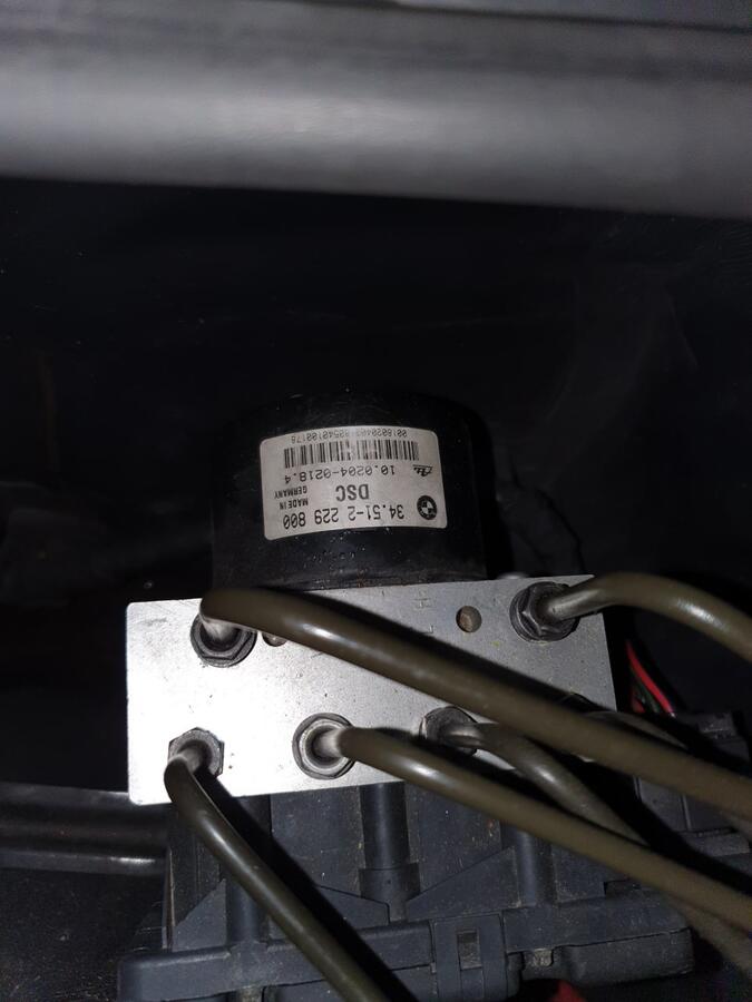

    That´s what I found at the car:
    34512229800
    Click image for larger version  Name:	JK4qIHC.jpg Views:	0 Size:	44.8 KB ID:	61569
    2229801
    Click image for larger version  Name:	FGAsEOK.jpg Views:	0 Size:	94.6 KB ID:	61570

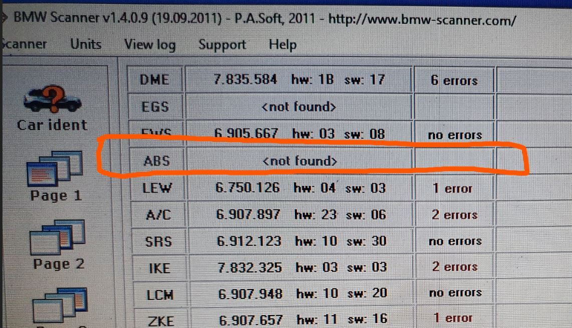

    And then, started myself with the tests (I have all the BMWScanner and INPA related software at two different laptops, one with W10 and the other W/XP 32 with the exact same results), but bad news started soon... watching the videos, even with BMWScanner, you can scan and see the error codes of the faulty units, no matter if is the original part or the donor part, but... this is what i found at my BMWScanner scan:
    Click image for larger version  Name:	QpDyyG5.jpg Views:	0 Size:	208.4 KB ID:	61571
    Why can´t even the ABS unit be scanned?

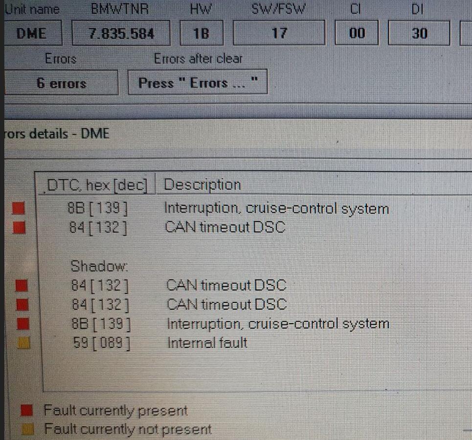

    The others that I found could be related with the same issue:
    DME
    Click image for larger version  Name:	DfeWPDx.jpg Views:	0 Size:	191.3 KB ID:	61572

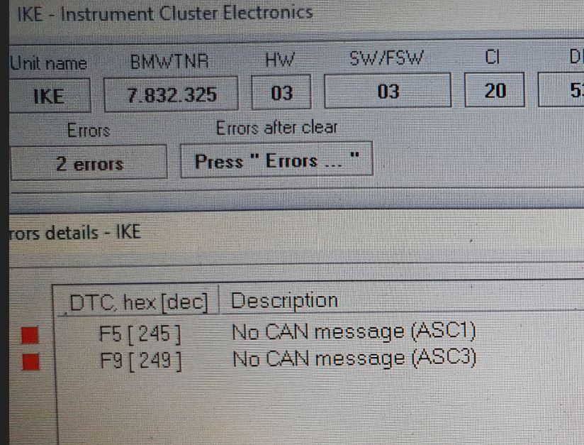

    IKE
    Click image for larger version  Name:	8njll0F.jpg Views:	0 Size:	128.6 KB ID:	61573

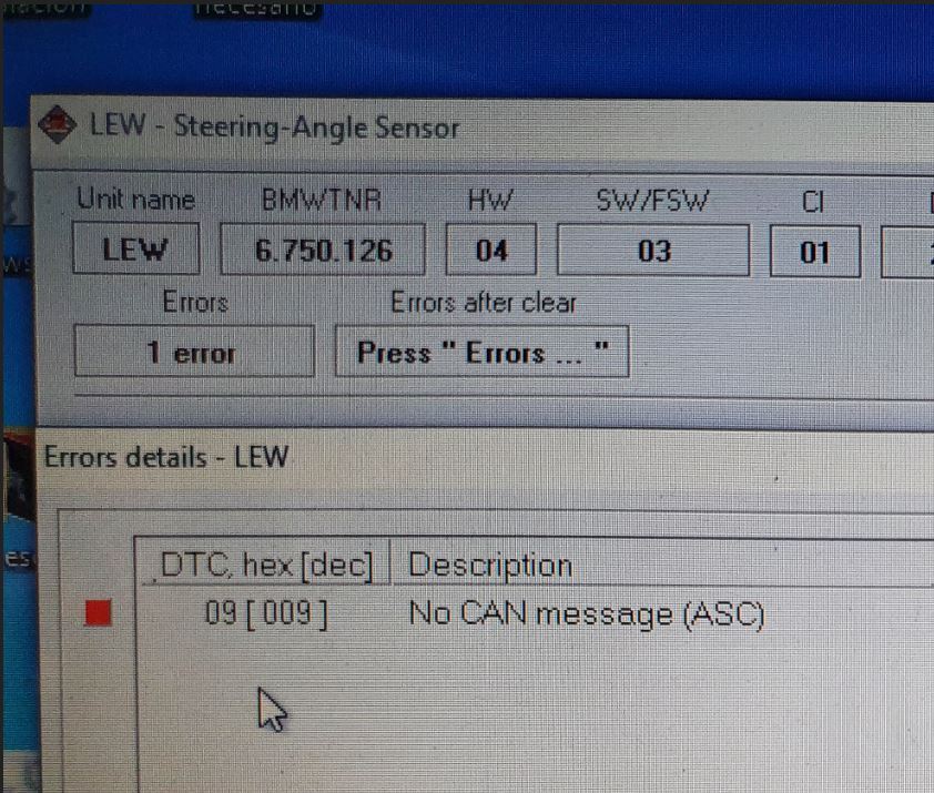

    LEW
    Click image for larger version  Name:	PRBSzmA.jpg Views:	0 Size:	132.2 KB ID:	61574

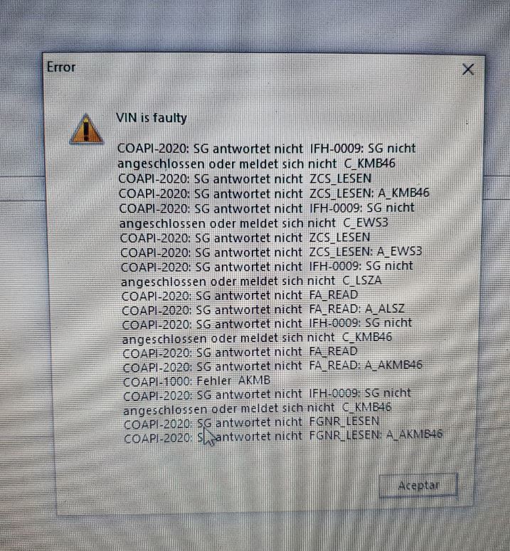

    Tried with INPA, NCS Expert (with this last at least to see if it can recognize any module) But INPA just shows two errors at the engine, can´t check all the other parts (Chassis, body, etc...) showing this error, which could be my stupid cable:

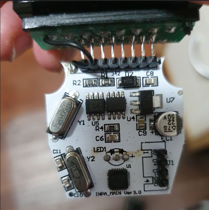

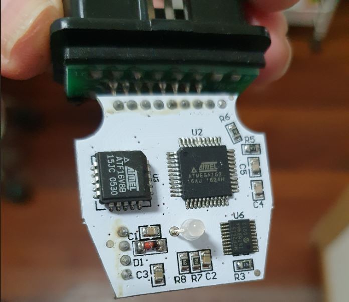

    My cable could be the culprit, based on this info may be not the right one...:
    (PDF attachment at the bottom of the 1st post)
    I ask anyone who is having issues with their devices, or has a device confirmed to work, please contribute some information to any section or PM suggestions. there have been lots of discussion in the tuning thread or the boot mode thread. PURPOSE: I would like to iron out the differences among...
    Opened mine and it looks exactly like the named as "bad white"
    I think that it´s not the right cable (No FTDI/ FT232 chip)
    Anyway BMWScanner has another cable which seems always to do the job...Do you guys know what could be the reason because the scan doesn´t shows the ABS? I´m new with this but was thinking that even a faulty unit should show info... So I don´t know if I might find another used unit, or this maybe is not the proper unit...
