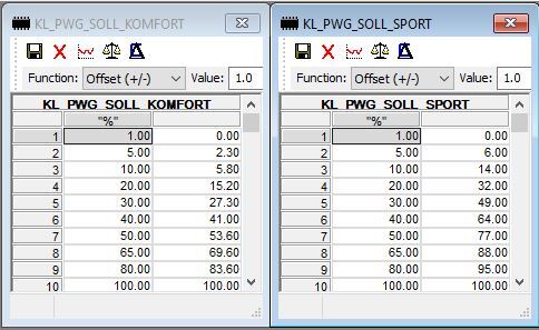

    I brought my laptop out to look at an E46 today so I figured I'd take a picture of my maps. I'll post pictures and tell you pedal to throttle percentage. The first number will be physical pedal percentage and the second will be commanded throttle to that percentage.
    Comfort:
    1% : 0
    5% : 2
    10% : 5
    20% : 15
    30% : 24
    40% : 33
    50% : 43
    65% : 50
    80% : 57
    100% : 65
    Sport:
    1% : 0
    5% : 6
    10% : 17
    20% : 29
    30% : 46
    40% : 59
    50% : 74
    65% : 85
    80% : 92
    100% :100
    Click image for larger version  Name:	20200430_232925.jpg Views:	0 Size:	73.5 KB ID:	19534
    Click image for larger version  Name:	20200430_233022.jpg Views:	0 Size:	73.7 KB ID:	19533

  • Martyn
    replied
    Stock
