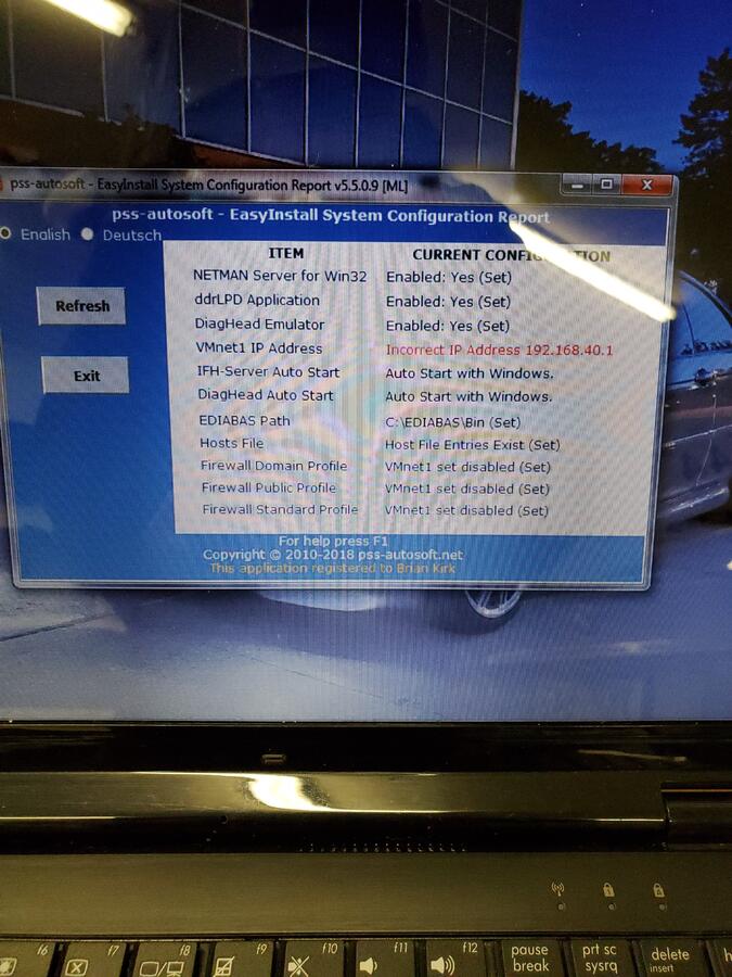

          So might anyone have a basic set of instructions they could give me in regards to helping me get the K+DCAN cable set up. I have used Diaghead as Administrator to no avail as well as IFH-server. Heres a shot of one potential problem I am not quite sure how to fix. Forgive my ignorance, but this one has got me confused.

            vmnet1 is a virtual network interface installed during the VMware installation. If your guest VM uses this virtual switch it will have host only access meaning no internet access and nothing but your physical laptop can see the guest VM. Perhaps that interface isn't enabled if VMware player is not active.
