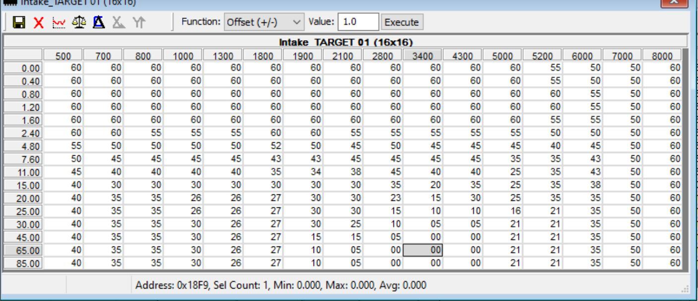

    Does anyone have experience/ideas with modifying the MSS54 to limit HP/Torque? Running an s54 in an e36 racecar and for classing purposes need to lower avg HP output. I know there are options out there to purchase a swapped detuned ECU, but the more I look and learn about what is available now in looking thru my .bin in TunerPro, I am starting to wonder if it wouldn't be too difficult to do on my own, perhaps starting with changing max throttle opening via KF_EGAS_MAX_WDK from 5000 RPM and up. I have access to a Dynojet, so could fairly easily test a few different configurations of throttle, timing, vanos, etc but wondering if anyone has experience/ideas they might offer beforehand. Thanks much.

        Thank you Rosie - I have looked at those (torque/moment) tables, but haven't yet figured out how exactly the DME is using them. Have you had any experience manipulating the values within? Wondering if the DME would use it as a master of sorts to then make dynamic changes as needed for throttle, timing, fuel, etc. I would kind of think the same thing as applied to the max throttle opening - the DME by design would adjust (correctly) as needed to decreased air intake to lower torque and horsepower output. Also aware of Epic/Randy and know of many very happy customers, but I am trying to learn on my own on another DME. I had a standalone prior on another motor and love the flexibility it affords, but I also find the work done to decipher the MSS54 pretty fantastic and from what I see, for those who like to do things on their own, the options are pretty open.
          You're usually best off limiting power first by reducing cam overlap (Vanos maps) and then reduce throttle opening only if needed. Ignition timing should be tuned to MBT as normal. Reducing ignition timing to limit power is a bad idea and will create excessive EGTs and other reliability issues. This method will net you the best fuel economy especially if you're doing endurance racing. You can simply just limit throttle as well but this is less efficient than reducing cam overlap due to inlet pumping losses.
            Very helpful BBRTuning - thank you for a pointer in the right direction at least. The way I see it is, limiting throttle is the quick and dirty method. Working with vanos timing to reduce overlap is likely the more difficult but better way to tune the motor more efficiently. I will start looking in that direction to at least learn more about it. What about the torque limiting tables - do you work with those at all? Thanks again.

                  BBRTuning - you mentioned decreasing overlap to reduce power. Did you mean to say increase overlap or have you found that at the higher RPM's you will see increased HP with more overlap (to a point) on the s54 due to scavenging?
                    On the S54 even at peak power ~8000 RPM they tend to like 10-25* advance on the inlet cam and -20-35* retard on the exhaust cam depending on cam spec and exhaust setup, so there's quite a lot of room to go to reduce overlap and VE/torque at whatever RPMs it's needed.

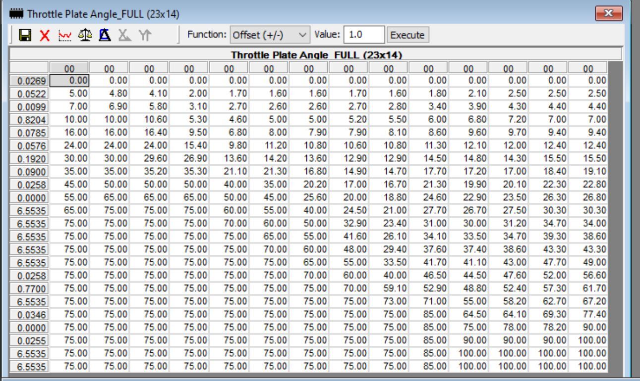

                        I agree with BBR! Adjust power output via VANOS and the 23x14 Throttle Map (linearizes open-loop air mass flow control to account for the non-linearity of the throttle position to throttle area).
                          Thanks SliM3 and BBR. Both very helpful and obviously knowledgeable on the topic.
                          SliM3 - I have been reading many of your past posts on these topics, and I can't get over the amount of work you and others put into these efforts to benefit the community. Thank you. Your post explaining the Vanos table was very helpful to understand how the values within correlate to degrees. As for the Throttle table, maybe my XDF is wrong for the .Bin I am applying it to, but I do not see x and y values that make sense. For the header/'x', I would expect to see RPM when displaying the tables in TunerPro - in attached .jpg you'll see they all display as '00'.
                          I am still trying to wrap my head around how it might be best to adjust and perhaps reduce overlap from say 5000-8000 in order to flatten my HP curve. The way I see it is that I can either retard the intake to see what happens by reducing overlap that way, or maybe it will require a different sort of strategy with advancing both intake and exhaust at higher RPM. I was reading more on it at the link below which I thought was helpful in providing a better understanding of cam timing in general.
                          "To increase overlap, you have to RETARD the EXHAUST, and/or ADVANCE the INTAKE.
                          To reduce overlap, you have to ADVANCE the EXHAUST, and/or RETARD the INTAKE.
                          Simple cam tuning rules for NATURALLY ASPIRATED engines:
                          * Advancing both cams => more low-RPM power, less high-RPM power
                          * Retarding both cams => more high-RPM power, less low-RPM power
                          * Less overlap => more low-RPM power, less high-RPM power
                          * More overlap => more high-RPM power, less low-RPM power"
                          "Retarding overall cam timing: Retarding overall cam timing is better for high-RPM power. This is because the valves are closing later. The intake valve is closing AFTER the piston has started to travel back up the bore for the start of compression stroke. This is terrible at low RPM because the intake air velocity is low, and air that was once in the cylinder is now being pushed back into the intake manifold and causing turbulence.
                          At high-RPM, the rules change. Air has weight, and thanks to Sir Issac Newton, we know that once it is moving, it doesn’t want to stop moving. This means that the air can continue to flow into and fill the cylinder, EVEN AFTER the piston has begun to travel UP the cylinder bore. This can allow an engine to exceed 100% volumetric efficiency, if even by a small amoun
                          t."
                          Prior SliM3 post:
                          "3) Here is the intake VANOS map. The cell values represent the changes in total camshaft spread based on crankshaft degrees (øKW), which is 60ø (70ø to 130øcr). By default the cam is advanced to 130øcr at start-up/idle; So if you wanted to know exactly where the lobe center-line is in relation to the crank, based on cell values, you first need to figure out the degree of retard (x = 60ø - cell value), easy enough. Then take that value an subtract it from the max adv angle (y = 130øcr - x)."
