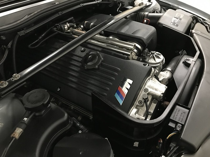

    I cover my alternator with saran wrap, rinse everything down and spray on simple green in a spray bottle. If excessively dirty, I'll agitate the simple green with a detailing brush, wait a bit, and rinse everything off again. Repeat if necessary.
      What Titaniu//M said is a great process. I've copied the engine bay detailing process from Obsessed Garage where you essentially lightly pressure wash the engine bay (cover the alternator and intake filter, if exposed), then spray with all-purpose cleaner and let sit for a minute or two. Then agitate (for dirty engines) with a brush. Rinse. Then spray down the entire engine bay (while it's still dripping wet) with diluted Meguiars Hyper Dressing and just leave it alone. And it'll dry to an awesome satin sheen:

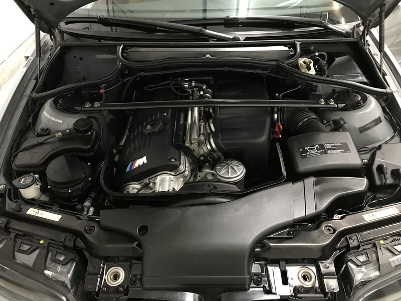

        You can't just have a magic product, spray it on, rinse and have a clean engine bay. Just doesn't work that way.
        Cover sensitive electronics/electrics, spray some simple green, engine degreaser, etc - cleaner of your choice - and go to town - scrub with rags, brushes, etc. Once done - rinse with hose or I prefer actually a power washer - then I use a leaf blower to somewhat dry - and asses the areas that need additional cleaning - and repeat. Once that is done, take some plastic conditioners, microfiber rugs, etc, and go over everything item by item until your engine bay is clean. Sometimes it takes an entire day to get that done, but you won't regret it when your engine bay is looking like this:
          Griots engine cleaner and engine bay dressing. Cover alternator with large ziplock bag
          Pressure washer to rinse and leaf blower to dry. Repeat every third or fourth wash. Click image for larger version

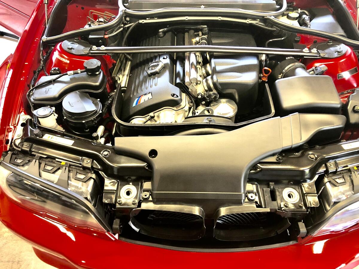

              2007 Imola Red Z4M Coupe
                Like others have mentioned:
                1. I would start out by removing any leaves, etc
                2. I use EgoBlower to blow out any leaves etc.
                3. Spray APC like Nextzett Blitz or Megs, etc ( simple green can be used as well, but I don’t love it. )
                4. Use a few different size brushes to agitate the dirt
                5. Wipe with a microfiber / spray off
                6. CarPro Perl or Megs hyper dressing is a nice topper
                7. keep it clean and you will only have maintenance wipe downs in the future.
                I’ve also used a steam cleaner and brushes when I wanted to be extra careful. Then again, I pressure washed my buddies engine bay on his Ford GT with no issues ( covered the electronics ).
