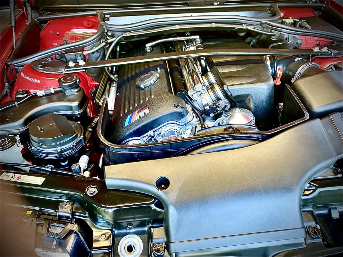

ID:	230782 I clean my engine bay every 3 or 4 washes with Griot’s engine cleaner and their detail spray. It never gets very dirty, just a bit dusty. Dry with a blower to make sure everything is dry.takes 10 minutes tops.

        Looks great man! Thanks for sharing. Mind dropping a link to the dressing spray you're using? Is it a water based product?
