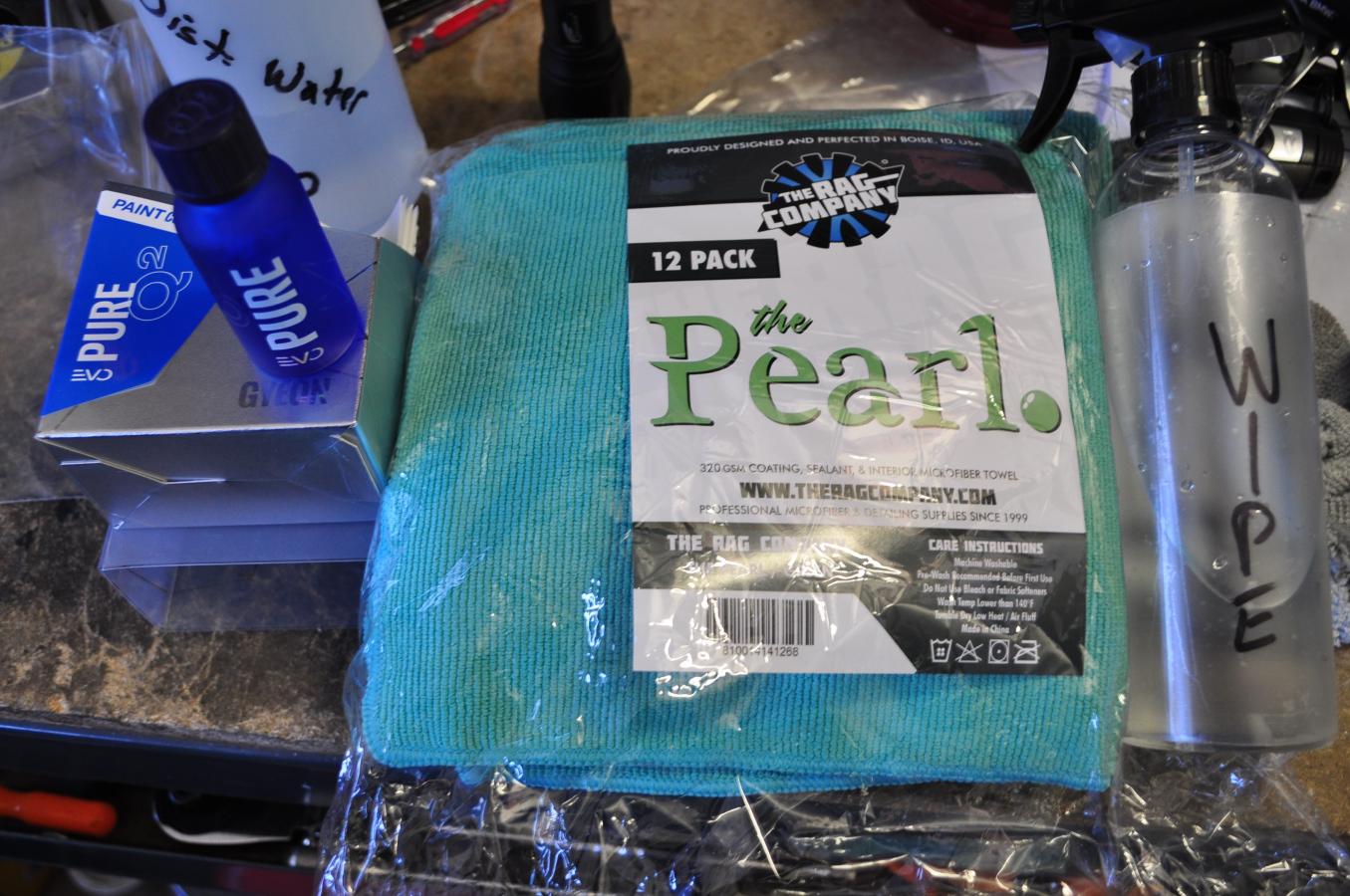

          Gyeon
          MF applicator was easier to use than a block with suede. Soak it in serum once, then just a few drops each time

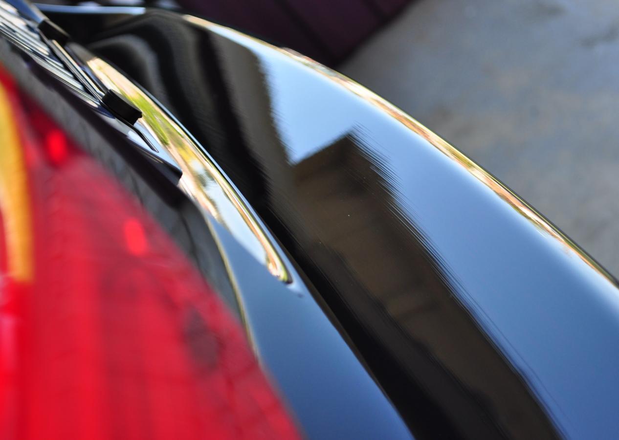

          You can see it flash a bit

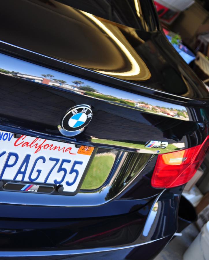

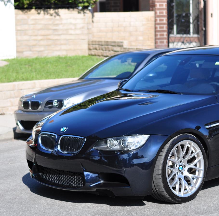

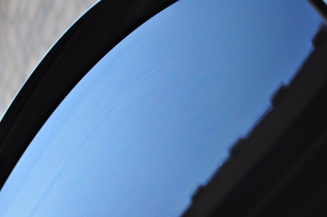

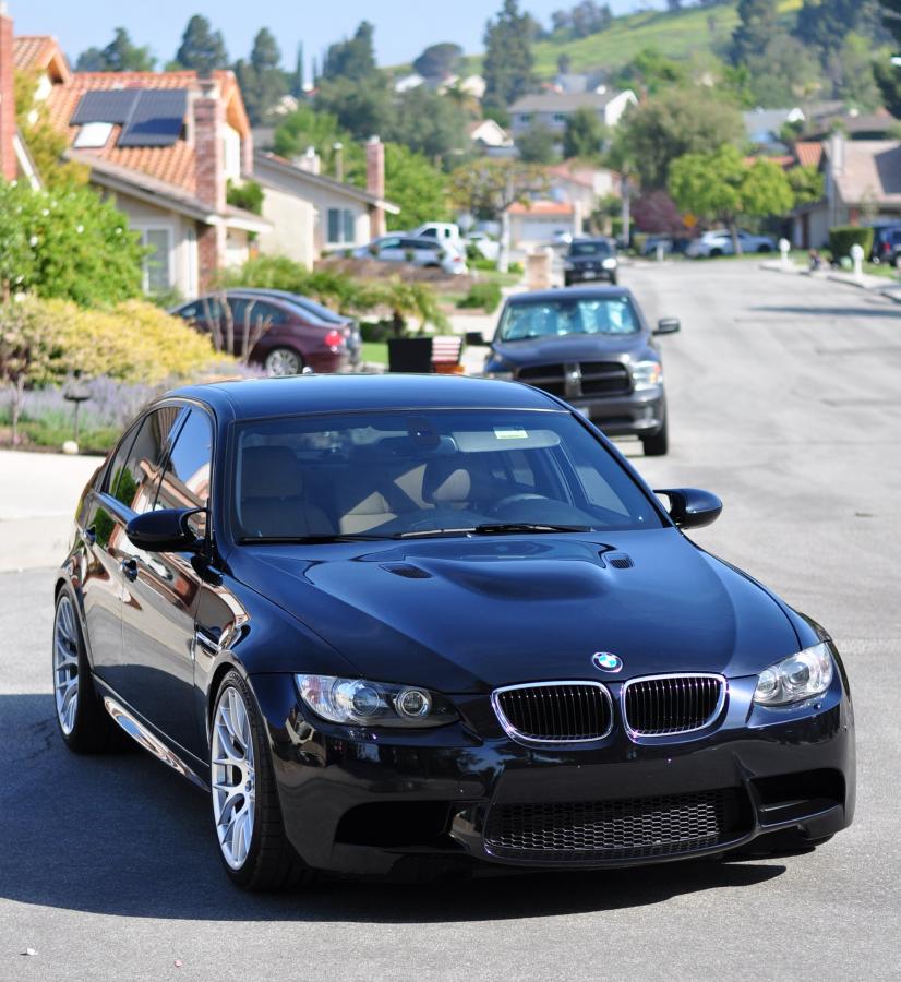

          Super "candy" gloss
