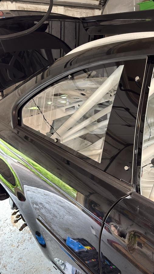

      I got the hard motorsport vented windows, actually fit pretty well. I used some hardware I got off amazon and mcmaster to make it look nicer but used their 3d printed mounting tabs. Click image for larger version

          Which gasket did you use with the window, or is that silicone filled in?
            I used the OEM moulding and the glass guy just installed it like regular glass.
              5 Star has OEM cut and oversized you can cut. Ran the OEM quarters and rear glass sizes.
