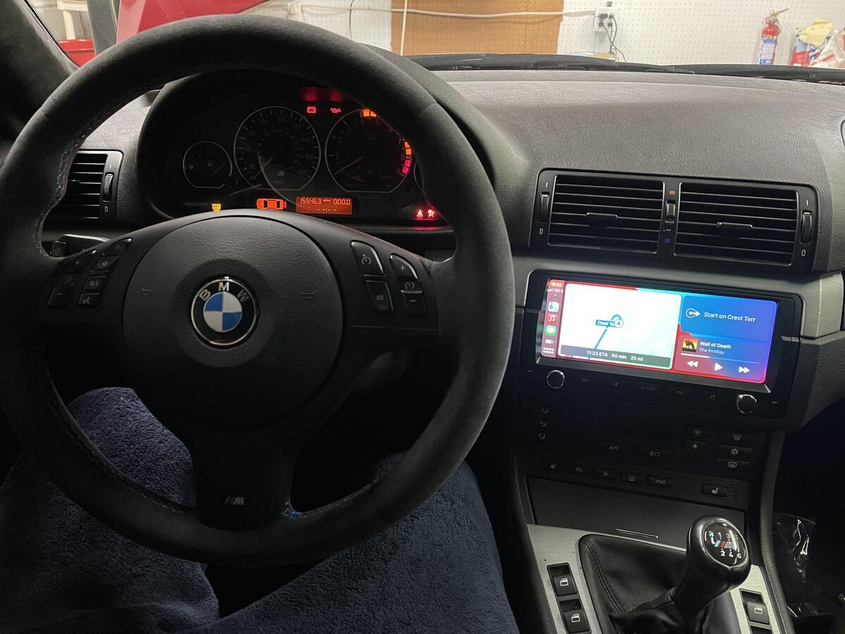

    And running the Track Connect app on the Avin just feels perfect
    (pictured running wireless carplay, but gets the idea accross :P)

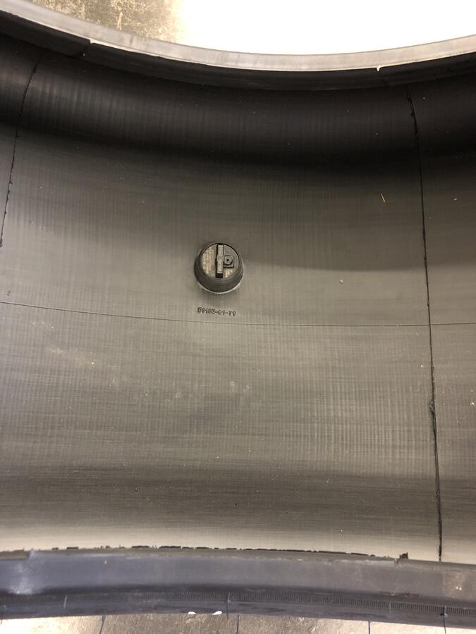

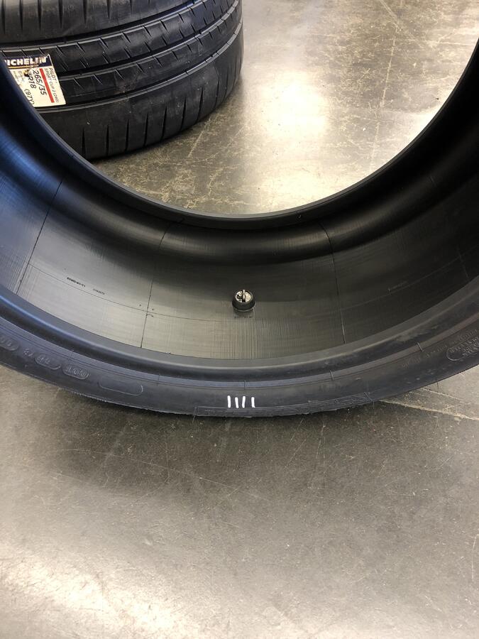

        Installed the track connect stuff. First use in 2 weeks.
        Sensors installed:
        Click image for larger version  Name:	64945307806__21DADF3B-3744-4805-96BB-0BB63231AFA1.jpeg Views:	0 Size:	52.7 KB ID:	118273​ Click image for larger version  Name:	64945327781__B52B3BFF-5666-4B36-8604-680A7536F6BB.jpeg Views:	0 Size:	80.7 KB ID:	118274​

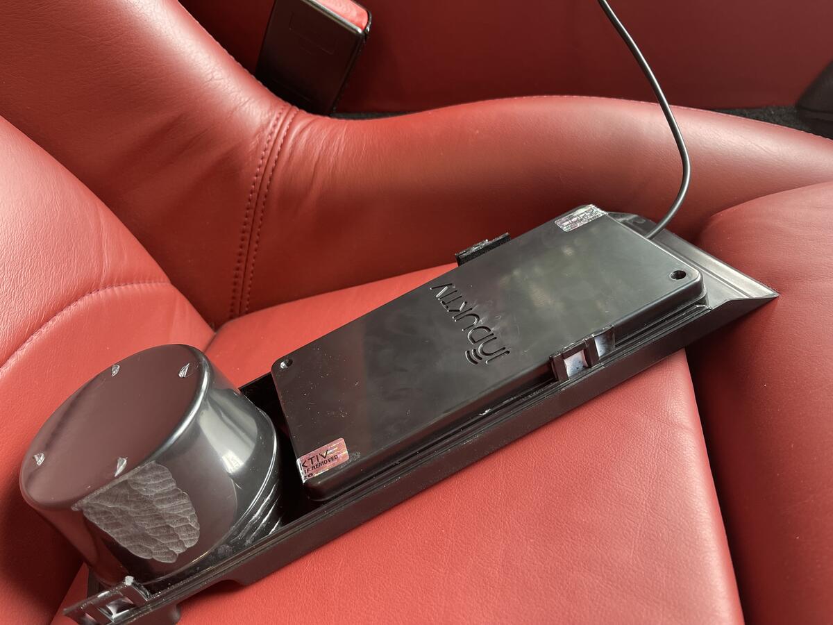

        A perk of having the Qi charger center section:
        Click image for larger version  Name:	64953681919__2EF6A2F3-9730-4E56-8738-74E0BB5543D1.jpeg Views:	0 Size:	110.7 KB ID:	118275​

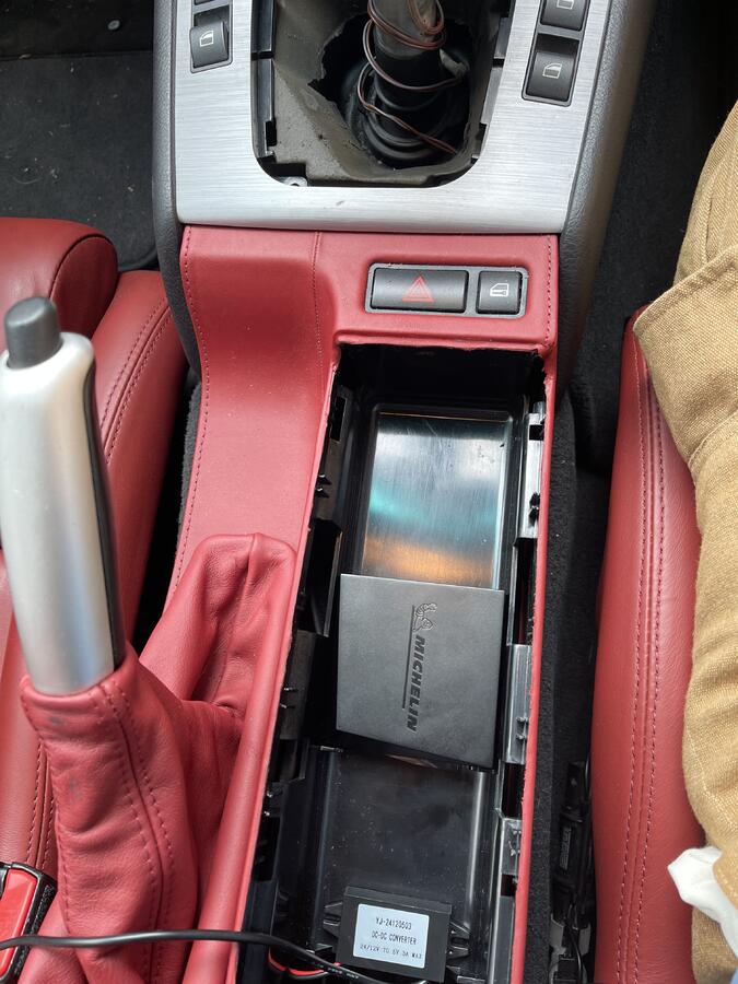

        Is that there's sufficient space under it to install the telemetry unit:
        Click image for larger version  Name:	64953828549__C7D735B2-0282-4F74-B908-8C6C1CEBF163.jpeg Views:	0 Size:	92.7 KB ID:	118276​

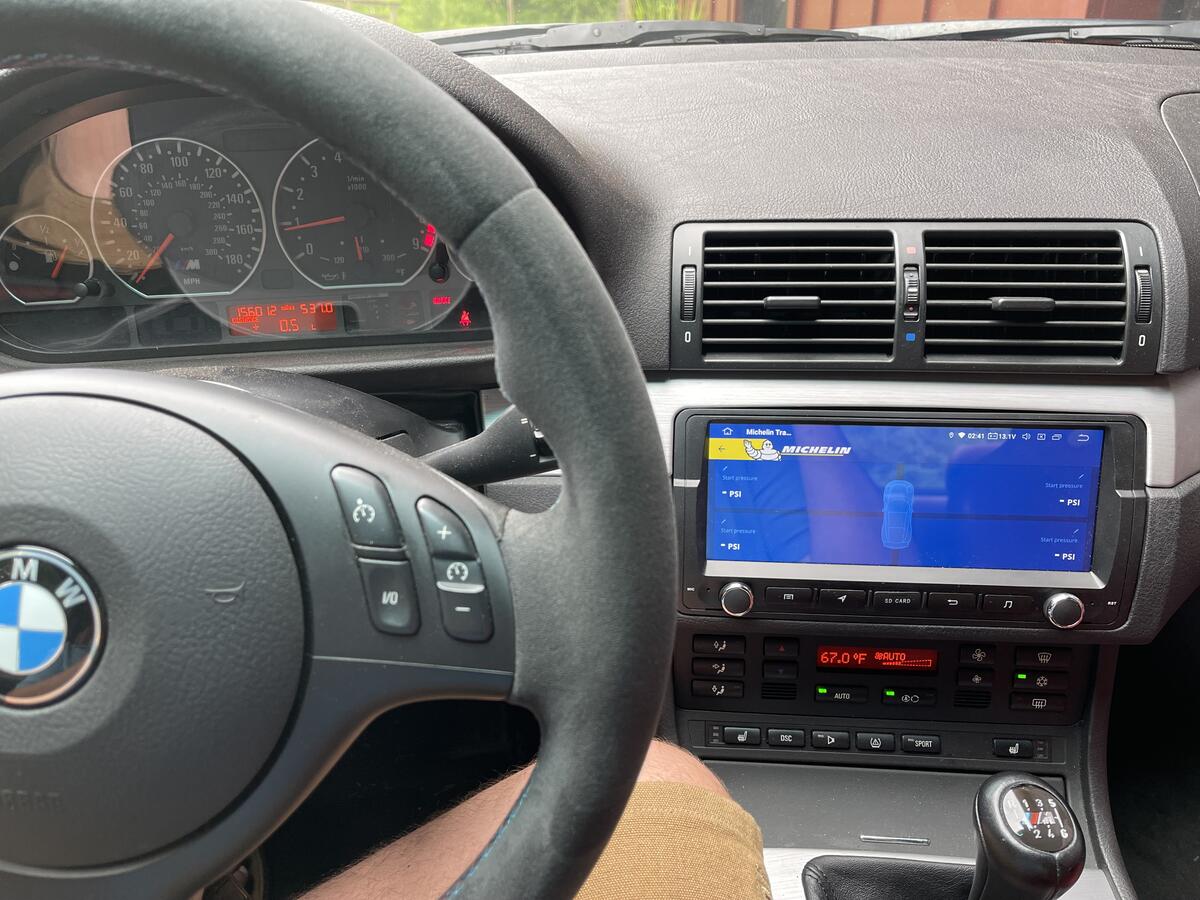

        And, app running on the Avin (not paired up yet):
        Click image for larger version  Name:	IMG_1740.jpeg Views:	0 Size:	149.9 KB ID:	118277​

          Annoyingly, the head unit would not pair with the Michelin telemetry box, so I had to run the actual app on my phone. Pretty sure that's the fault of the Chineseium head unit, not the Track Connect system, as it paired up with my phone right away.
