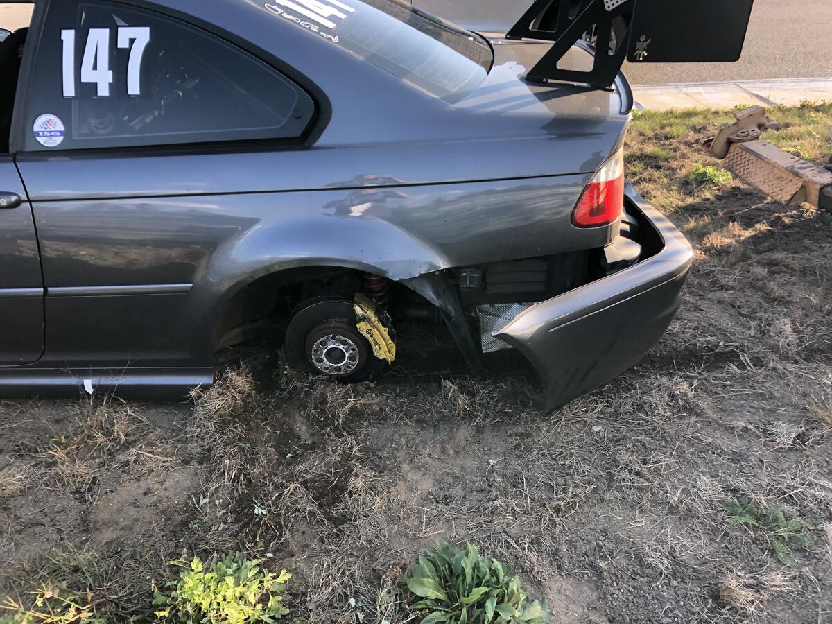

    Exactly two years ago a fellow cca member ended his season by totaling his car when he sheared all his wheel studs going into turn one. His wheel and tire ended up under the car and it was uncotrolable. I have replaced my wheel studs yearly since then. This past weekend, my last event of the season, I had a similar experience with a better ending. I sheared all 5 studs ( my guess is one broke and the other 4 followed) coming onto the front straight. Literally no warning. I was somehow able to keep the car out of the wall but did suffer some damage. These studs had 7 track days on them. Just a warning to inspect and replace studs as if they are a wear item. It seems that there has been quite a few issue with wheels studs as of late and the consequences can be far worse than in experienced.
    for me a few mechanical parts will need to be replaced and obviously some cosmetic but all things considered I could have had a much worse outcome. There is nothing worse than watching your rear wheel pass you down the front straight

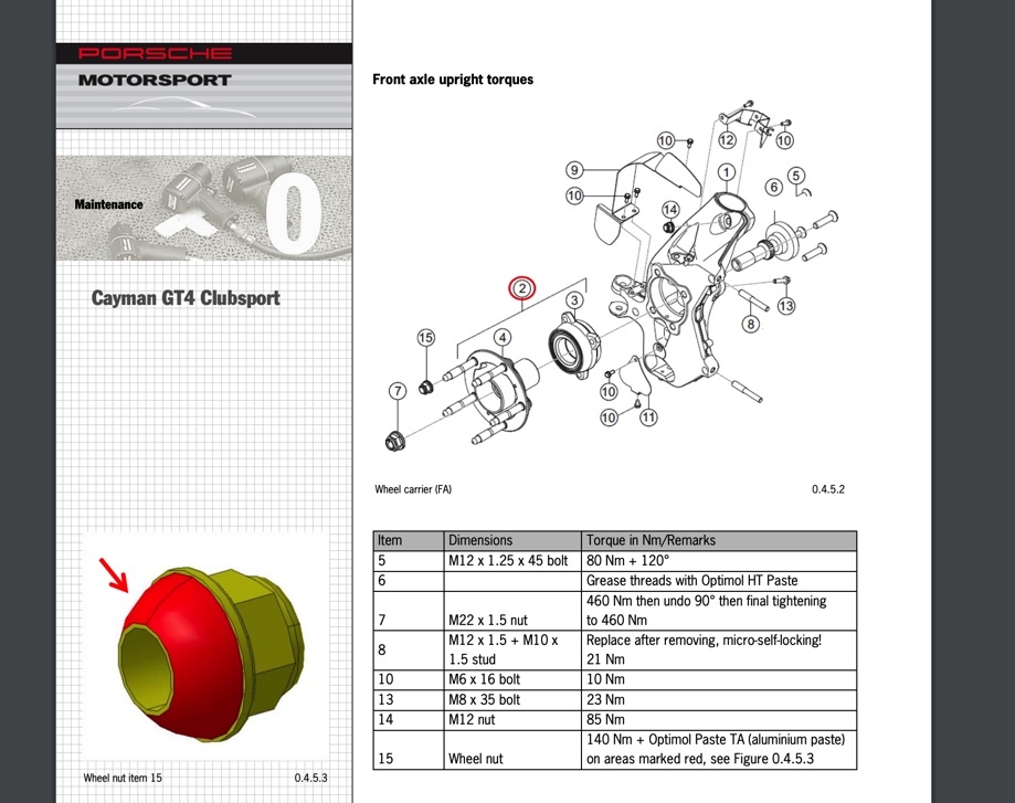

                  I've switched to MSI as well and use Castrol Molub-Alloy Paste TA on the cone of the lug nuts before torquing them down to 70 ft-lbs.
