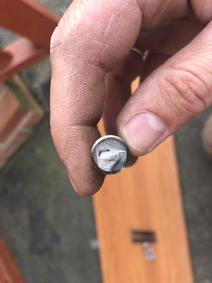

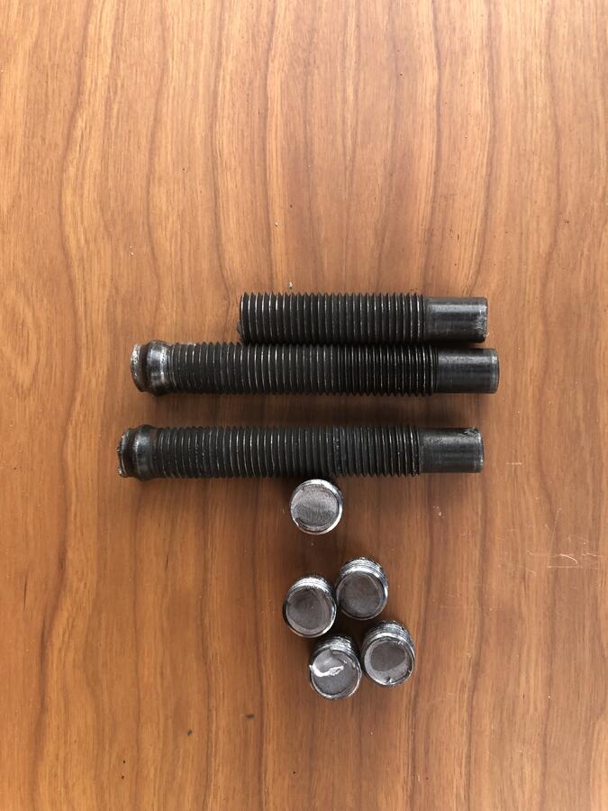

      Track workers found 3 of the 5. The short one is the one I imagine broke first.
        Originally posted by Sergmann View Post
        I will be looking into the press in options as I rebuild the car. These were fcp studs btw but I’m not sure that matters.
        as for wheel bolts, I’ve seen them fail too. A good friend still runs them on his e36 track car and broke one earlier this year. He replaced all 20 with new OEM stuff and has broken two since.
        im not sure what is happening as of late with the studs but I have seen more failures in the past two years than the previous 10!!
        The motorsport hardware ones they sell, specifically? Scary and good reminder, thanks for sharing. Guess I'll use the fcp warranty for once and replace them every spring.
