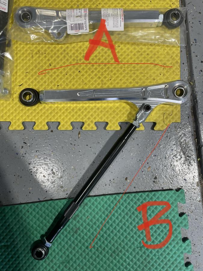

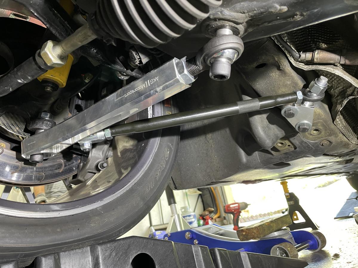

Hi, looking for some suggestions on setting up the AKG control arms. Below is a picture of a mocked up pass (right) side one - I have been told to start by setting the A length to stock control arm 14.5".
What is the best way to measure the wheel centerline with the stock control arm on the car, so I am able to set length B back to that position?
Idea I've had so far is to run a straight edge from the two front bolts on the stock control arm, mark the edge on the subframe, then turn rear rod B until I reach that same position. Curious if anybody has a better way to measure the position of the hub relative to the subframe so as to verify it is back to the same position.
