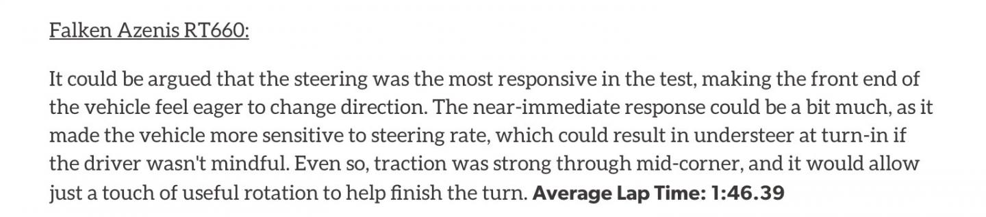

                        Draw from this what you will from Tire Rack’s testing of their crop of track tires they sell…. The BRZ, is at least front engine, and rear drive, the same as our M car. As for why the RT660 was highlighted, it is available in the 245-35-19 F & 275-30-19 R configuration. If one chooses this set-up, expect one’s wallet to be lightened by about $1,400.00 greenbacks. Good tires do not come cheap! The RT660 trails he leaderboard tire by less than half a second, or only .4 second, and it is the second place tire. For recreational users, this is probably good enough, but for the fellas looking for every last ounce of stick from their tires, then grabbing a copy of Grassroots Motorsports might be necessary because they do a nice job on covering which track tires does the best.
