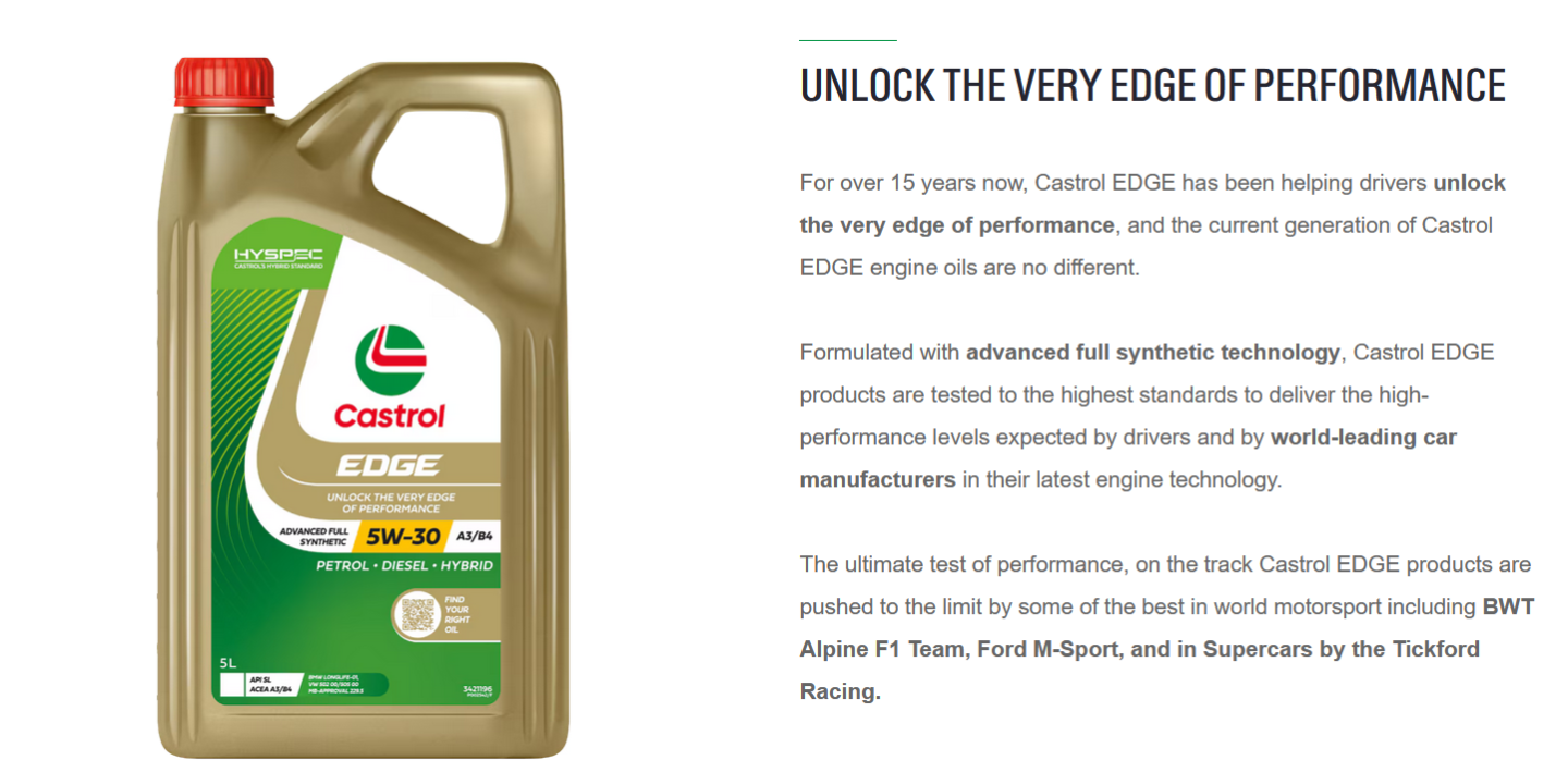

        Looks like Castrol 10w60 is no longer listed under the edge range on the Castrol Australia website
        Label change too
          #49
          Label change too
          Interesting.
          Maybe they're in the process of updating the site and broke something? I just clicked around; it looks like they still have a page for 10W-60 oils, and Edge Supercar shows up on it – but the link 404s, as do all the links from the viscosity grade pages AFAICT.
