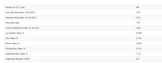

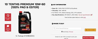

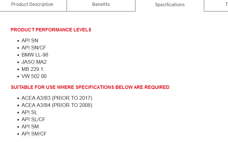

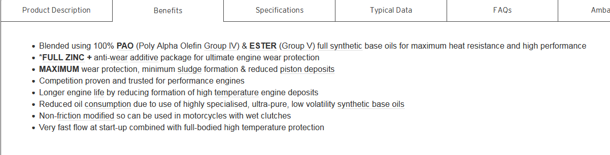

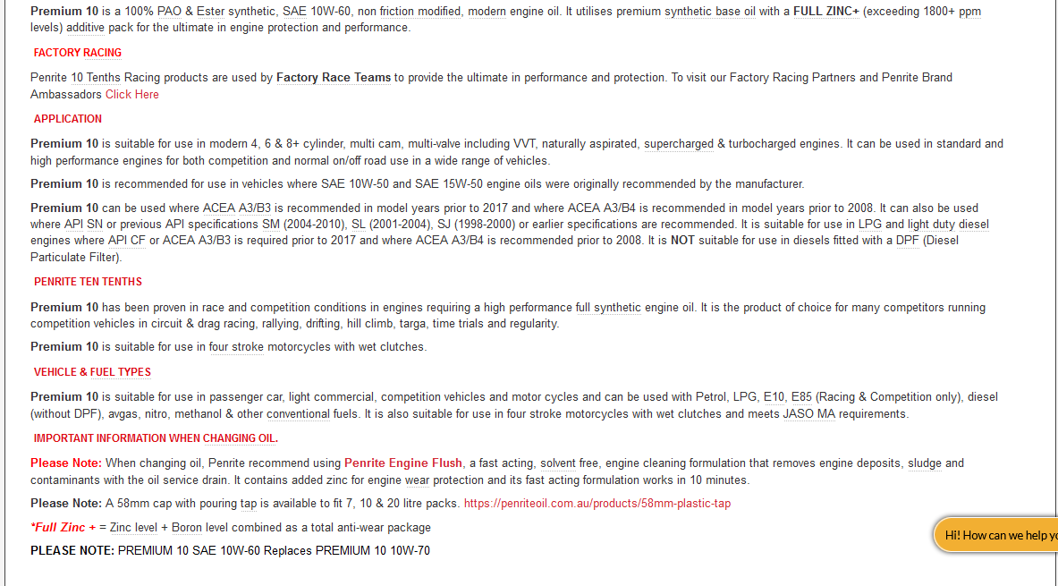

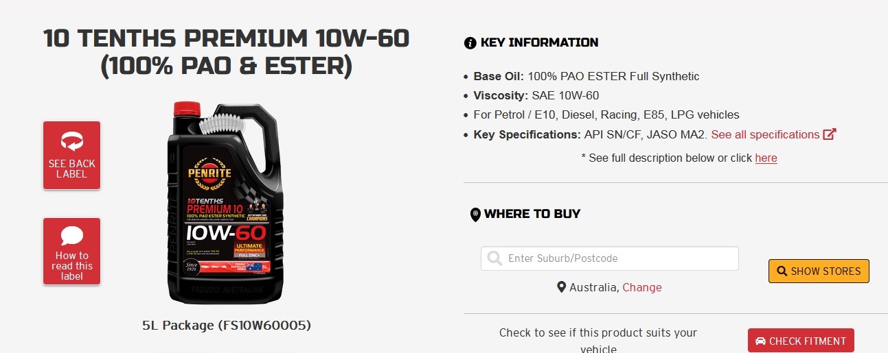

                              Just throwing some jet fuel on this thread
                              In Australia we have this oil, currently not mentioned
                              It's a BMW approved LL-98 oil
                              Click image for larger version  Name:	Pen1.jpg Views:	0 Size:	104.1 KB ID:	276526 Click image for larger version  Name:	Pen2.png Views:	0 Size:	35.5 KB ID:	276527 Click image for larger version  Name:	Pen3.png Views:	0 Size:	21.9 KB ID:	276528 Click image for larger version  Name:	Pen4.png Views:	0 Size:	26.3 KB ID:	276529 Click image for larger version  Name:	pen5.png Views:	0 Size:	76.0 KB ID:	276530
                                #45
                                Looks like a great product for older flat-tappet engines, or maybe certain race cars. I would not consider this a substitute for BMW 10W-60 or the other known-quantity engine oils for these cars for street use.
                                They list BMW LL-98 as a "performance level," not an approval. IOW, they think it performs at that level, but it hasn't been approved. Very common for aftermarket engine oils.
                                One thing I've noticed about high-ester oils: They also tend to have monstrous ZDDP levels. Not a surprise IMO given that ester competes with ZDDP at the surface of the metal. IOW, I'm sure that 1800+ ppm of ZDDP is doing good work, but it probably isn't doing what it seems like it should. And you'll still get the downsides of massive ZDDP levels, like ash.
                                100% PAO/ester with a ton of ZDDP looks great because none of the major OE-affiliated brands do it this way. But when none of the major players in a field do something, you can bet there's a reason.
                                To me, this looks like a band-aid product for when you need anti-wear at all cost. In a street-driven or even mixed-use M engine, I would expect the anti-wear benefit to be minimal-to-none and not worth the downsides.
