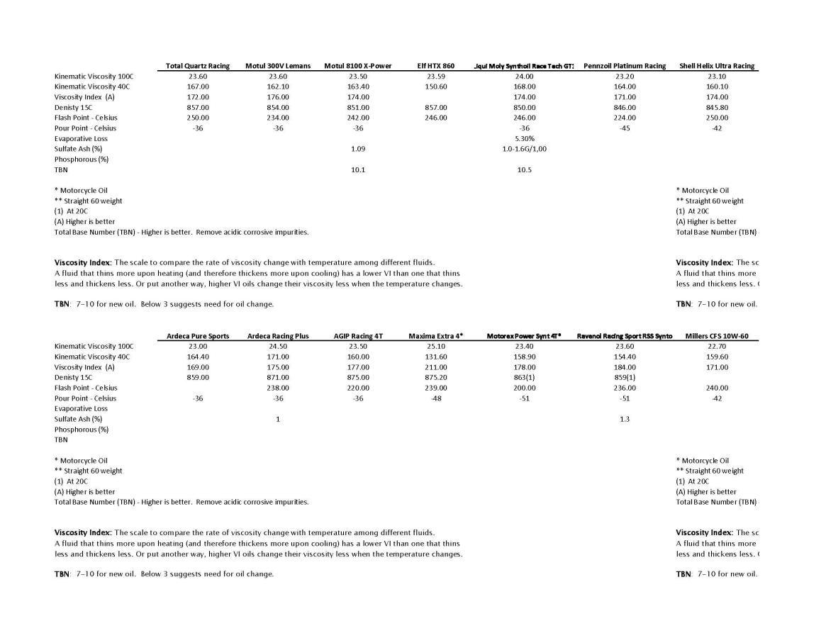

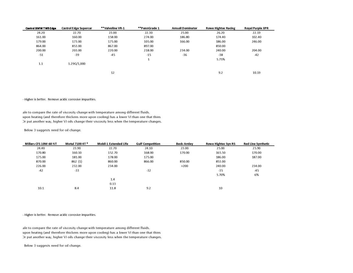

                    Good day all. I'm attaching the10W-60 oil spreadsheet I've put together over the past few years. All the information is from the manufacturers published information. I have it in an Excel spreadsheet as well. If you'd like a copy, e-mail [email protected].
                    Feff
                    MVP Track Time

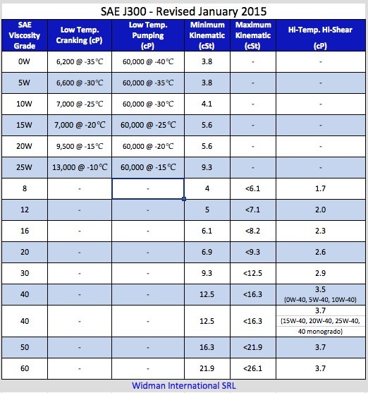

                          For kinematic viscosity at 100º C, a.k.a. KV100 – the thing that determines the big number in the viscosity rating (40, 50, 60, etc.) – there's no overlap. Any xW-60's KV100 is always higher than any xW-50's, which is always higher than any xW-40's, etc.
                          Where you will see overlap is in other viscosity measurements, e.g. kinematic viscosity at 40º C or high temperature high shear (HTHS) viscosity. That's where you could have a "lower" viscosity grade that ends up with a higher viscosity measurement than a "higher" viscosity grade – e.g., a 5W-50 with a higher HTHS viscosity than a 10W-60.
                          Click image for larger version  Name:	sae-j300-engine-viscosity-table.jpg Views:	0 Size:	81.5 KB ID:	274866
