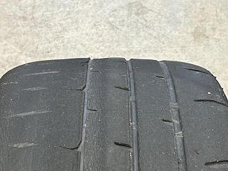

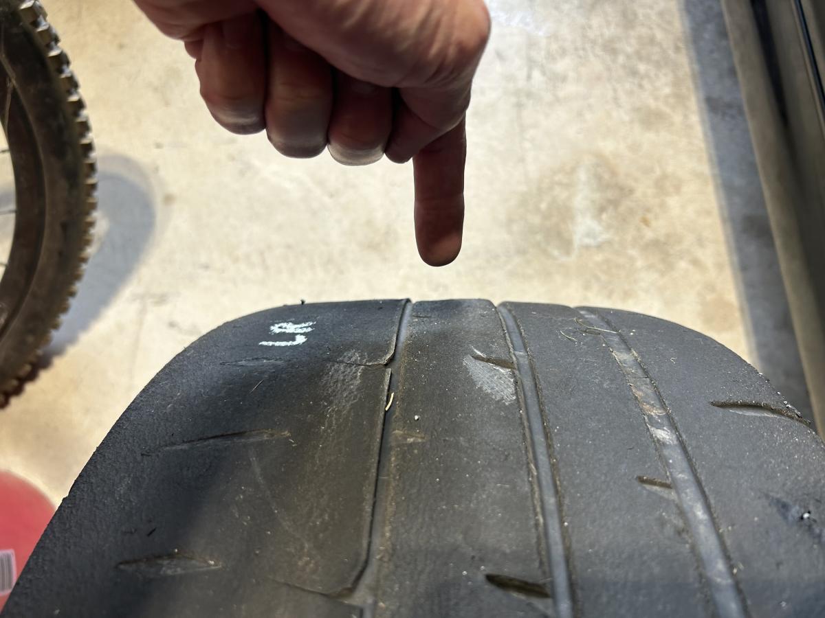

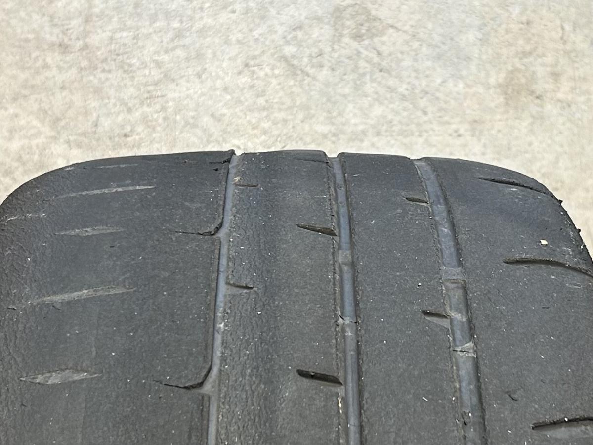

                          I don’t like the way the 265 RE71 RS is wearing.
                          I’ve been rotating and adjusting pressures a couple PSI but I’m still getting irregular wear Click image for larger version

                            Mine are doing the exact same thing. Doesn't seem to affect driving much... yet

                                Front or rear tire?
                                Either way, that isn't abnormal.
