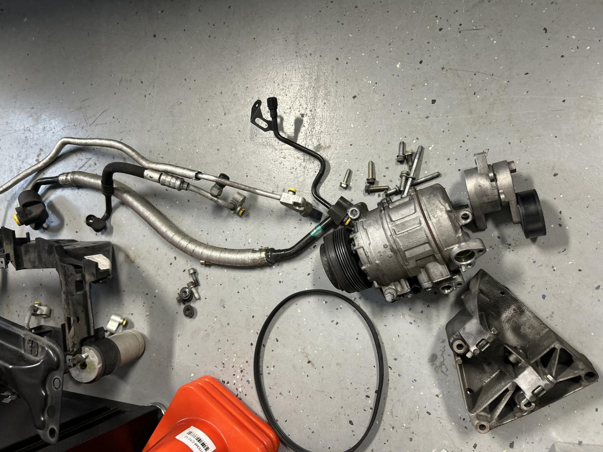

    The A/C runs off its own belt. Remove the belt and compressor to delete A/C. Could probably save some more weight by removing the A/C belt tensioner as well.

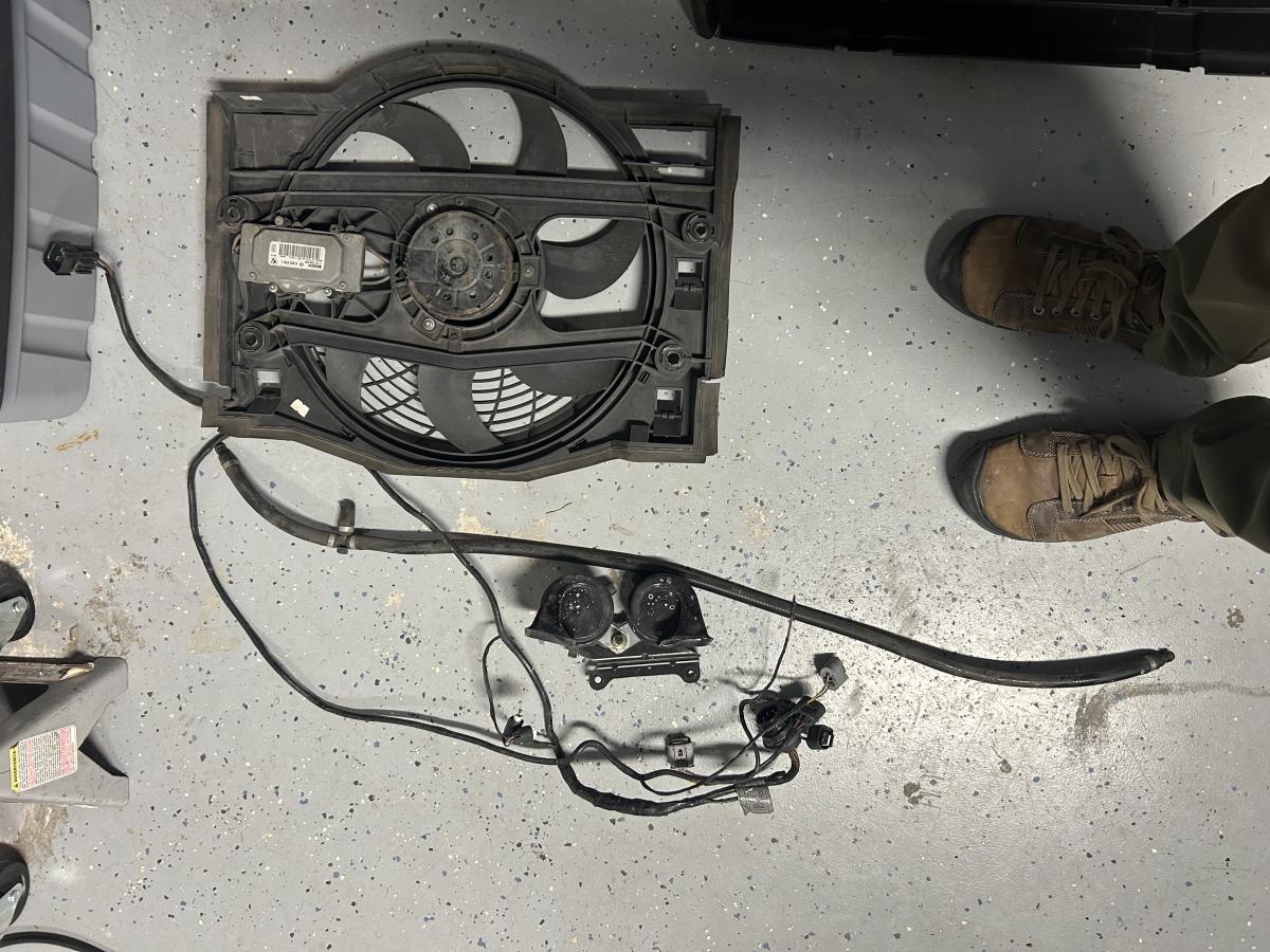

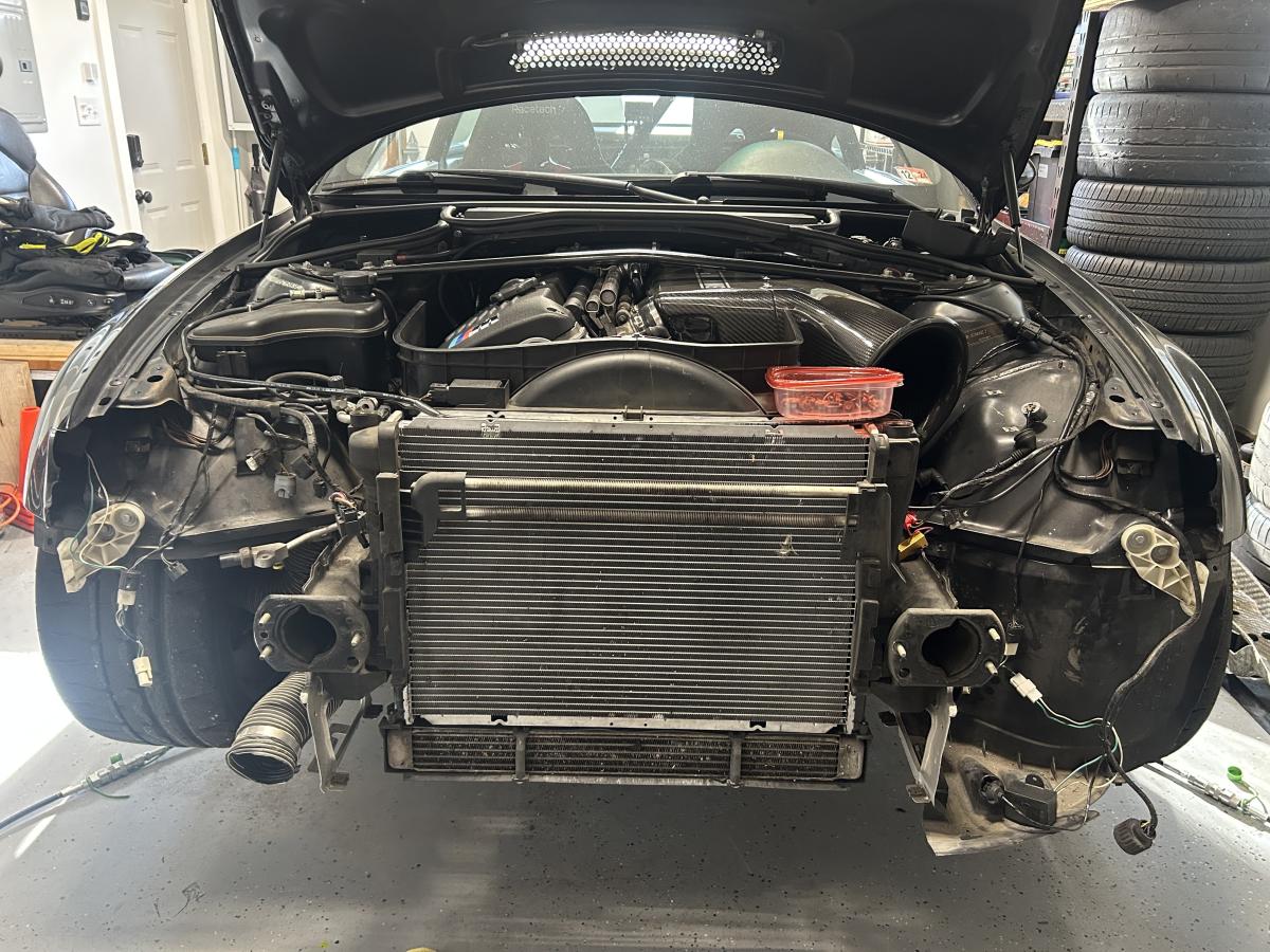

              My plan is to reduce unnecessary weight on a car, since we don't drive to the track anymore and we have a FAST cooling system. I plan to remove the condenser, the auxiliary fan, the dryer, the lines/hoses, and in the process the refrigerant . At the same time, I'm also going to pull the front carpet, the passenger airbag, side curtain airbags, and airbag module.
              I don't plan to remove the heater, and I haven't figured out how to dehumidify the car for early morning sessions in high-humidity without it.

                  Pulled these parts of the AC out today. 41.5 pounds in all.
