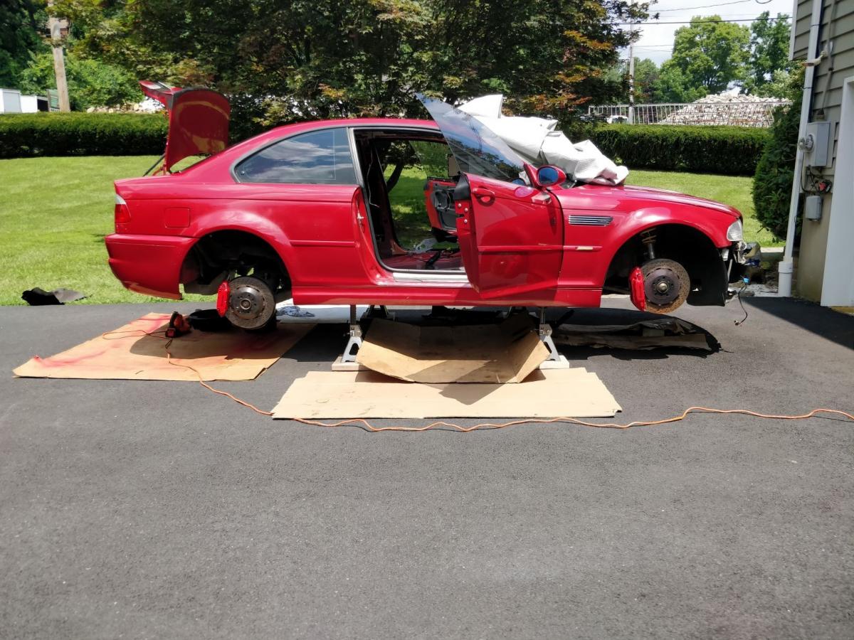

    It's a work in progress but I was able to make it to the last autoX of the season last year for a bit of a shakedown run (no track events left at that point). I've done everything myself up to this point but I'm subing out the cage work to the pros, which is where it is right now ๐Ÿ˜

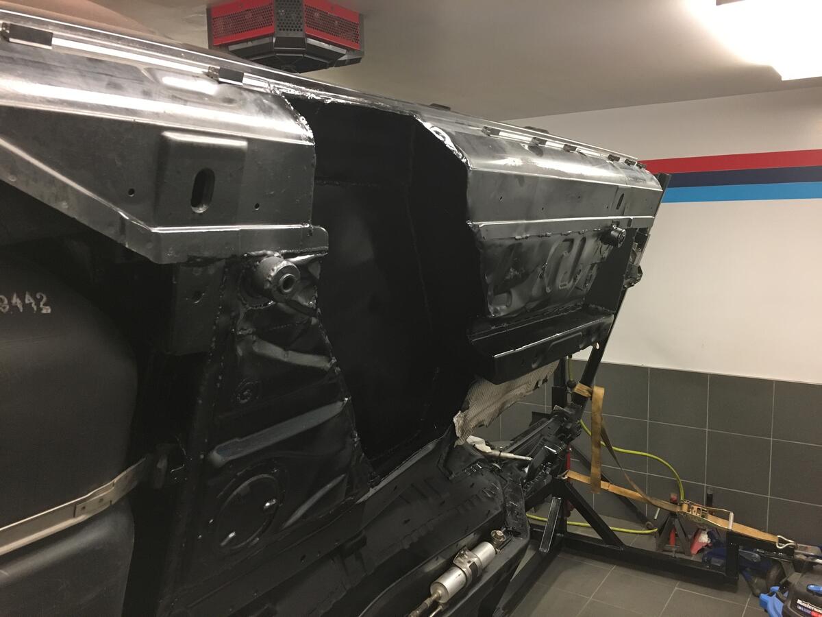

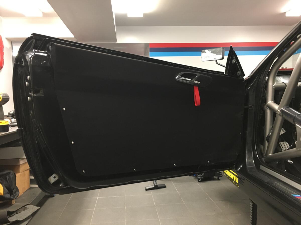

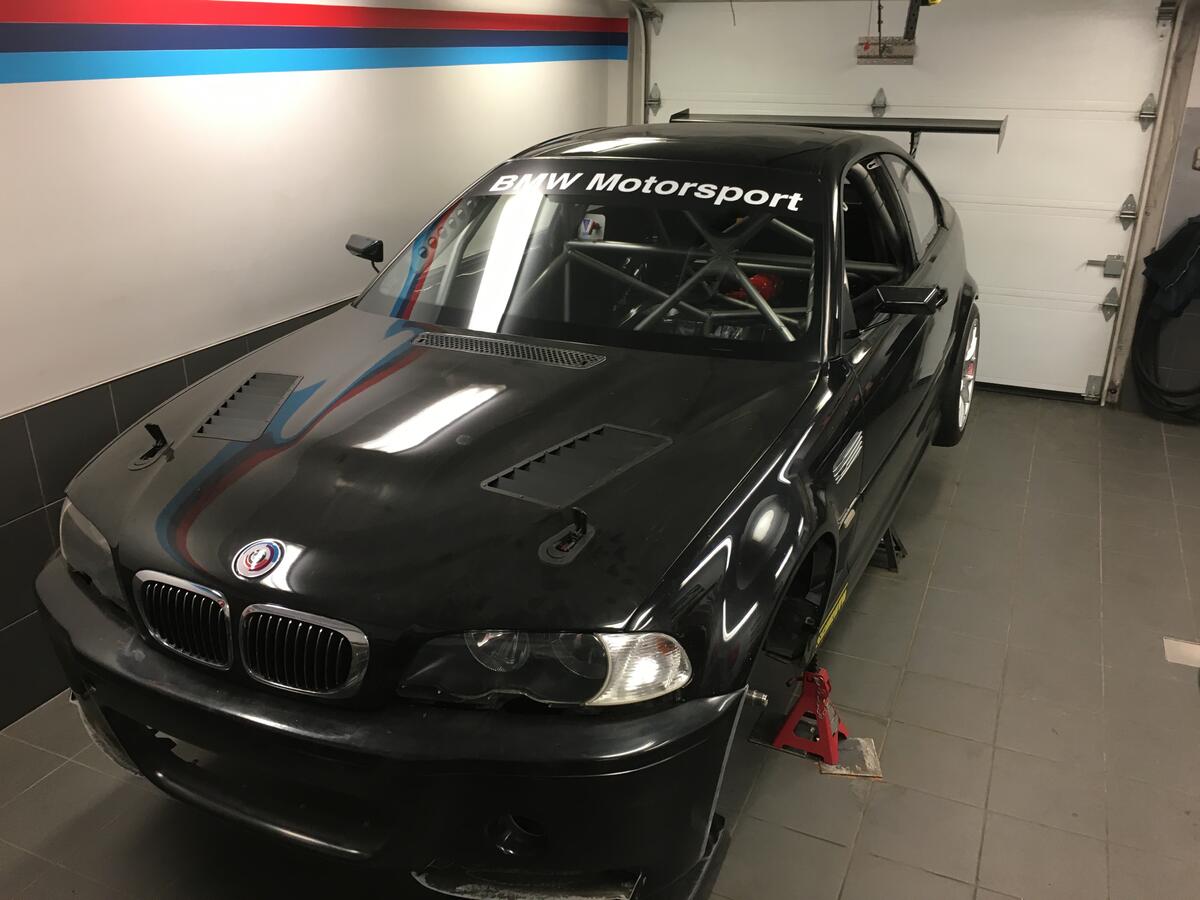

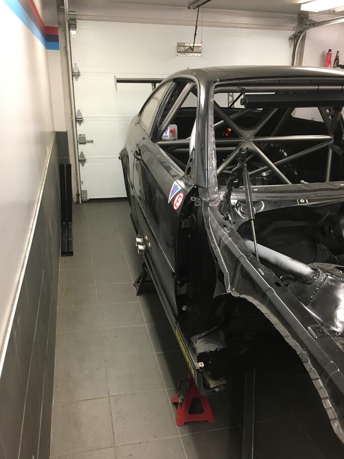

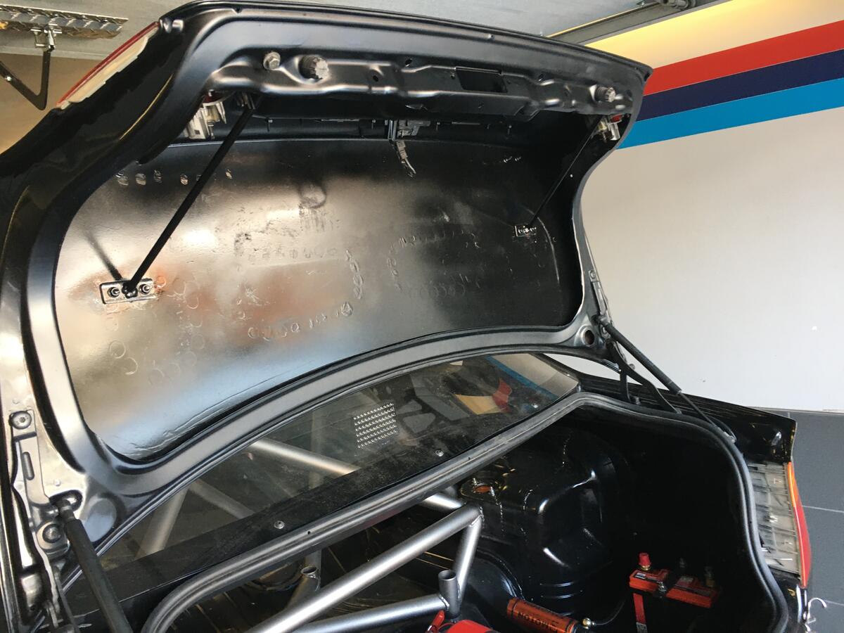

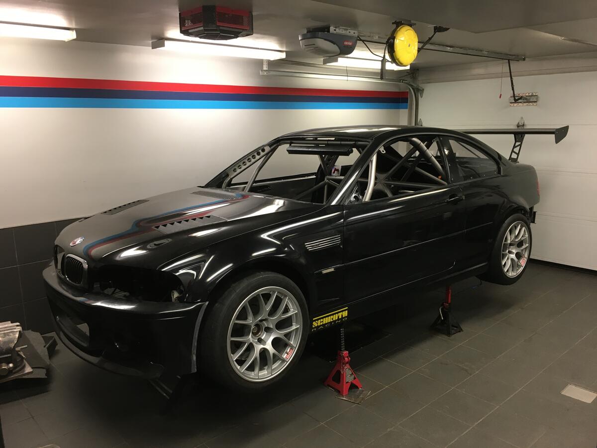

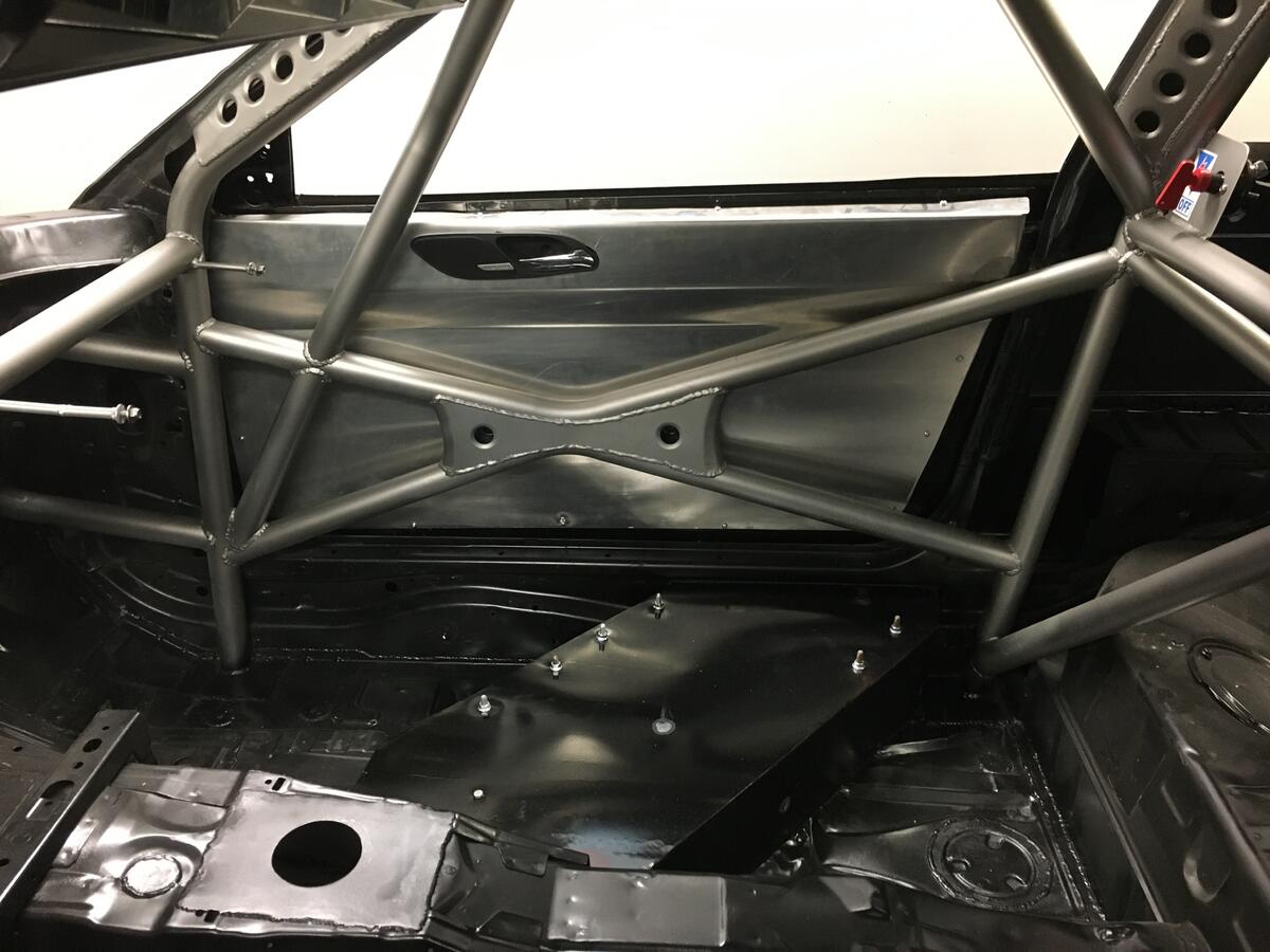

            I am building another E46 M3 race car. Itโ€™s not finished yet but canโ€™t wait to put it on the scale. I removed a lot of metal inside the cabin (reinforcement behind the A-B-C pillars, inside the doors, inside the rear quarter panels, flat trunk & battery floor, removed rear bulkhead, ...). I also removed all the nd stitch weld all the chassis. The cage ties into the rear subframe and front strut tower.
            I have 320 hours in it so far and will have 400 once finished. I still need to rebuild the PF Z45/Z29 BBK, do valve adjustement, rod bearings, VANOS bulletproof, ...

              ^ yeah imma need more pics of that one
              Please!

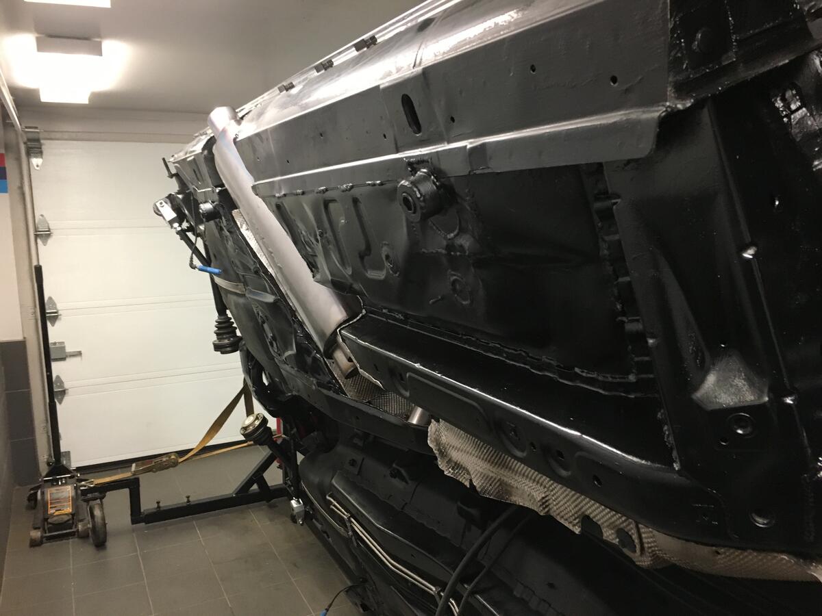

                      Any underside pics of the stitch-welds? Great build
                      Current:
                      2003 BMW M3 ยท Coupe ยท 6MT - Alpine White/M-Texture Alcantara

                          Epic!
                          I Imagine its getting a flat floor?

                            Originally posted by SandeepM3 View Post
                            Epic!
                            I will make a custom front splitter up to the aluminum belly pan and rear diffuser from diff to rear bumper but not a complete flat floor for the moment.

                              you in the Morristown/ Morris plains area? I feel like I've seen this car sitting in a driveway just like that..
