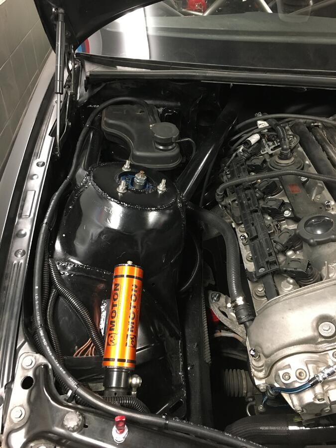

                      I did a custom bracket to relocate the coolant overflow tank
                      Mind posting some pics of how your reinforced the driver's side strut tower?

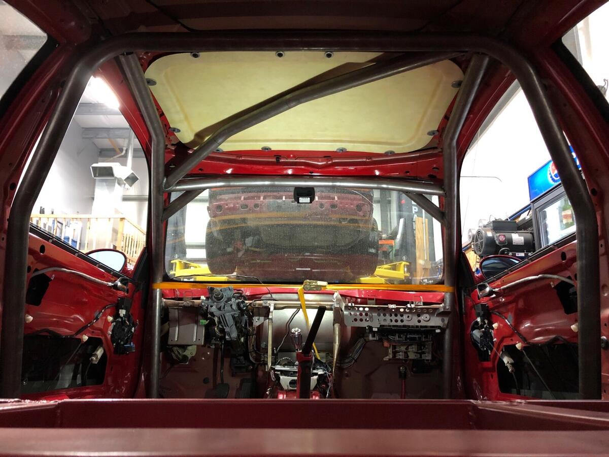

                        Progress
                        '02 e46m3 - fully caged track car
                        many others

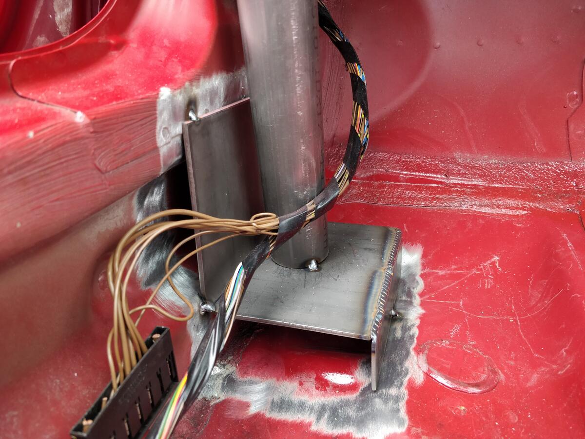

                          Cage looks great so far! what did you do for the floor anchor points?
                            Are you referring to the cage attachment points to the chassis/floor or to the seat belt "anchor points"?
                            many others
                              chassis floor
                                chassis floor
                                Like this, but will be fully boxed.
