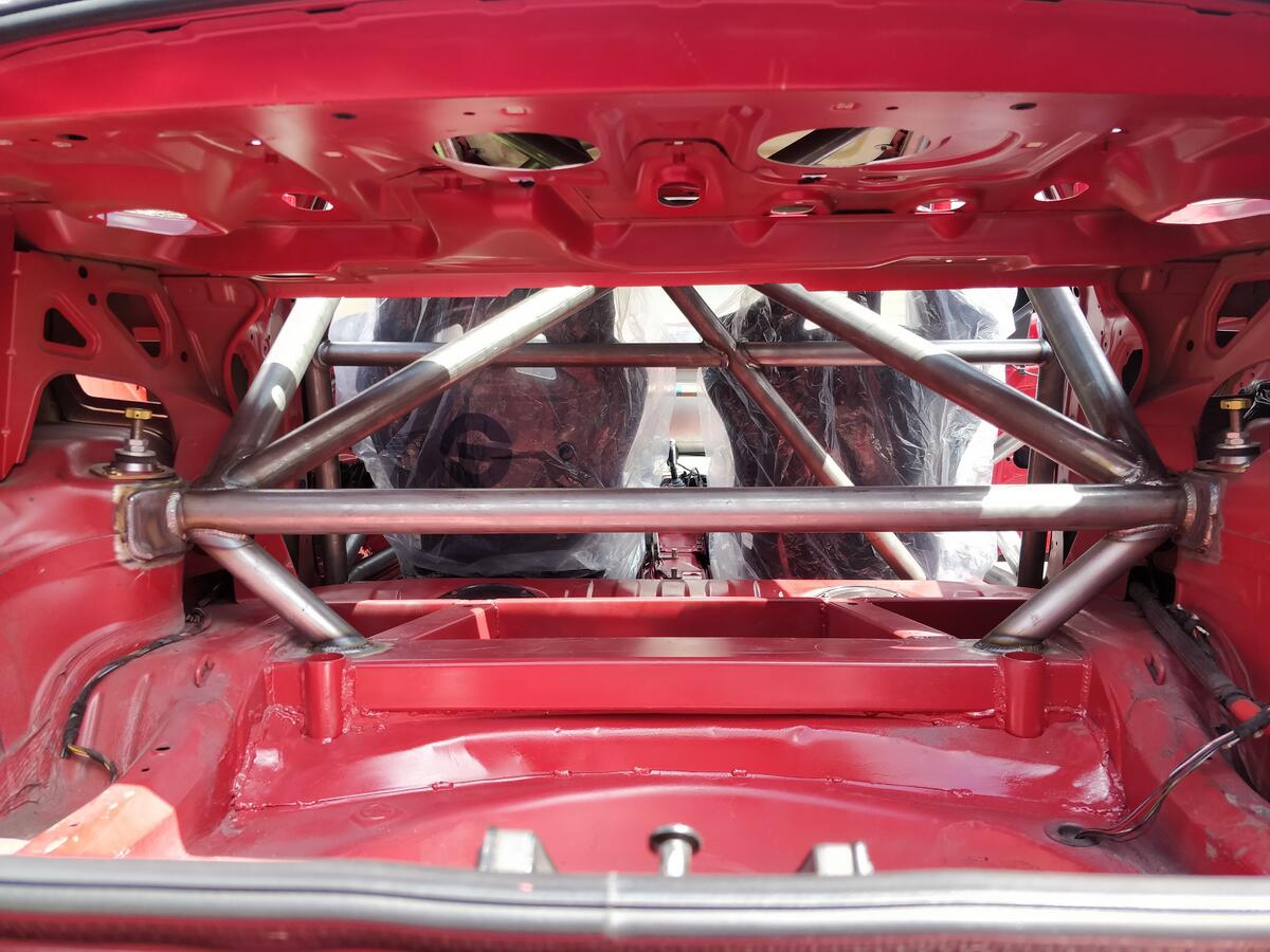

    Should I just make a separate build thread? Cage almost done.

        Any plan to tie-in cage to rear subframe? Cause the way your diagonals and X-braces from main hoop to rear shock towers attach to rear shock towers might not pass tech imspection with some organisations. Those tubes are supposed to go to a plate not another tube.

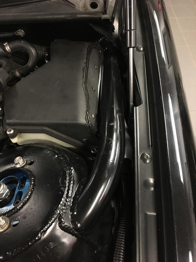

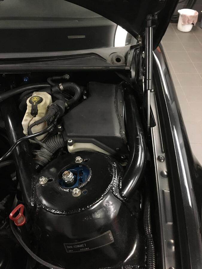

          Mind posting some pics of how your reinforced the driver's side strut tower?
          Not finished yet. I had to play a bit with the DME housing and cut the cover a bit. Now working to make sure no moisture get in there!
                        Cool...car looks great BTW!
                        I want to move the ECU to the interior on the pass side for better weight distribution and to allow for a tie in between the cage and strut tower. But if there is a way to tie into the strut tower without moving the ECU...I like that route!

                              Perfect, it should pass tech inspection like this. Nice work/welding skills btw, you are doing everything yourself?
                              The cage work I farmed out. My design, but someone else did the work. I made a build thread: https://nam3forum.com/forums/forum/s...rack-car-build

                                Ok so this is how it look so far. I gave an offset to the tube coming from the cabin but let some space for the hood shock. If you don’t care to lose that hood shock on one side you will have more room and might be able to leave the DME housing and cover intact.
                                I had to cut the cover a bit (cut way too much at first attempt...) so I installed a rubber shroud with screws and silicone to keep the DME housing moisture free.
