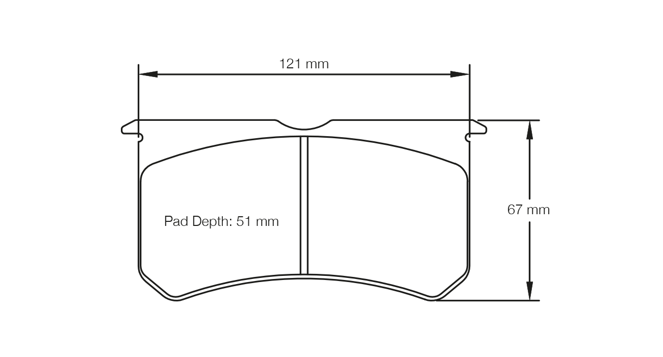

I remember a short thread discussing the C43 kit as a good option for the e46 M3 back on m3f. Has anyone had experience with it? Seems like a good upgrade from stock even if only 332mm rotors. The guys at BW explained that the whole system has significantly more thermal capacity even though the general consensus is that 355mm rotors are what this car needs for track duty.
I never experienced overheating of my stock brakes (PFC DD V3 rotors, PFC 11, ss lines, brass guide bushings) once I installed the cooling ducts. In fact I’m pretty sure that I was overcooling during a cooler track event on the long straights - pads were def below op temp after the straight and encountered some big chunking only after a couple sessions. Point is, I don’t think I’ll have an issue cooling the fronts.
There’s a great deal on the C43 kit right now and I’d like to move into something more dedicated to track use. Any thoughts, for or against are appreciated.
