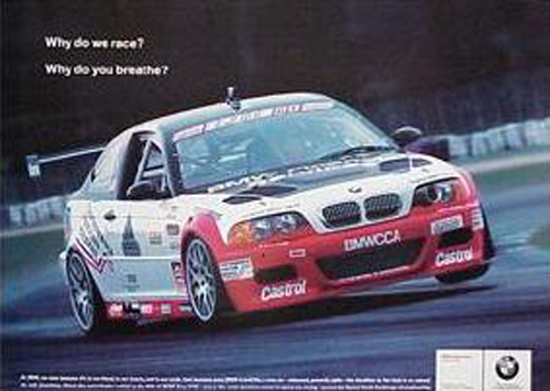

                                My WAG is you probably won't need to make too much of a change, maybe a 1/4 to 1/2 turn. But if you're doing a 1:37 at MidOhio with the chicane, I not sure I would mess with anything!
                                As for the inside front tire lifting, the PTG M3 did that too:
