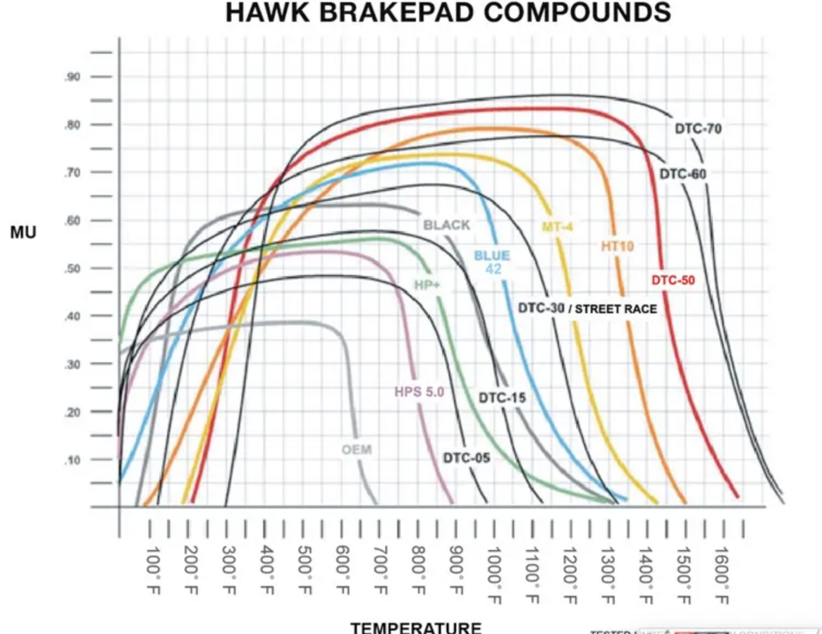

            This could be it - this was my first outing with coilovers, that plus cooler weather and better driving resulted in going from a 1:29.1 to a 1:25.9. Do you guys know if running different compounds front/rear messes with the brake bias too much? I'm thinking of keeping HPS in the rear (to keep costs down) since there's a ton of meat left on my 1st set, and getting DTC-60s on the front next year.
              It could. According to this chart, the DTC-60 and HPS have a very different coefficient of friction and temp operating window:
                Using a pad in the rear that is not made for aggressive braking might be a false sense of economy. An improper pad can actually generate more heat and be worse on rotor wear. As you get faster, the correct pad will probably be cheaper in the long run. The excess heat and rotor wear will result in more frequent placement of your rotors and perhaps even other components like your wheel bearings if you are really overheating the rear end.
                  The pad compound smearing looks like the pad temperature exceeded it's MOT. Which is not hard to believe with the HPS.
                  Run same pad compound front and rear - and I strongly recommend against using HPS on a track.
