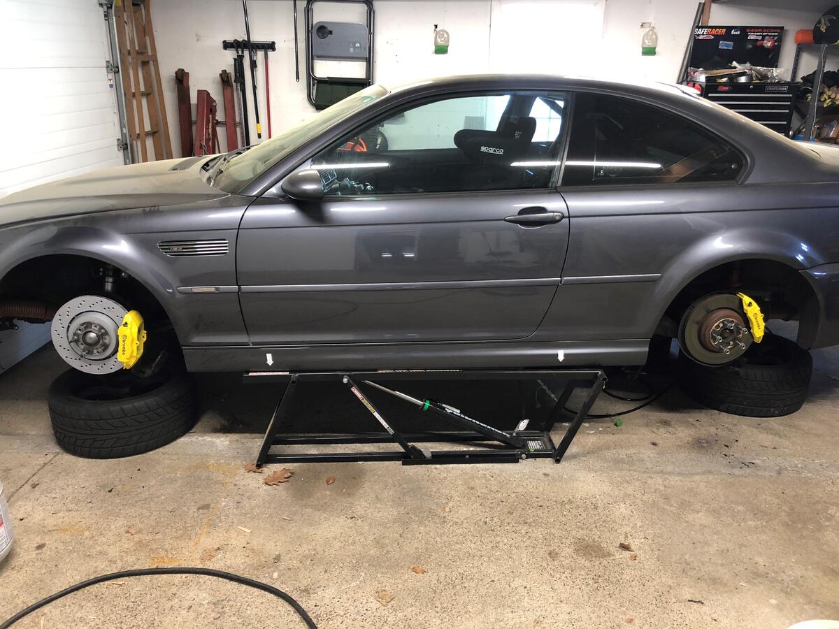

    In November I ordered a nine lives racing Big Wang which still hasn't shipped so in the mean time I tackled a brake upgrade. I chose to go with the 996 retrofit for a couple reason but the main reason being running costs are relatively low (FCP consumables). I contemplated the C43 Stoptech kit but chose against it as I wanted a full 4 wheel kit and adding rears to that kit was quite expensive. The brake upgrade was completed this past weekend and I simply need to bleed them. (waiting on Schwaben pressure bleeder to arrive).

    So, not t a ton of content and only one picture of my car on stands with its new brakes but I encourage others to share their winter projects.

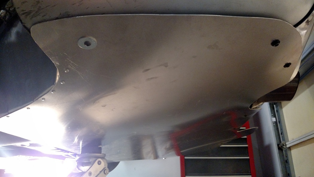

            Rear close out panel after removal of carbon filter canister, supporting hoses and plastic cover.

              looks good. what does the carbon filter stuff weigh?

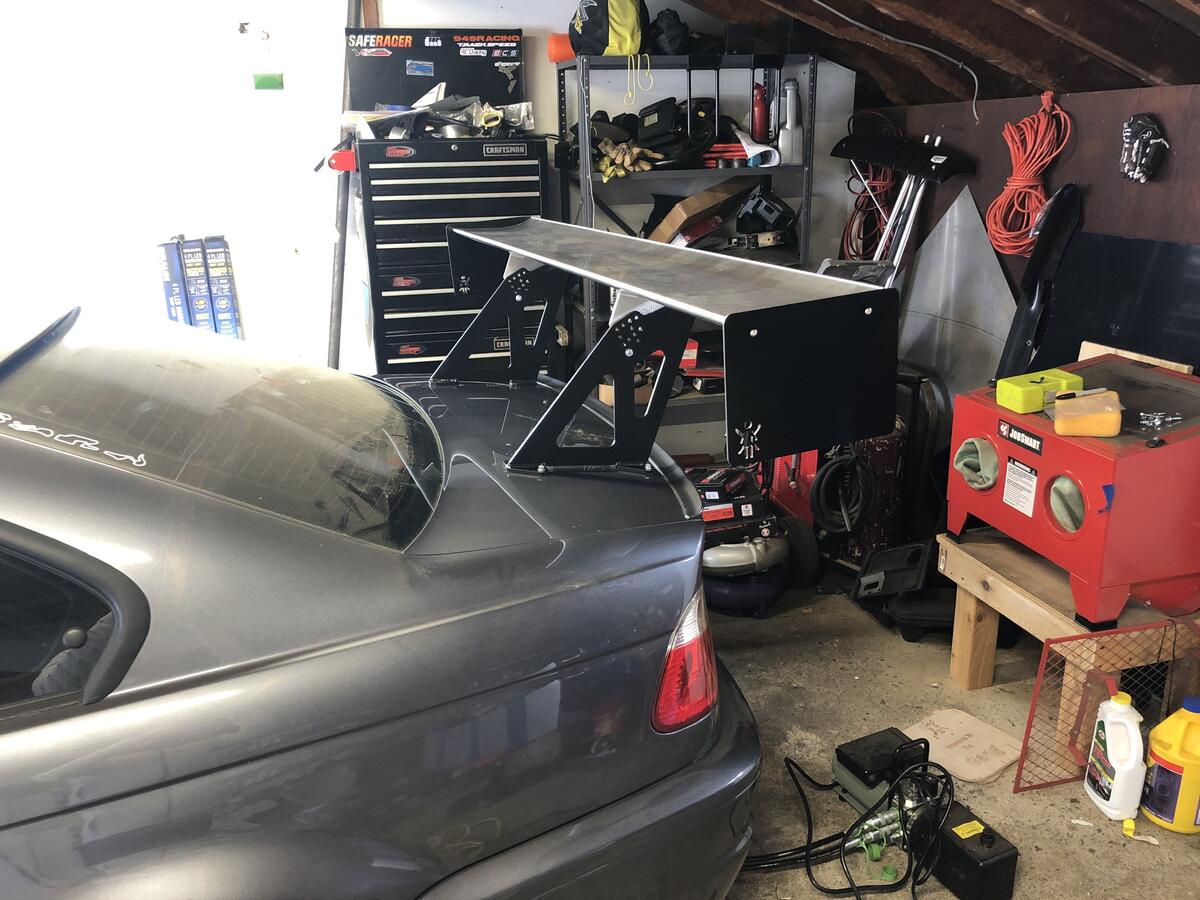

                            My wing arrived so I got it mounted up last night. My initial plan was to mount it to a second trunk lid as I had vision or removing it for testing purposes. after messing around with it a bit and realizing how cumbersome the trunk lid was with the wing mounted I decided to scrap that idea and just drill my stock trunk lid. There is a lot of measuring and making sure the wing is centered and square. Nine Lives provides 0 instruction so your on your own for mounting but its fairly straight forward. I am also going to replace the hardware they provided as some of it is way too long for the task. Next on the list is the re-fabbing of my front splitter and adding hood vents. That should get me about ready for my first event April 24th. It cant come soon enough!
