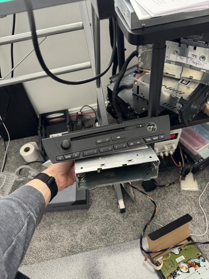

      Click image for larger version  Name:	IMG_3216.jpg Views:	0 Size:	99.0 KB ID:	247562
      Four screws and a ribbon cable later, you can remove the faceplate from the radio. I put foil tape on the cavity, but one of these days I'll 3D print a block off for the leftover hole.
      This Siemens CID-compatible radio still implements the C43/BM24/BM53/BM54 "Nav Radio" protocol, but with the added board monitor functions via the faceplate.
      It sounds better than a standard BM53 and is more robust than them as well, so win/win.

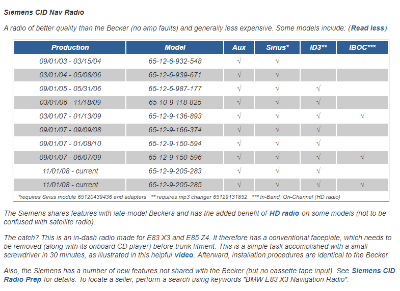

            I would look for the nav radio but with HD radio. Here are some. Main thing is finding one out of a navigation car. Click image for larger version
