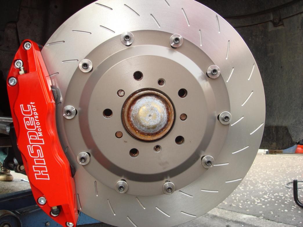

                    :hahaha::hahaha::hahaha: I did not have AP Brakes i had HiSpec 6pot with 380mm Floating Performance Friction Discs :thumbs:
                        Good God :smt107 I bet they worked well
                          Fook me Mark they are awesome! :smokin: How much did they set you back?
                              Fook me Mark, you dont need any wheels size of them just run on the rotors mate !
