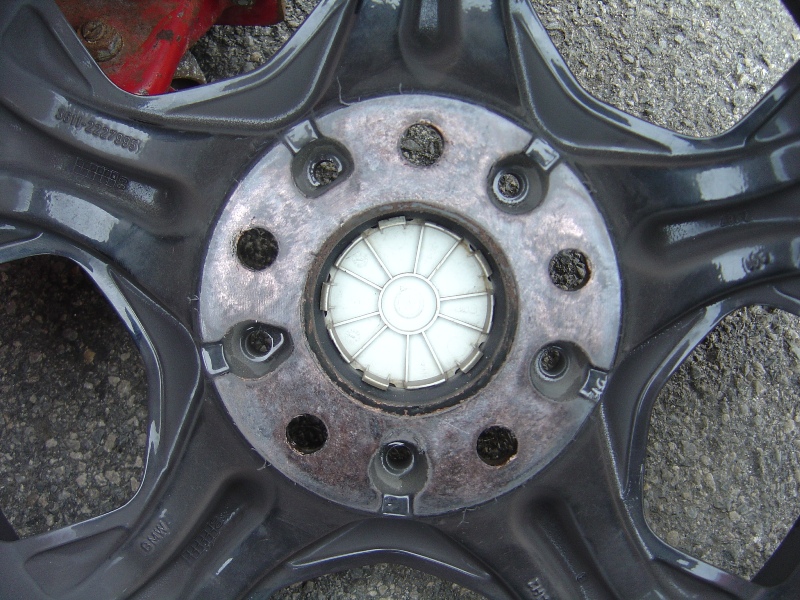

All was fine until I checked the front wheels, one spacer had been fitted arse over tit (refer to above spacer problems) they has fitted the 10mm first and then the 2mm spacer and proceeded to tighten it right down to the point the hub-centric lug sheared off the spacer. Balls, I had all but a few hours to get this problem sorted, it wasn’t going to happen, or was it....
I placed an urgent plea out for anyone who may know of a set of hub-centric spacers kicking about either in the UK or Germany, or anywhere on route. Fortunately for me Darren Langeveld who was organising the Nurburgring track day (www.destination-nurburgring.com) knew of a place in Coventry who would have some on the shelf, he offered to pick them up on route to the ferry and give them to me on board, so I would have them in time for the track day. Perfect, this was the news that I was waiting for and I could finally relax and enjoy the holiday.

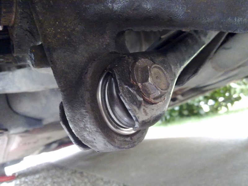

Since getting back I’ve give the car a once over and the only problem to report is one of the lower rear trailing arm ball joints has a small bit of play in it, this is the same joint I was suspected of it having a minute bit of play before I left for Germany anyway, so there’s no shocks there. I’m going to replace the ball joint and use the car for the next few months as it is, will concentrate on taking a bit of weight out of the car and also decide what the final plans will be.

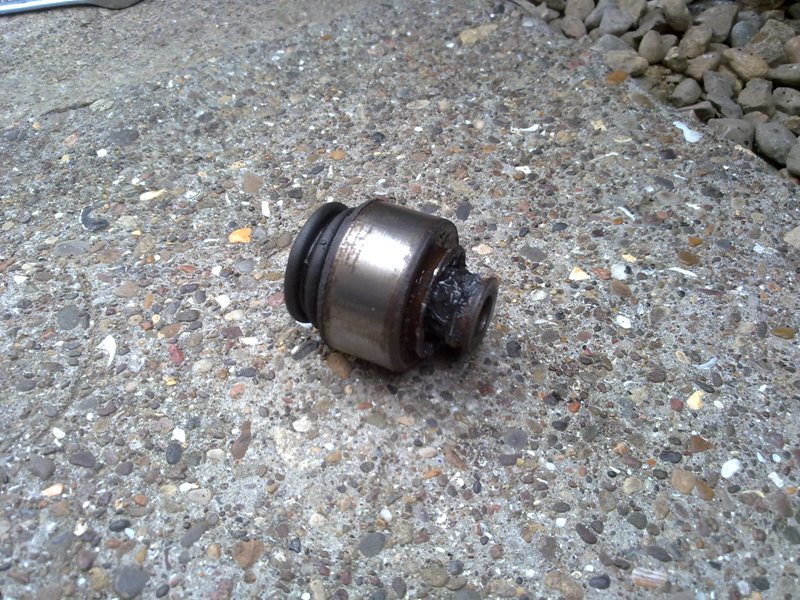

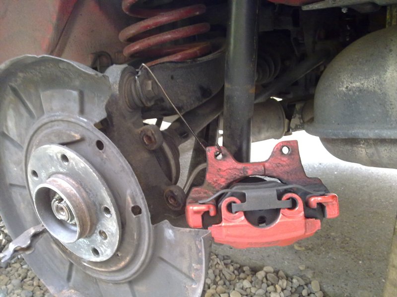

Well as I mentioned in my last update; the passenger’s side rear trailing arm lower ball joint was showing signs of wear and I thought it was best to replace it. Although it probably would never have caused an issue on the road, with me going back to the Nurburgring on the 20th of May I wasn’t going to risk it.

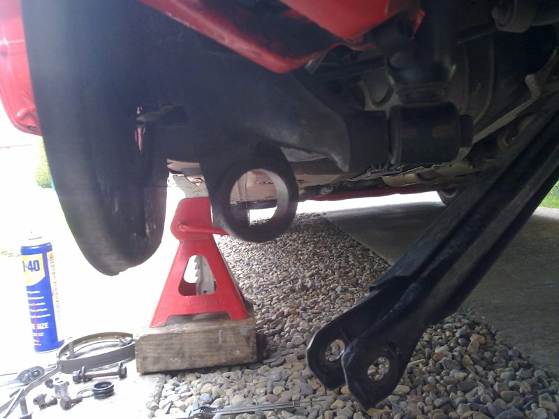

I’ll be honest I wasn’t looking forward to attempting the task, and had visions of me having to drop the rear trailing arm to be able to remove the bush with a press. I did a bit of research and there was mixed responses, some people had managed it with the arm in situ, some had not. Anyway I set aside this weekend to complete the job giving myself time to get the arm to a hydraulic press should I require the use of one.
Started the day by removing the rear camber arm and dropping that out the way, once that was out the way I also removed the rear calliper, rear disc, rear handbrake shoes and then removed the bolts holding the heat shield on to allow a bit more clearance underneath. With all the above items out of the way I then gave the ball joint a few quick squirts of WD40 in the hope it would free things up.
I then set about finding a suitable sized socket to aid the removal of the ball joint, I found with the rubber boot of the joint removed a 1 1/4” socket would fit fine, tapped the socket into place and gave the ball joint a few swift hammer blows. To my surprise the bush was moving so I continued to bash at it until it was free, failing this the tool I made to fit the new ball joint (more on this below) would also double up as an extraction tool.

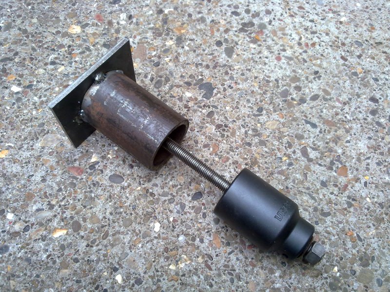

Next step was to fit the new ball joint, I constructed a tool consisting of a bit of tubing, some 5mm steel plate, 10mm threaded bar a 36mm socket and a few 18mm nuts and washers. I drilled a 10mm hole into the steel plate and mounted a length of threaded bar to it with nuts and washers either side to hold it in place, then I welded the steel tube centre of the threaded bar. This would allow the ball joint to be extracted into the tube, if you were removing the ball joint you’d use this with a 1 1/4” socket, but to fit the new ball joint I used a 36mm socket.
Fitment was simple, place the tool to the back of the hole on the trailing arm, slide the bush along the threaded bar and offer it up to the front of the arm, fit the 36mm socket and then a washer and an 18mm nut. Then simply tighten the nut down until the ball joint is in place.

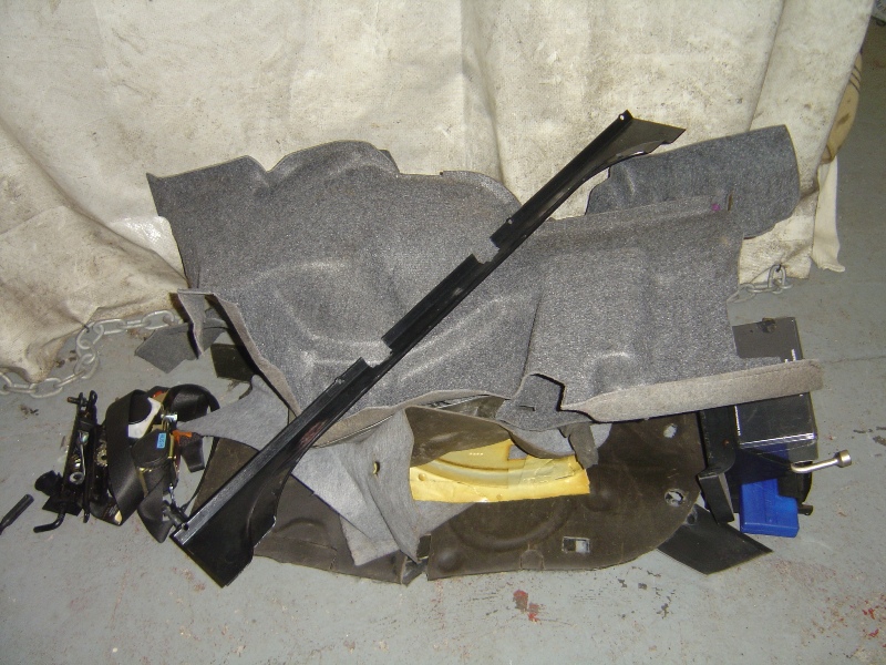

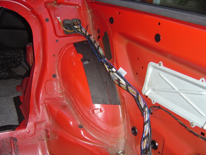

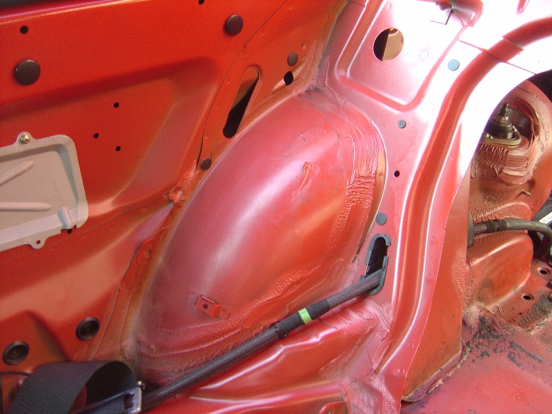

Well today the car was finally committed to the realms of the track car, the weight loss started. I’ll let the pictures do most the talking...
I decided to remove all the carpets from the back, also all the carpet underlay and any other un-needed items in the cabin. The front seat belts were removed including the B-Pillar slide adjuster however I did keep the B-Pillar cover.
The plans are; whilst the car is still used as a daily driver the interior is to be finished in a ‘Club Sport’ spec. I’ve removed the bulk of the weight, and will continue to remove un-needed items including the tar sound deadening (more on that below) but I will be keeping the thin boot carpets just without any of the additional sound proofing under layers. I will remove un-needed brackets however I am going to keep the head lining and A/B/C pillar covers, then once the roll cage has been fitted I’ll trim the rear bench and fire wall with a thin black carpet.
The idea is to remove as much weight as possible whilst keeping the car within reasonable comfort for travelling in, at this moment in time the car will not be racing so there is no need for drastic weight loss and the few hill climbs and sprints the car will compete in will purely be for enjoyment at the moment.

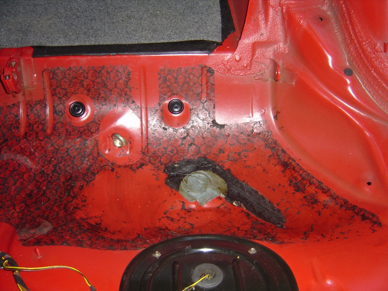

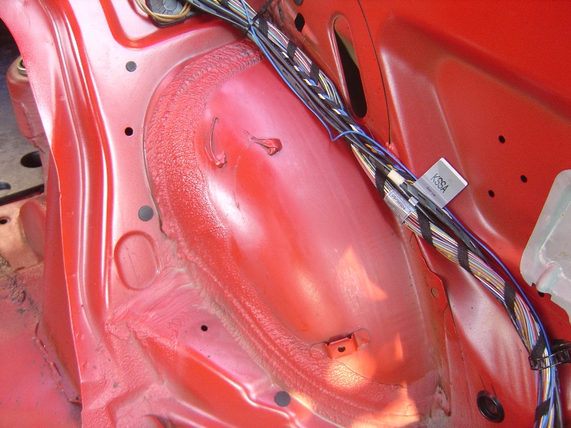

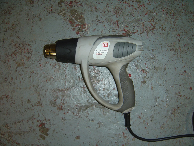

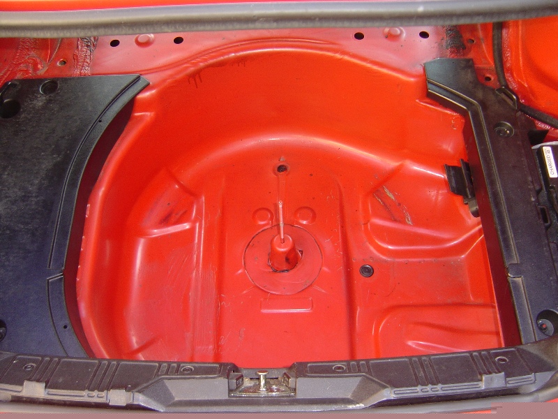

Now onto the tar sound deadening, this stuff is easily removed with a bit of heat and then solvents can be used to clear up the mess left by the glue. I turned to my, well my friends, trusty heat gun to help with the tar removal.
More on this at a later date, sometime in the summer I’ll also remove the main carpet and remove all the tar from under there too.

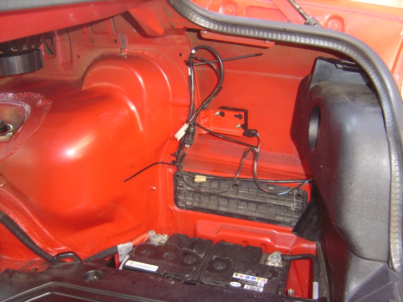

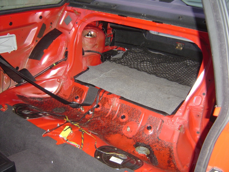

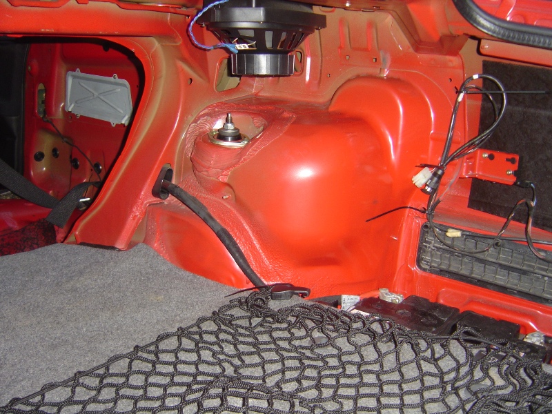

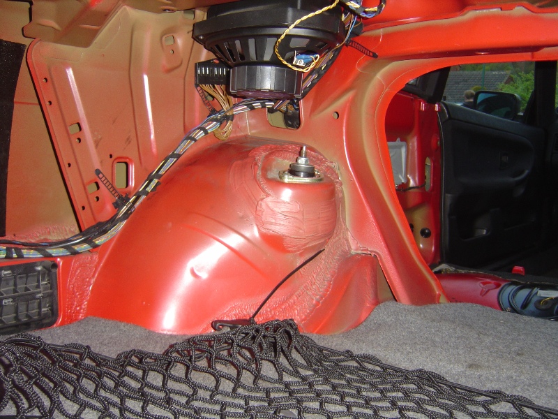

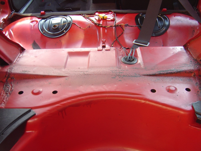

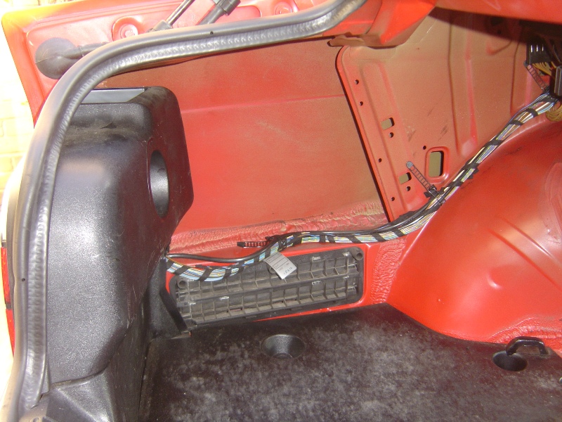

All the junk removed, only the thin grey boot carpeting and the plastic boot trays will be re-fitted. Going to carry on with more work tomorrow, I’m thinking of just using hair dryer heat on the tar that is affixed to the inside of the body panels such as the doors and rear quarters.
Well the tar removal carried on and the following pieces were removed; Spare Wheel Well, Rear Quarters, Rear Bench, Rear Boot Panel and Inner Arches. I also re-fitted the grey rear boot carpeting and my cargo net which secures down anything in the boot as with the seats removed there is no form of rear bulkhead.
