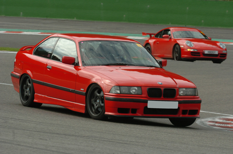

    Craig, I had the same problem with 'melting' the powder coating off the mounting-face of my wheels at Oulton last week. I've got AP's on my E36 and I'd been leaning on them a fair bit all morning. Anyway, just as I turned into Lodge, I got the horrible collapsed bearing sound so went straight into the pits and found my wheel almost hanging off! Scary.
    Had to tighten them up another 2-3 times throughout the day as I melted more coating off the back.
    Apologies for the picture whoreing but this is where all E36's deserve to be these days... on the track :thumbs:

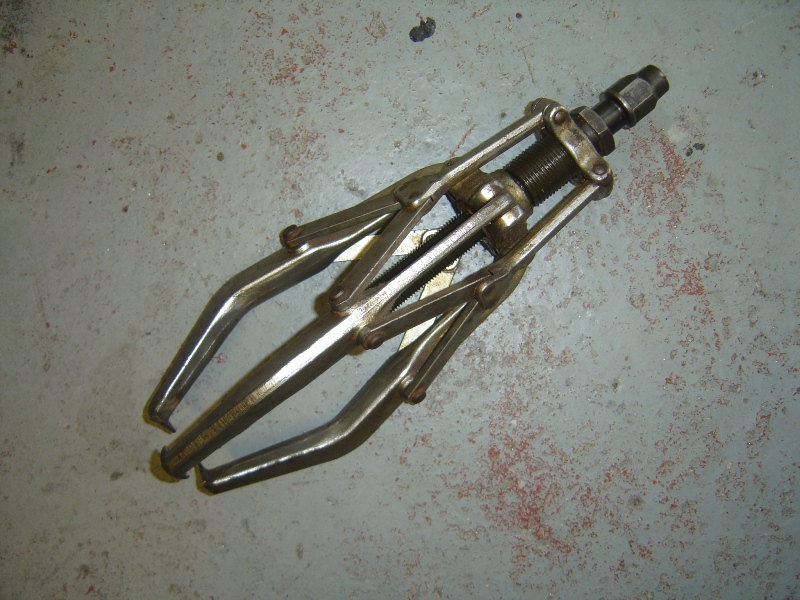

        Nice to know my home made tool is very similar to the BMW tool, and Windy nice looking car once mines got the interior finished off the next parts to attend will be the rear wind and front lip spoilers.

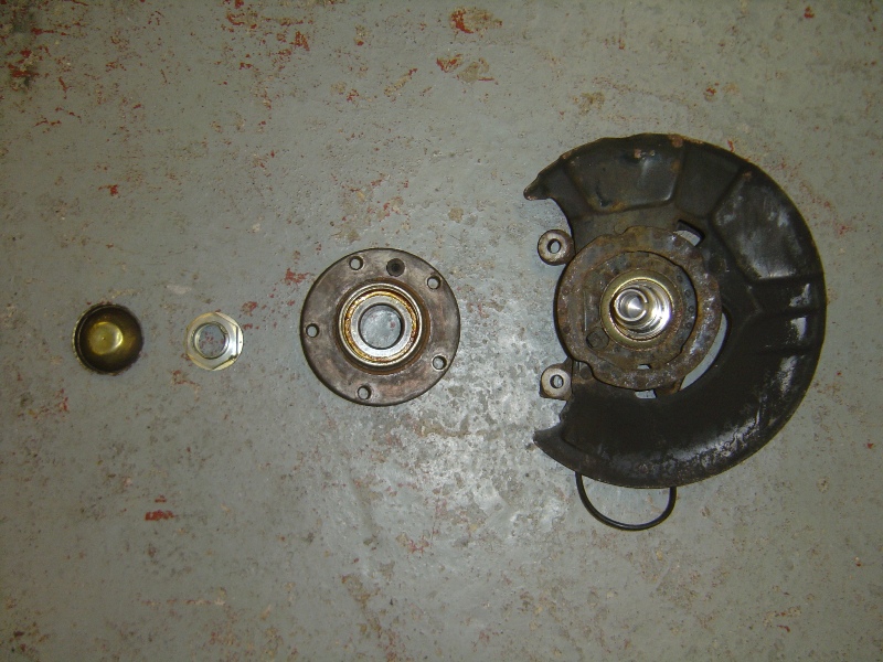

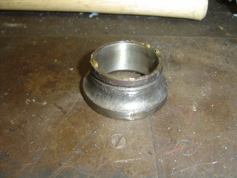

        Speaking of my car, I finally got round to replacing the passengers’ side wheel bearing, first things first though before any work could commence I needed a wheel bearing. Phone the dealers and got a few quotes, now the bearing comes as a complete unit; hub with the bearing pressed into it. This certainly would make the job faster, but at the same time five times more expensive.
        I decided to look into other alternatives, one been pressing a new bearing into my current hub. Now fortunately for me, I remembered I still had the 328i Sport hubs sat in the garage and began cross referencing parts on the off chance they are the same... and they are, bonus!!
        So before I even decided to get the car up in the air, I thought it would be best if I split down the 328i hub ready for fitting. The job in itself was simple enough if you have the right tools the main one been a 46mm socket to loosen off the centre hub.
        Start with removing the brake callipers then the brake disc, next use a screw driver to prise round the outside edge of the centre hub cap. I resorted to tapping all the way round it with a hammer and screw driver to break the seal, and then with a simple twist of a large flat bladed screw driver it simply popped out. With the cap removed the next step is to loosen the hub nut which will require a breaker bar at the very least, you may even have to resort to Mr Scaffolding Pipe too if it’s not budging, don’t forget to also bend the metal locking tab back before loosening or you’ll be there all night.
        With the centre hub loose the next step should be simple, slide the hub off the front upright. If it fails to move with ease you may need a slide hammer, the most effecting slide hammer for this job is fit your brake disc onto the hub backwards with the wheel bolts in by a few threads and simply ‘bang’ the disc back and forth between the hub and the wheel bolts.
        You should now have the hub off, and all the following parts;
        My 328i hub came off intact without any problems, so next step was to get the car up in the air and remove the same parts and slide on the new hub unit, simple, right!? No, when I attempted the task on the car which has the M3 Evo hubs I was left with the inner race off the wheel bearing firmly attached to the hub.
        There is two ways in which this inner race could be removed, one was to cut a fine slot into the race with a dremel then simply split it with a chisel and a swift hammer blow the other method is to use a set of pullers with fine enough jaws to grab the machined lip on the inner race, you cannot get behind the race due to the brake dust shield been in the way. Believe it or not all my small pullers did not have fine enough jaws so I ended up resorting to this beastie which required two people (Thanks Dad!!);
        I was now left with the old hub, inner race and seal off the car.
        Now with the inner race off the car was ready for its new hub, I simply side the hub onto the upright, it required a few light hammer taps to get it sitting all the way on the shaft but jobs a good ‘un. Next was to fit the hub nut and torque it up to 300nM, refit the dust cap as well as the brake discs and callipers, fit the wheel and lower the car onto the ground and you’re done!

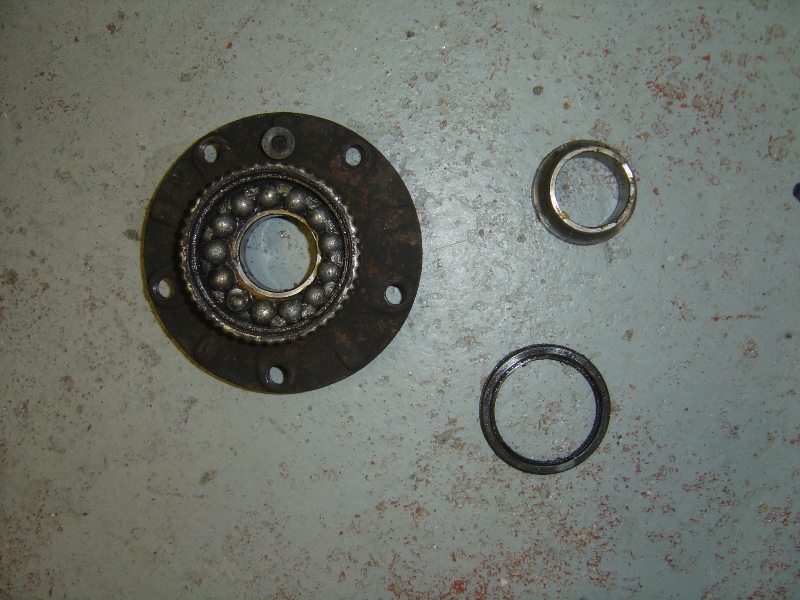

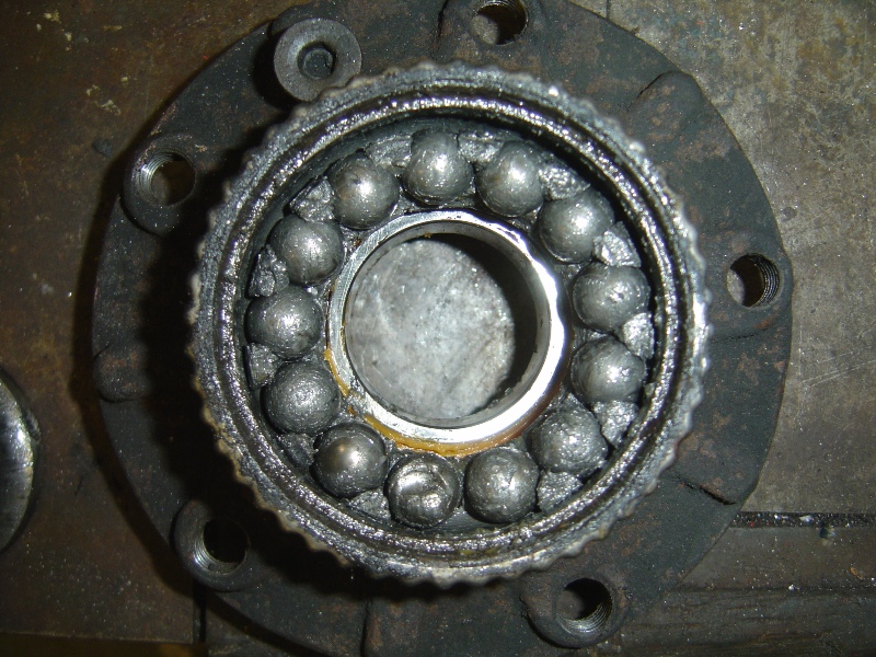

        Here is my old bearing, you can see its shot inside just look at the ball bearing on the bottom of the picture. First sign of the problem came with a weird vibration which went away, jacked the car up and the bearing felt fine then it came back and got progressively worse. Upon the next check you could hear the difference between the sides, one bearing ran smooth, the other smooth but it had a grumble to it.

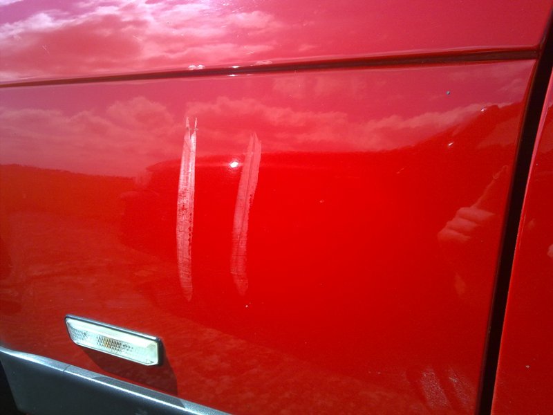

        I also got round to one other minor task, on the way up the A19 after dropping off an e46 M3 CSL DSC unit to a guy who was in desperate need of one I lost a front kidney and the grill behind it, no idea how but fortunately I also had the old standard chrome ones which I took off.
        First step was to wash it off the fairy liquid to remove all greases and grimes, next it was wet and dried down to give the surface a key and then I applied 3 coats of grey primer and 3 coats of gloss black paint. Unfortunately my camera died during this process so I only have the one picture.
        Once again the car is back to 100%, apart from been used daily its next major outing is at RAF Barkston Heath for a sprint event, more on that later.

          First run out really did illustrate just how tight the circuit was, and the chicanes were so tight I had visions or me re-modelling them during the course of the day, in fact my first question to the clerk of the course was ‘are those white marker poles plastic or metal!?’ after all I didn’t want to risk serious body damage.
          Fortunately for me they were plastic, as I proceeded to hit my first one. However the one I hit was on a small square base that wasn’t set level, so it ‘twanged’ up against the car making a neat white mark (which would later polish out) one thing it showed I was using as much as the track as physically possible, and I was consistent too as I hit it a second time *doh*.
          I was obviously getting faster as the day progressed as the white lines got further and further down the wing!!

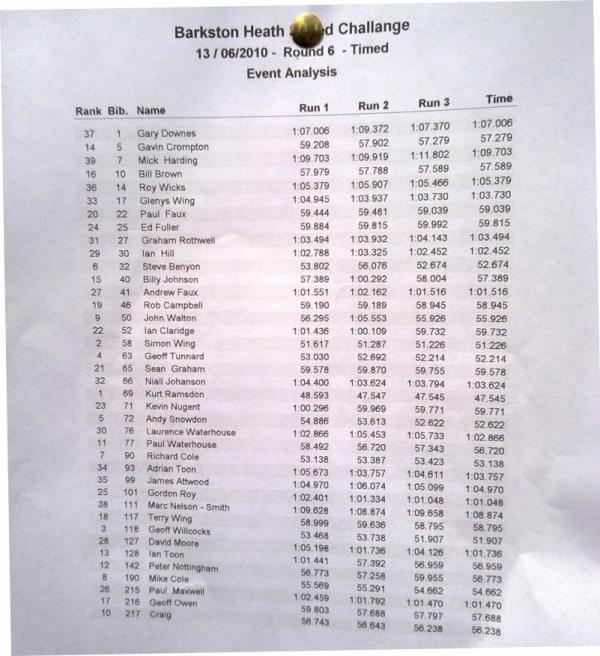

          Afternoon came about and it was first of the timed runs, at first I didn’t pay much attention to the times and just used the runs as more track time and to play about with car control. However after I was informed the BMW wasn’t dead last, and in fact it was actually quiet far up front I started to take an interested and was hooked checking my times after each run, I had officially been bitted by the sprint bug.

          As the day came to rest and the final times were up and overall the BMW had come 10th out of 39 and in its class it was second only beaten by a really nicely prepared Subaru which looked far from standard, was I happy? You bet I was.

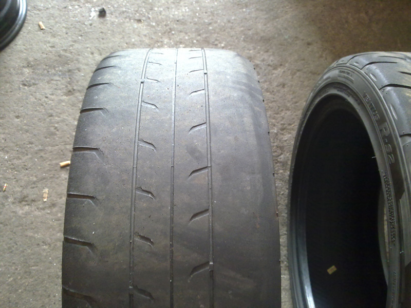

                  This thread is long overdue an update, although not too much has changed I’ve just spent the last few months enjoying the car and making the most of the Summer / Autumn months.

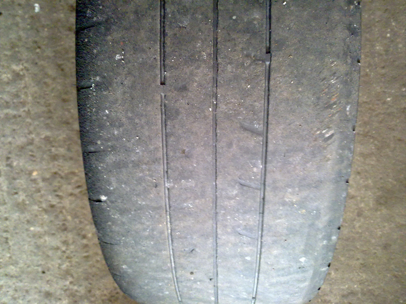

                  First up, the Kumho V70a’s... I managed to get 8,000 miles out of the front tyres, and 11,000 miles out of the rears which to me is pretty impressive given that their track day tyres. Not to mention the fact that the car is used on track on regularly and driven spiritedly on most outings. As you can see from the pictures below they wore pretty evenly too, a sign that the geometry is correct.
                  Would I use these tyres again, yes without a doubt!!
                  At this very moment in time though, now the bad weather is here, I have a full set of Falken 452’s fitted and I also rate these, exceptional wet grip and feedback and pretty good in the dry too. A great ‘all year’ tyre which again I’d recommend.

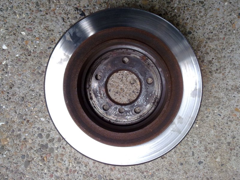

                  The rear brake pads were finally up for renewal, upon changing them I noticed some cracks in the rear discs however the camera hasn’t really captured them.
                  I managed to get outstanding mileage with the Mintex 1155 front and 1144 rear set up, the fronts far out lasted the rears and still had 50% life left, but I changed them anyway due to the fact the front discs needed replacing.

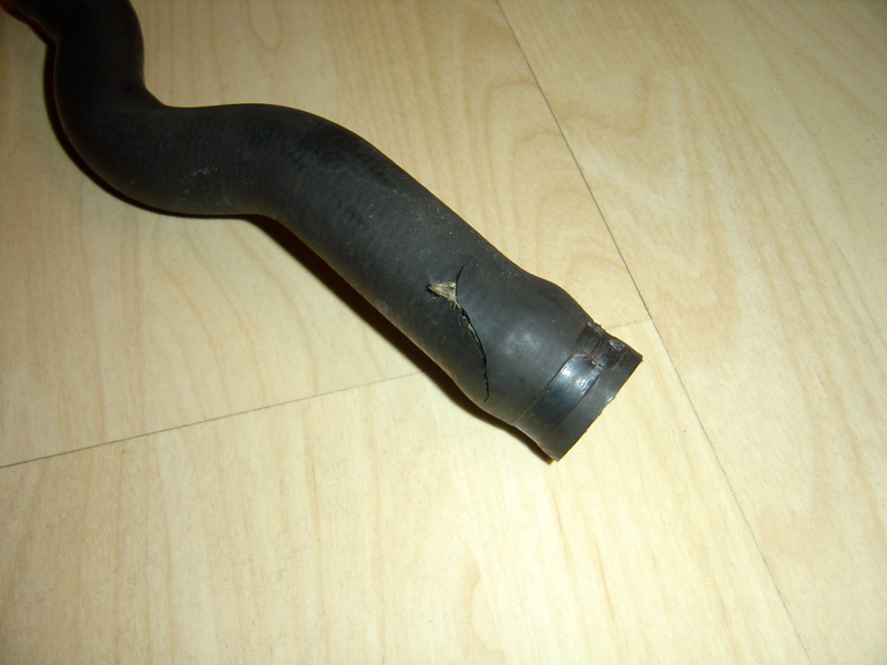

                          The day was not without drama, we decided that the latest we could leave for the ferry port was 15:30 in order to make it in good time. I decided at 15:10 to do one last session, famous last words I guess but at 15:24 I saw the coolant light creep and amongst a lot of swearing I pulled over to find that the car had burst a coolant hose!!!
                          Panic set in, but fortunately the whole group chipped in and we managed to by-pass the hose that went from the block into the heater matrix valve using one of the existing pipes, this would leave the car without a heater but still least it would get us home. We had to make another sacrifice, the scuttle panel cover had to be cut off as we could not get the wipers to release, but this is easily replaced. Work complete the car was filled with coolant (read: tap water) and it was time to go, we left Spa at 15:57 and had some time to make up, but fortunately made the ferry with 6 minutes to spare!

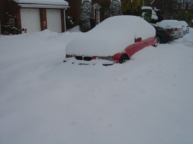

                            Well winters well and truly arrived, had a planned outing at Mallory Park booked for the 28th of November but that got cancelled due to the snow and the cars barely moved a wheel since then!
                            I managed to pick up a Rover 400 cheap, which very quickly got nicknamed Snover R400, to use through the snowy months... that is if it lasts that long, its verging on the edge of the dreaded head gasket failure and the massive mounds of snow I’ve rammed it through have started to pull its exhaust off at the flexi-pipe!
                            Anyway, less Rover talk; I now need to decide what to do with the BMW whilst it’s off the road. Do I leave it as it is, keep using it till it dies then let its soul rest in scrap heaven or do I spend some money on the old girl? To get the car exactly to how I want it to be, at the bare minimum would involve replacing the suspension (again!), fitting a roll-cage, fitting a different steering wheel, fitting a GT splitter and spoiler, replacing a rusty wing and maybe sort a few bodywork niggles out before the tin worm starts to spreads. This all costs money and that doesn’t take into account the worry that the car is now on 182,000 miles and could be due a clutch / gearbox / engine at any moment.
                            Decisions, decisions... What I do, like, no LOVE about this car is the fact that its stood for 4 weeks under a huge mound of snow and all I did was clear the snow, turn the key in the ignition and it fired straight into life as if it has only been run the day before!
                            Its moments like these that make me want to stick it out, keep the car and turn it into my vision of a perfect e36.
