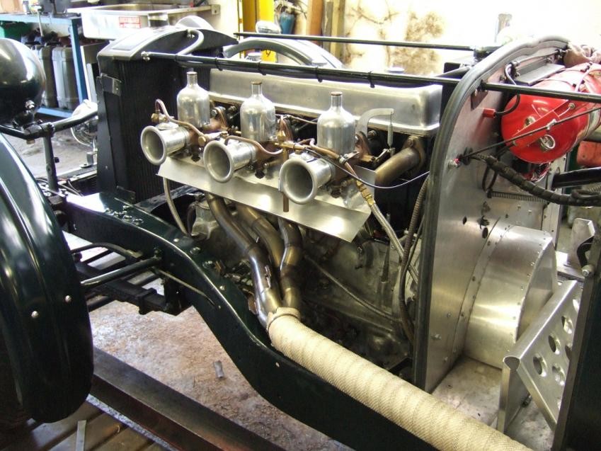

                          It'll make next to no difference the oil temps. There are slight benefits as outlined by The Gorilla. I have a fair amount of experience with ceramic coated exhausts as we use them a lot on the cars we work on but that is only because of the close proximity of carburettors/fuel lines, etc. They help a lot with fuel percolation issues. The issue is fairly well illustrated in the following picture, although this is before we coated the manifold.
                          I'd be more inclined to used ceramic coating on turbochaged road cars but less so on N/A.
