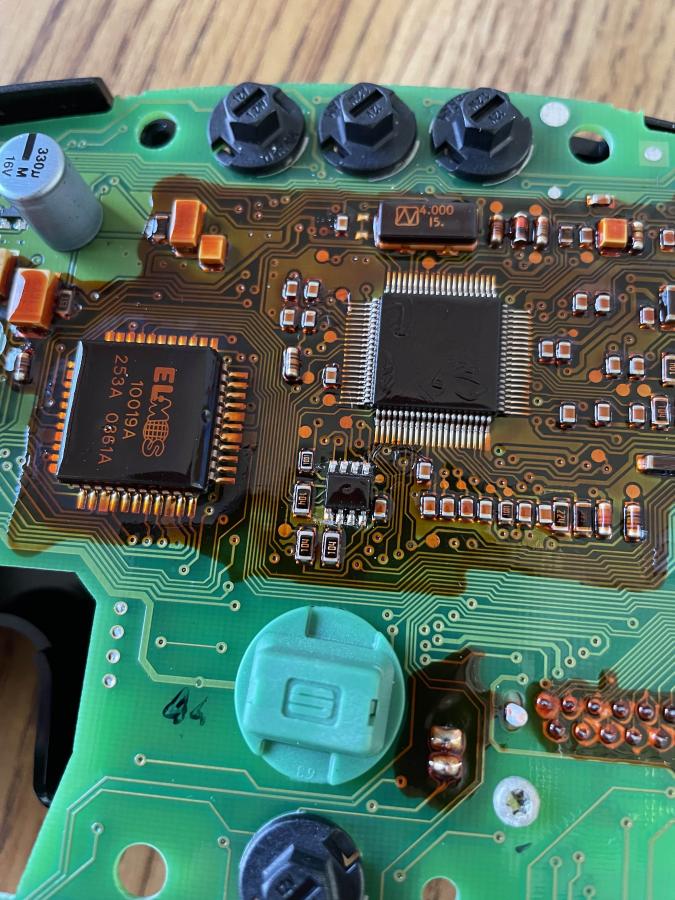

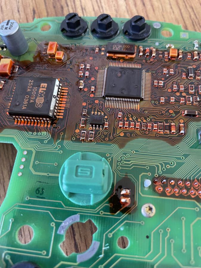

    Step 2: The EEPROM chip is covered in a protective coating (as shown). This can be removed using a small amount of heat from a heat gun or hot air soldering station, and something blunt to scrape(I use a small screw driver). Being very careful to not damage the chip or the legs, scrape the protective coating off of the legs of the EEPROM chip.
    Click image for larger version  Name:	IMG_5445.jpg Views:	13 Size:	117.1 KB ID:	221868​Click image for larger version  Name:	IMG_5444.jpg Views:	9 Size:	122.7 KB ID:	221869

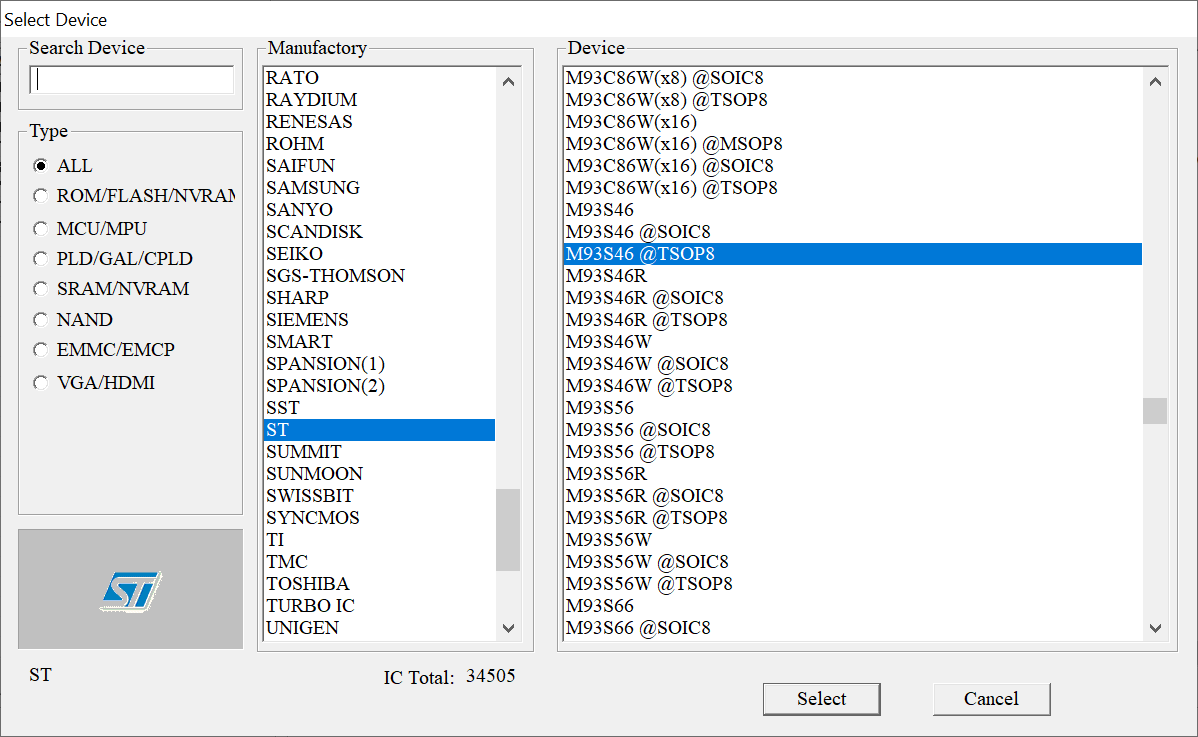

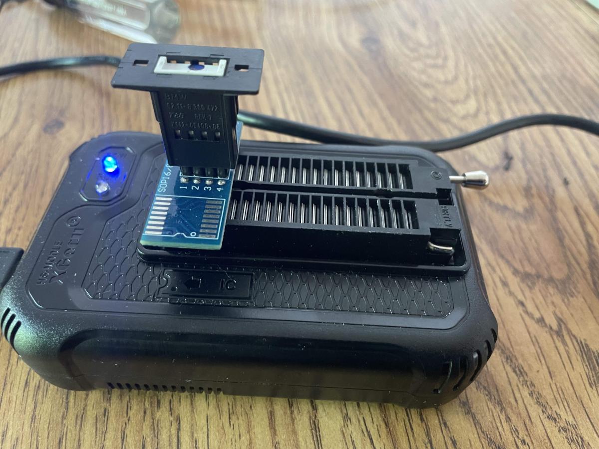

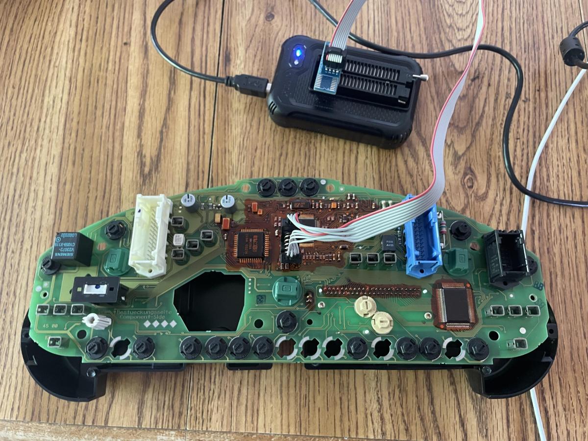

    Step 3: Connect the EEPROM burner to the computer, load the supplied software, and connect the burner to the EEPROM directly using the 8-pin EEPROM chip clip. Pay attention to the orientation of the red wire (pin 1) as shown in the picture.
    ​Click image for larger version  Name:	IMG_5676.jpg Views:	9 Size:	197.8 KB ID:	221870​

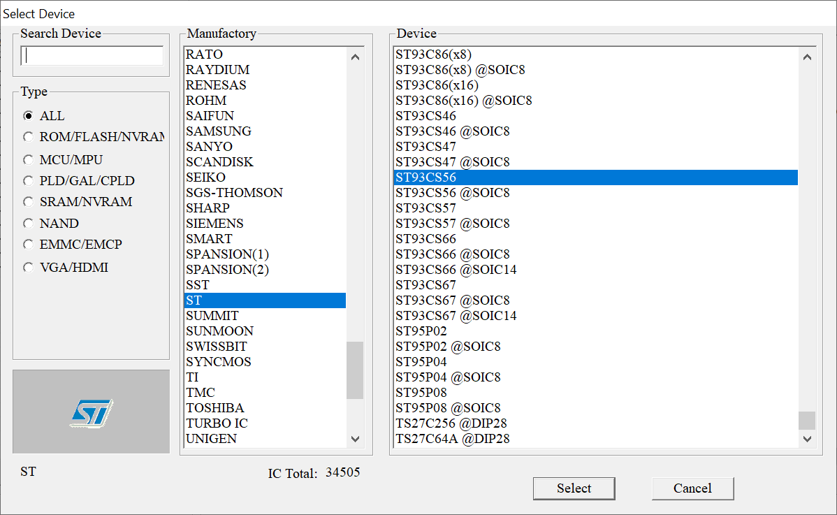

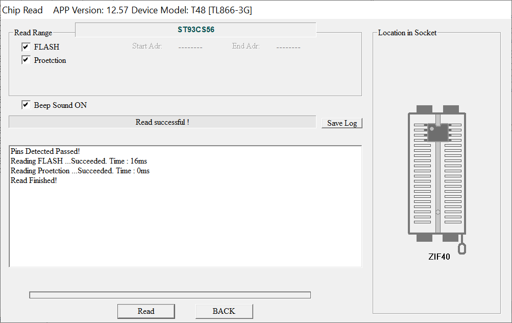

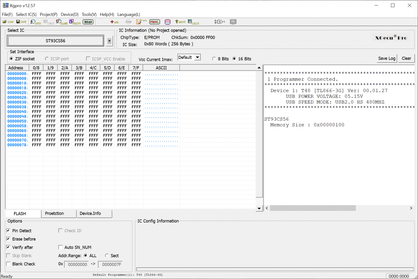

    Step 4: Using the chip select function in the software, select ST93CS56, and read the chip. This may take a few tries, as it is difficult to make a good contact with the chip, using the chip clip. Reposition the chip clip until it makes a good contact with the EEPROM chip, and is able to read. Save a backup of the original Z3 Non-M dump to the computer.
    Click image for larger version  Name:	Capture3.png Views:	9 Size:	91.3 KB ID:	221872​Click image for larger version  Name:	Capture2.png Views:	9 Size:	580.1 KB ID:	221873​Click image for larger version  Name:	Capture4.png Views:	10 Size:	26.2 KB ID:	221874​

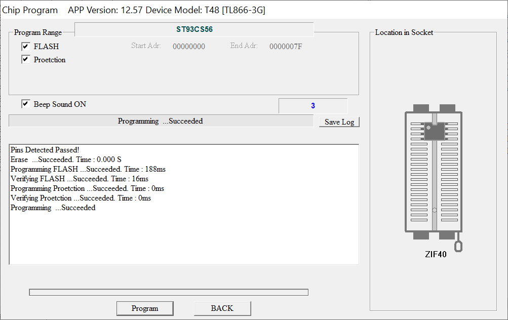

    Step 5: Load the low mileage Z3M S54 EEPROM dump into the program. Make sure the file is correctly loaded, and then program the EEPROM chip using the program button. This will probably fail, giving a sector write error when verifying the flash. This is because the ST93CS56 chips are difficult to flash. Read the failed flash on the chip, and confirm that is flashed some of the file correctly. In order to finalize the complete flash, you may have to disconnect and reconnect the chip burner from the computer, close and reopen the program, play with some settings, and reboot the computer. Keep attempting to flash the chip, until it successfully flashes the complete file. This make take some time and patience before it successfully flashes it. When starting up the cluster, if it displays EEP-2 error, that means it didn't successfully flash the chip completely.
    Click image for larger version  Name:	Capture5.png Views:	11 Size:	33.6 KB ID:	221875​

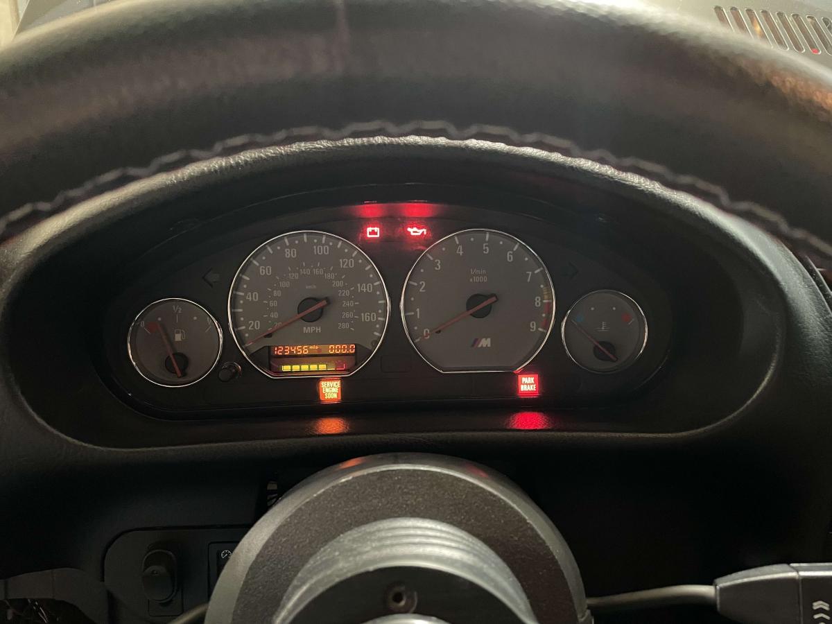

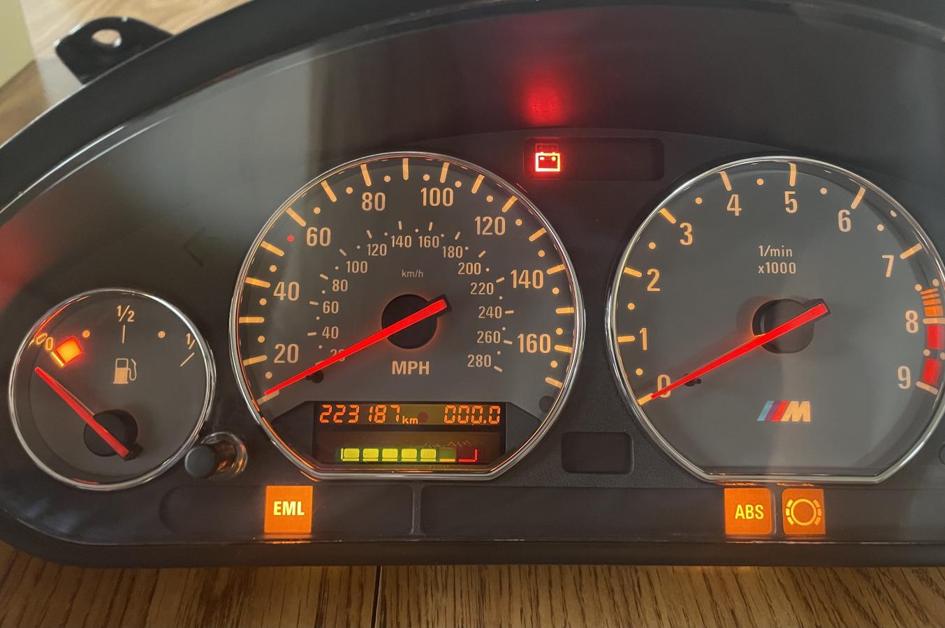

    Step 7: Reinstall the coding plug into the main circuit board, connect the circuit board to either a bench harness, or a complete E36, and make sure the mileage is correct and no EEP errors are present. There should be a tamper warning dot present in the odometer. This is because the internal EEPROM mileage differs from the coding plug. This will be fixed later. Reassemble the back half of the cluster clamshell. Install the replica gauge face in the front half the the clamshell, and red needles if desired. Gauge face installs and needle swaps are covered in many other DIY's, so I won't be showing that step. Fully assemble the cluster and test it. You can confirm that the programming was completed successfully, by connecting to the cluster using INPA, and accessing the “coding” menu. If the programming was successful, it will show a “speedometer limit stop” of 267 km/h.
    Click image for larger version  Name:	IMG_5476.jpg Views:	10 Size:	225.9 KB ID:	221879​Click image for larger version  Name:	image.jpg Views:	639 Size:	30.0 KB ID:	221909​

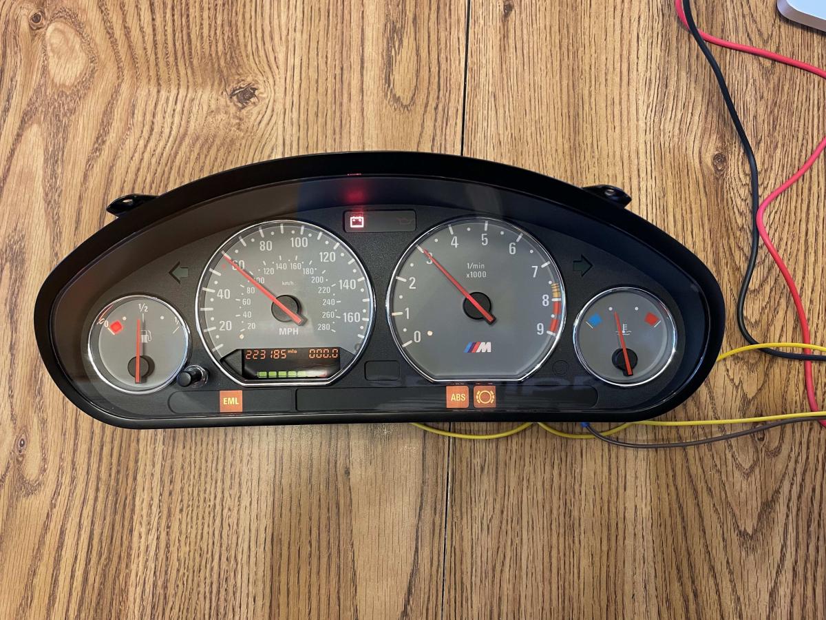

    Step 8: Finally, wire in the CAN bus and A/C into your S54 Swapped E36 (I can provide wiring instructions if necessary). Then install the cluster into the vehicle. In order to clear the mileage tamper dot, with the cluster installed in a drivable car, "sync" the mileage between the coding plug and the EEPROM using the built in cluster test 19 to unlock the cluster and test 16 to "sync" the mileage. Instructions can be found at https://www.zroadster.net/forum/viewtopic.php?t=39603 The car must be driven at least 2 miles without the cluster loosing power, in order to finalize the mileage "sync". Finally, enjoy your 8000 RPM tachometer and working A/C on your S54 swapped E36.
    Click image for larger version  Name:	IMG_5496.jpg Views:	10 Size:	88.5 KB ID:	221880​

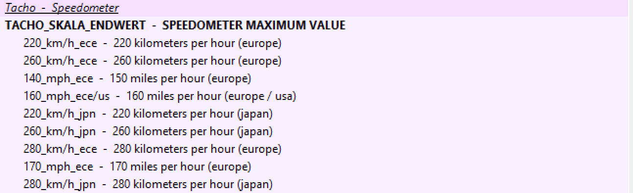

    Cool stuff. I never messed with E36 stuff - can NCS tackle some of this? Sure seems like the parameters are present.
    Mileage would still have to be addressed.
      As far is I can tell, NCS Expert can’t do any of this. Technically this is programming, rather than coding. Possibly WINKFP could.

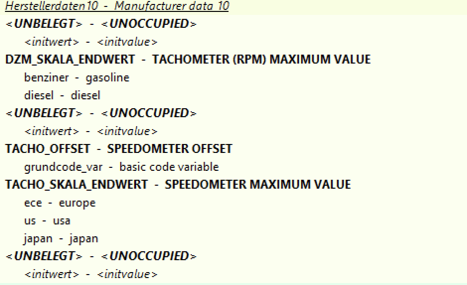

        SPI stuff would be within the real of "coding". On these older clusters (everything pre E9x) the actual software is embedded in a ROM (almost always not erasable) within the CPU.
        NCS Dummy shows definitions for these, but that doesn't always mean they're editable.

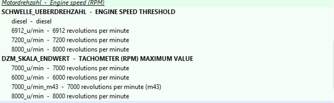

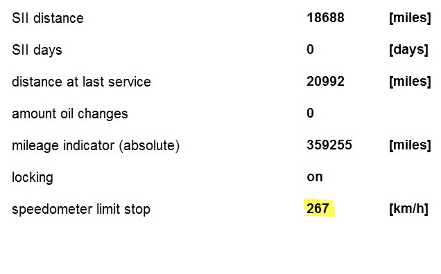

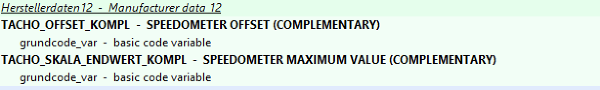

        Click image for larger version  Name:	Screen Shot 2023-06-14 at 10.02.10 PM.png Views:	0 Size:	25.7 KB ID:	221929 Click image for larger version  Name:	Screen Shot 2023-06-14 at 10.01.40 PM.png Views:	0 Size:	27.4 KB ID:	221930
        Edit: Okay I see why I'm confused. KMB_E36.C25 is apparently not actually used. The real one is KMB_E36.C02, which does show parameters like below, but typically the "manufacture data" is not editable. *Might* be able to edit the parameters with nettodata coding. But otherwise, yeah direct eeprom coding is needed.
        Click image for larger version  Name:	Screen Shot 2023-06-14 at 10.11.16 PM.png Views:	0 Size:	28.6 KB ID:	221931 Click image for larger version  Name:	Screen Shot 2023-06-14 at 10.10.58 PM.png Views:	0 Size:	13.1 KB ID:	221932 ​
          Correct, terra. The parameters can be viewed using NCS Expert, but the “manufacturer data” is not editable. I’ve also tried nettodata coding, with no luck. To my understanding, those sectors of the EEPROM are read only over diagnostic line. Also, I’m pretty sure the Z3M uses KMB_E36.C03, not KMB_E36.C02. Direct EEPROM coding makes the process quite easy and simple.

                      Do you know what byte to change to change it from Miles to KM?

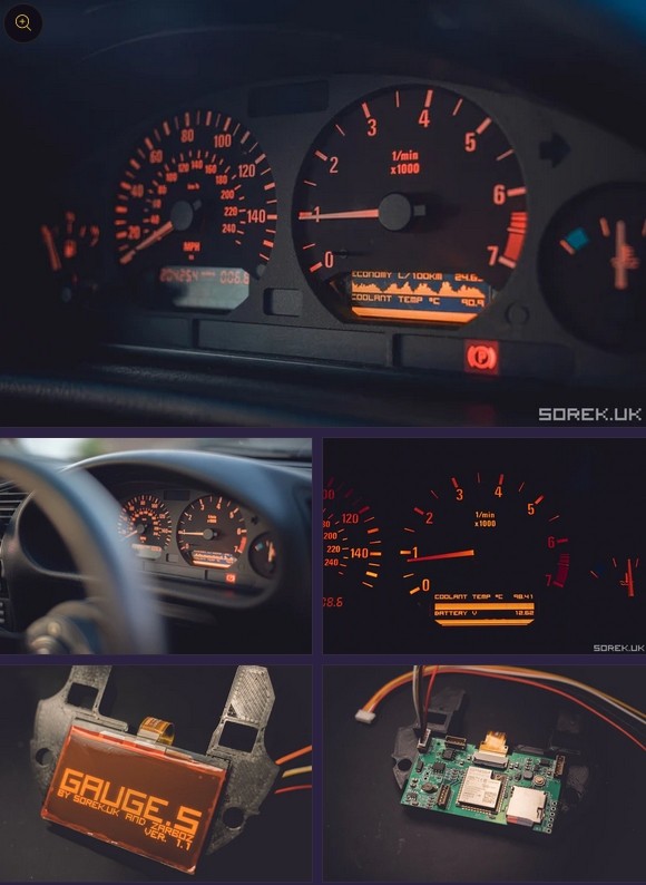

                      I'm going to integrate Gague s in mine.
                      Click image for larger version  Name:	Clipboard03.jpg Views:	0 Size:	81.6 KB ID:	223488
                      This will give me Oil temp, Level, Logging, coolant etc.
                      This will be a much cleaner solution. Not to mention the convenience of not turning your head to look at other gauges.

                        ZiMMie, I just sent you a PM with the EEPROM file. Changing the odometer from miles to km is very easily done using NCS Expert. If you aren’t able to do that, I currently have two km clusters in my possession that I can get a dump from and send you the file.
                        I’m interested to see how your gauge.s install turns out. Post some pictures of it when you’ve finished. I’ve had a couple of people ask me about gauge.s installs in Z3M clone clusters.

                            I'll definitely post updates in this thread.
                            I'm actually curious if the CAN ID are the same as I'll have to defined them manually with gauge.s.
                            The predefined documented messages here were sniffed off an MS43. Bmw tend to keep the messages the same on the same chassis but you never know with the CSL software.

                              It’s interesting that gauge.s requires you to manually define the CAN id’s. It was my understanding that it used one of the diagnostic lines going to the cluster to get its data. I thought it was also plug and play with native MSS54 support. I don’t know very much about the gauge.s, so I’m probably just misunderstanding something.
