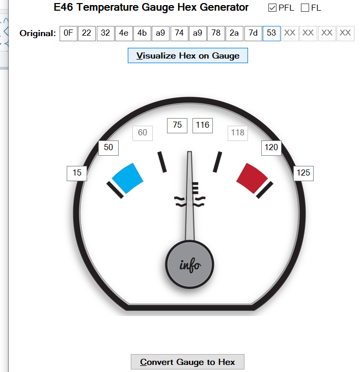

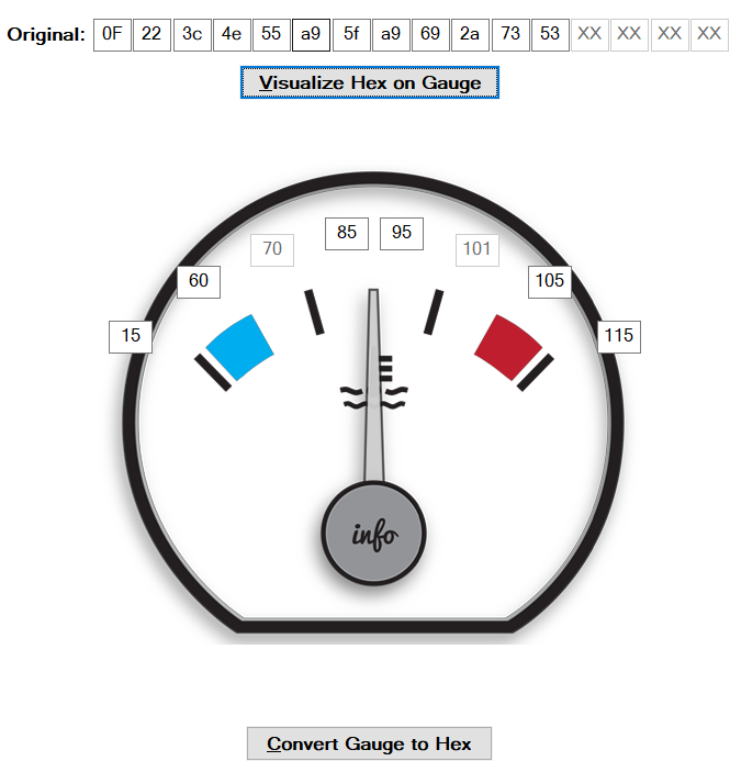

                        I tried changing the gauge calibration string on a friend 3.0l Z3. For some reason it doesn't work, as soon as I program my custom string in the 93S56 EEPROM the cluster shows EEP_2 error and none of the gauge works. I tried both UPA USB and Xprog, programming process ends succesfully with each one. I verified every flash by reading the eeprom afterward, no difference between programmed file and read file. Of course, if I program the stock EEPROM file back everything works fine again.
                        Here is the stock gauge string : 0F 21 32 4E 4B A7 73 A7 78 2A 7D 53 which is 15 50 75 115 120 125°C.
                        Here is the modified string : 0F 21 3C 4E 55 A7 69 A7 6E 2A 73 53 which is 15 60 85 105 110 115°C.
                        Seems to me that there is a checksum in the file because that's the only explaination that come up to me for the program to throw an EEP_2 error. I would like to understand because it's a useful mod on the E46.
