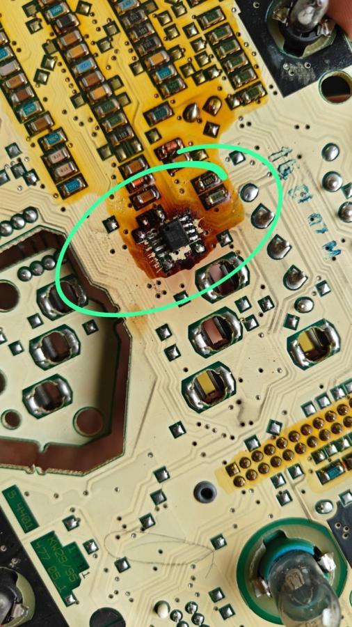

                        #41
                        hey mate,
                        I am trying to change the mileage for the cluster , as my older cluster is damage and i got another cluster, now i would like to write the orig km, which i am unable to do so, rear 93c46 code plug and main eeprom (unknown chip), seems the main eeprom is corrupted now as now the cluster diplayed eep-2, before when i was trying to rear and write code plug eeprom the km was showing same.
                        i have attached both the file for cluster, can you help me to reflash and send me , or if you have new file to be reflashed please help me to send.
                        i would like to know while writing the main eeprom the error pops up in programmer (DSP3+) code error while writing which means chip is not rewriting the data, even now i am trying to rewrite orig dump also it is same. so cna you tell me which eeprom it is so i can use new eeprom and reflash with new dump.
                        thank you​
