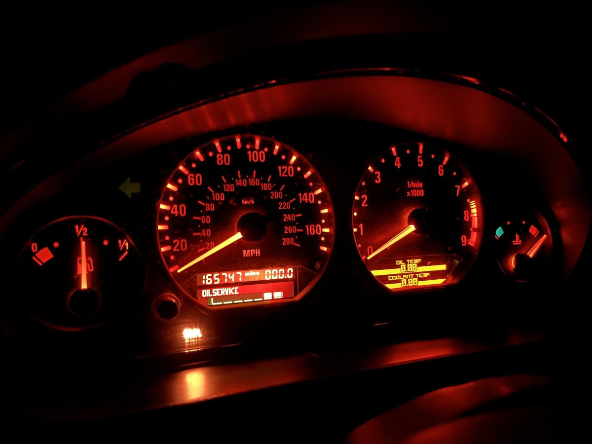

                          I just rebuilt my cluster for my S54-swapped Z3. Here are the major additions:
                          - I used the EEPROM coding bin file JBanzhaf kindly sent me, and the chip seemed to flash on the first try using the EEPROM writer tool he recommended. I did not alter the coding plug, so the mileage tamper light was on, but I was able to sync the mileage with the trip reset button, navigating through the menus.
                          - I used gauge faces from Speedometer Conversion Solutions in Utah; they have black gauge faces that give more of a 'sleeper' 90s vibe.
                          - I installed a gauge.s from Sorek. This involved cutting the gauge faces with a razor blade, finishing the cut with sandpaper, and using some dark metallic paint to match the housing walls to the other window. This process was tedious but well worth it, the Gauge.s looks very OEM+, and I doubt 99.9% of the population could tell it is not OEM. I wired the button for the Gauge.s to a modified fog light switch, where I removed the latch, so it is now a momentary pushbutton. This lets me monitor/log all of the data on the K-Line, so for an S54, the important ones for me are Oil temp, Coolant temp, and IAT.
                          Huge shoutout to JBanzhaf, he made this possible for me.
