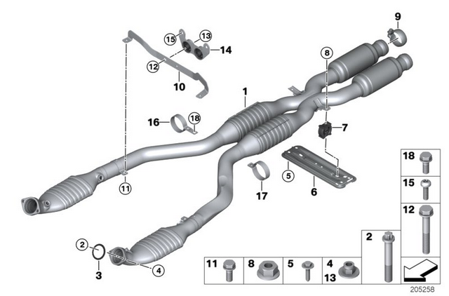

      The primary cats are at the very front of the center section:
      Click image for larger version  Name:	RealOEM E9x M3 exhaust center section.png Views:	0 Size:	172.8 KB ID:	130978
      The gaskets in question are #3 in that pic.
