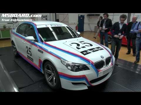

BMW showcased an M5 E60 with the DCT transmission of the M3 E92 for their 25years of M5 anniversary.
They used that car to test the DCT for durability and it shows that Getrag DCT and MSS60 can be done, the question is how.

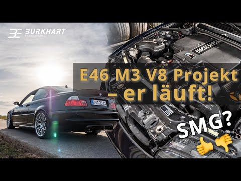

I know from a German tuner (Burkhart Engineering), who built an M3 E46 with a S62 and the 6 speed SMG from the original car and this is quite a similar situation.
MSS52/MSS54 and MSS60/MSS65 look to be very, very similar. Afaik its even possible to convert (solder) a 6cylinder MSS54 to a 8cylinder MSS52 whilst retaining the program area of the SMG capable MSS54.
