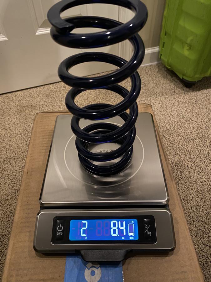

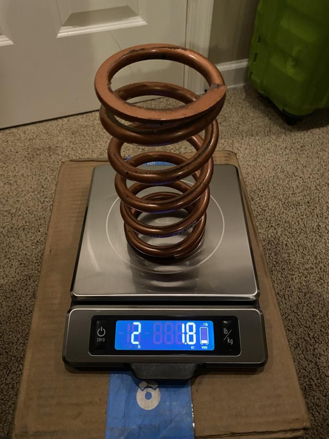

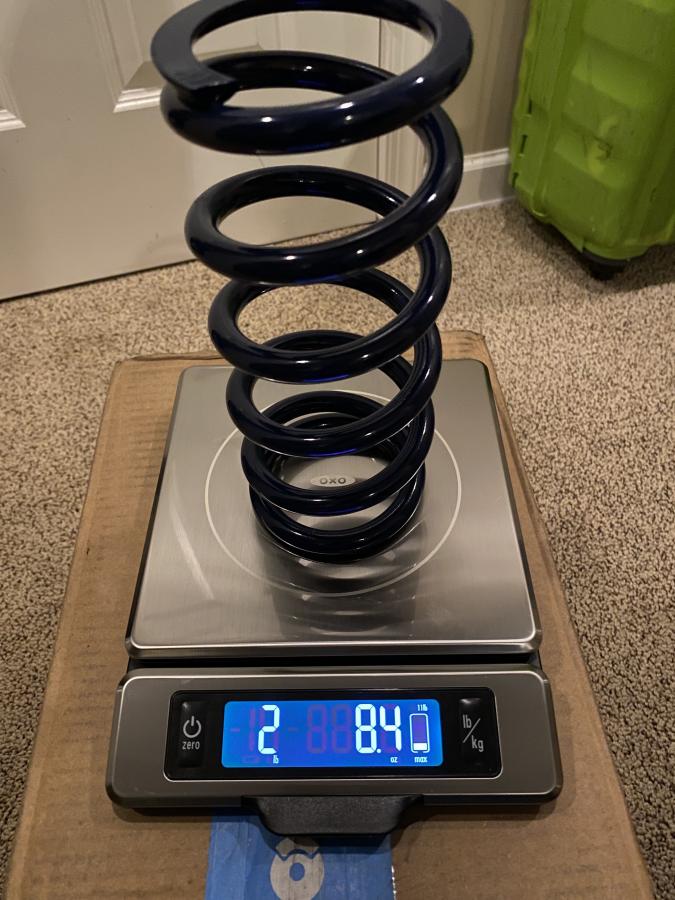

              Did a spring-off test to make sure the wheel wouldn't rub with the amount of bump travel I calculated I'd have with the new 203mm Hyperco springs. Seemed to pass, so I'm proceeding with the spring swap to gain bump travel and hopefully prevent coil bind.
              Also decided to break in a new kitchen scale by weighing the old and new springs.
              Old 178mm Swift:
              Click image for larger version  Name:	IMG_6251.jpg Views:	0 Size:	80.1 KB ID:	189468
              New 203mm Hyperco:
              Click image for larger version  Name:	IMG_6252.jpg Views:	0 Size:	92.1 KB ID:	189470
              Only 6.6 oz difference per spring.
              Surprisingly to me, the Hyperco only weighs 0.1 oz more per mm of length. I expected a bigger difference in favor of Swift given the hype.

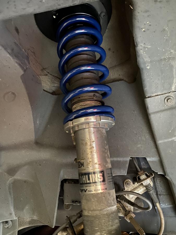

                ​After some minor drama, the front coilovers are back together with 203mm Hyperco springs in place of the old 178mm Swifts.
                Click image for larger version  Name:	IMG_6288.jpg Views:	0 Size:	76.1 KB ID:	189988
                Looks like about 20mm of preload with the spring perches at their absolute lowest setting. This yields a roughly 50/50 bump/droop ratio at the point of bump stop engagement, by which point the springs should be delivering around 330 lbs more force. Hoping all of that makes bump stop hits less frequent and less horrible.
                Per the spring's spec, it should be at least 5 mm short of coil bind even when the bump stop runs out of give. So, hopefully no coil bind from here on.
                Though, ironically, I might never know because roads around here are night-and-day better than before. Which, honestly, would be fine by me...
                I put a few miles on the car since putting everything back together and it seems the noise I had been chasing is gone. So, I guess it was the worn camber plate monoballs after all.

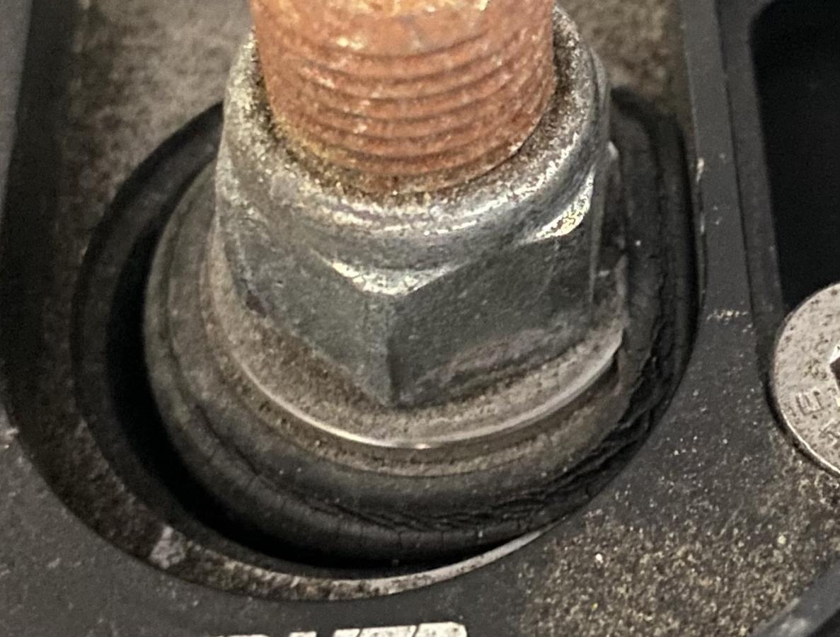

                  So you bought completely new plates instead of new bearings/seals? Do you have any pictures of the torn seals? I don't like the way the seals in the E46 M3 Hybrid plates work, but they are what they are.
                  2003 Imola Red M3 w/ SMG
                    #69
                    Correct. Mainly because I didn’t know what was involved, couldn’t find instructions/guidance, and didn’t want to risk another project, more delays, etc.
                    Now that I have everything apart, it looks pretty straightforward TBH.
                    This is the only pic I have:
                    This is of the one with the play in the monoball. The other one wasn’t all smashed to the side like that but its dust seal had similar looking cracks, which turned out to be all the way through.

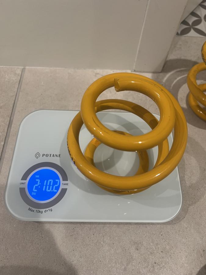

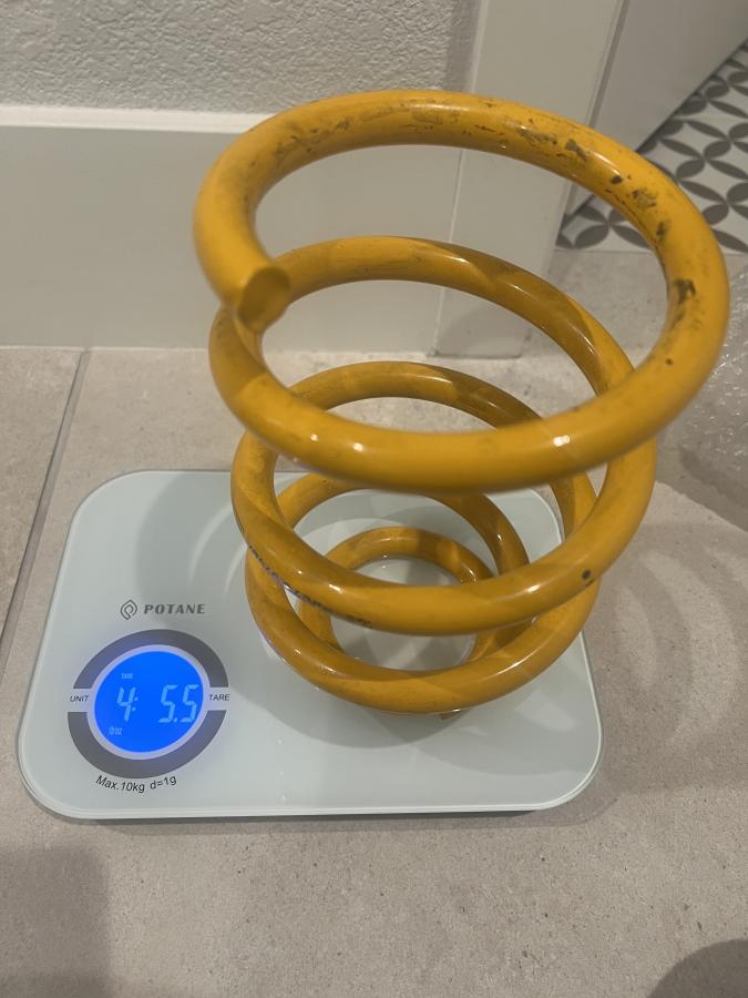

                      Thanks for this great thread and review. I thought I would add some spring weights to your thread for data points.
                      Based on this, due to weight, I think I'll need to find new front springs. These are for e46 m3 btw if it makes a difference.
                      Front Ohlins RT
                      Click image for larger version  Name:	IMG_8625.jpg Views:	0 Size:	64.8 KB ID:	276332
                      Rear
                      Click image for larger version  Name:	IMG_8626.jpg Views:	0 Size:	57.5 KB ID:	276331

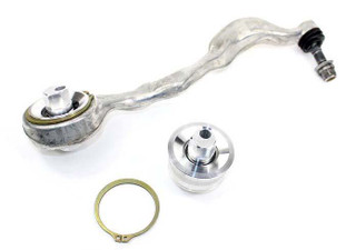

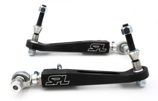

                              SPL (note not SPC) make adjustable front camber arms for the E9X M3 :
                              Personally I’d look to replace that inner Rose joint with something from SPC’s range of xAxis sealed monoballs :
                              Specialty Products Company | SPC Alignment | The Automotive Alignment Leaders
                              Or utilise an upgraded though OE type rubber or poly bush.
                              SPL also make adjustable caster bushings for the E9X M3 :
                              Utilising both the SPL components would enable you to use the stock rubber top mount whilst giving you the ability to adjust the camber and caster albeit with the added benefit of far better front suspension location.
