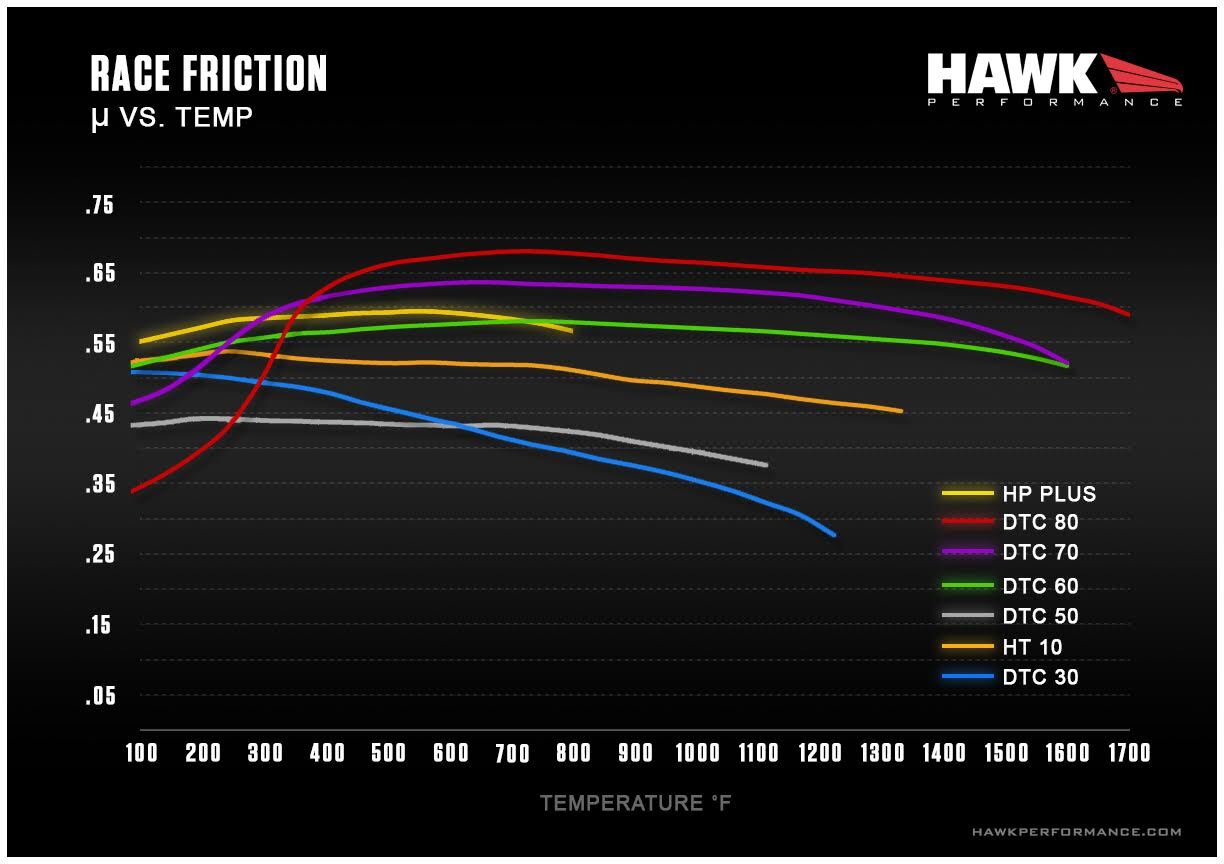

    1. Brake pads: Staying within FCP Euro’s catalog, I want as much fade resistance as possible without having operating temps that are out of reach for street tires and stock power. Given those criteria, it looks to me like the best option is Hawk DTC-60. Way overkill, but seems to tick all the boxes. Hawk's mu-vs.-temp curve for it (attached) looks really flat even down to low temps, it'll have all the fade resistance I'll need, and no one seems to have deposit issues with it (unlike, say, Ferodo DS2500). Does this make sense? It doesn’t look like FCP Euro sells anything worth trying, but I’m open to suggestions.

                      In my opinion DTC-60 is overkill for a novice driver, the HP Plus will most likely be sufficient for your tire choice. If you are experiencing brake fade in the novice group with HP Plus, and your brake fluid is fresh, then more than likely you are overbaking as fast corner entry speeds can be scary.
                        When you say DTC-60 is overkill, do you mean it'll hinder my development by hiding mistakes the way R-comps would? Or just that it has excess capability that I wouldn't use?
                            There’s no learning disadvantage to track pads. If you have faded them on the street, seems like a no brainer to me.

                              My opinion: Go straight to dedicated track pads. I got some advice from people and went with HPS pads, and was told I could just buy better pads once I got faster.
                              Well 3 track days later I've worn completely through 1 set of front pads and have severe pad deposits. Just put in an order for a set of DTC-60s through FCP with the Black Friday discount
