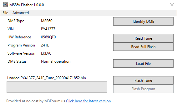

    Another update:
    Cosmetic stuff:
    • Added an app icon. Definitely subject to change, just wanted to try
    • Added a little note that the application is provided by free by this forum, and a have a link to this thread for the latest version (of course for the time being you need to contact me to download a copy)
    • Changed some text notifications
    Functional changes:
    • Sped up full reads by skipping over areas that should be blank. Should bring the total read time down to approximately 45 minutes
    • The long read option is still available in the advanced menu
    • If the read file size is smaller than expected (i.e one of the read requests failed), the application won't save those dumps

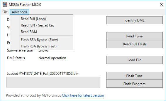

    Another update
    Click image for larger version  Name:	MSS6xFlasher.png Views:	0 Size:	15.8 KB ID:	12510
    -Changed up the layout a bit.
    -Eliminated the full binary checkbox, there is now a separate button to read a full program
    -Read RAM and Read ISN / SK are now under the "Advanced Menu" -- shift+click no longer does anything
    -Added current byte being read/written to the status text
    -Added a status message noting if a read has been completed
    -Progress bar is now colored #009ADA
    Thus far the application feels pretty safe. Even when a flash does fail due to disconnected power or so, the DMEs are staying alive. So I'm feeling comfortable for a wider release soon.
    Anyone have thoughts on a different name for the application? Also anyone have any ideas about a logo, icon, etc? Something that emphasizes the relationship to this forum would be preferable.

    Another update:
    • Added patch to allow reading protected memory segments
      • This will be applied any time an RSA delete or Full Write is done
    • Added ISN reading to the MSS65
      • It will prompt you to do an RSA Bypass if it can't be read
    • MSS60 SK read will now attempt to read it directly before dumping RAM and searching for it. Should be a little faster if you've already patched an RSA delete
    • Changed name/directory structure a bit
