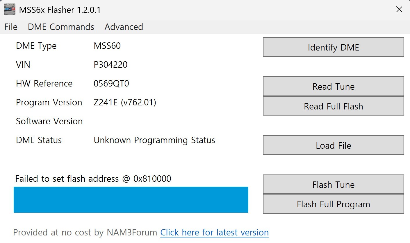

        Hello, I need some help...
        I encountered an error while flashing,
        so the DME status is displayed as Unknown as shown in the image, and the writing process stops midway.
        Recovery with WinKPF also fails.
        I discovered using an acquaintance's BDM tool that the left CPU is locked.
        I have purchased a u-Link NT and am currently waiting for it to be delivered.
        How do I unlock the left CPU using the BDM tool?
        I also hold fg-tech.
        I need help.​
