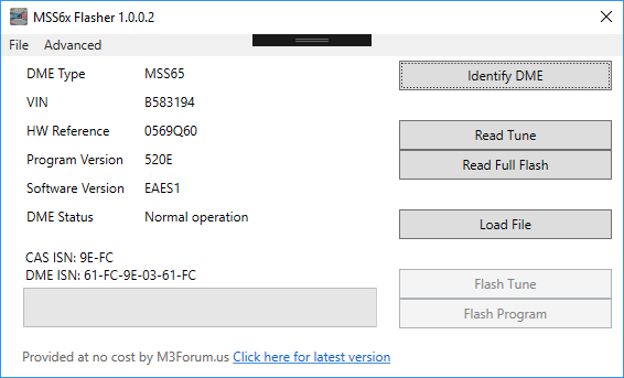

                  Minor update to the app. Only new function is when you read the ISN from the MSS65, it'll show the CAS format in addition to the DME format (like below). Otherwise some typo fixes.
