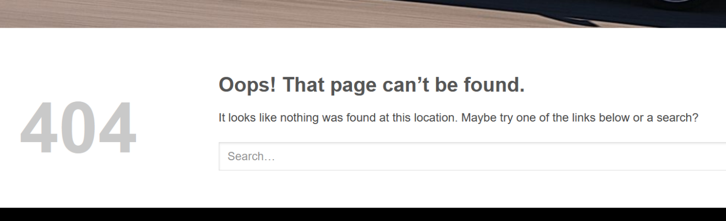

                                Went to purchase the ​K+D-CAN cable flashed with EdiabasLib firmware but the page is now down and unavailable. Will the cables be available for sale again?
