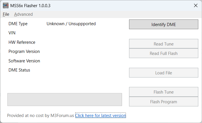

                I downloaded and ran MSS6X Flasher application. When I run I get this screen:
                It looks to be disabled for some reason. Has anyone seen this before who may offer up some things to remedy it?
                I am looking to use it on my 2006 BMW E60 M5. Thank you.
                Henry
                  Double check you have the required files in place, ediabaslib.dll is in the same folder as the exe and that the config points to the correct location to the ECU/PRG files.
                    Yes, Ediabaslib.dll is in same folder as the executable MSS6X Flasher.exe which are in:
                    D:\BMW Diagnostic Software\MSS6x Flasher\
                    I have both MSS6X Flasher and Ediabas installed on an expansion hard drive formatted as D: drive.
                    I changed the ecupatch in the config file MSS6X Flasher.exe.config to reflect this:

                      I installed on my Dell Laptop with Windows 11 Pro. Is application compatible with my setup. Are there any special settings I need to address in order to run on my system?
                      This is frustrating because I was running the software on my old laptop with no problem.
                        Did you try compatibility mode (win 7) - administrative start?
                        Make sure your obd2 cable is set up properly. Needs to be flashed with ediabas firmware, and then set your device settings so that it's listed as COM1 with latency @ 1ms.

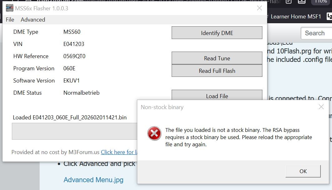

                          I attempted this on my 2008 E90 M3 6mt, that came with Active Autowerke tune from previous owner, and ran into a few oddities/issues:
                          - After the Read Full Flash completed, I went to 'Read ISN / Secret Key’ as recommended and I got the message: "Could not find secret key".
                          - I then attempted the RSA Bypass; clicked Load File using my same full file dump, chose Slow option and got message: "The file you loaded is not a stock binary. The RSA bypass requires a stock binary be used."
                          I'm guessing both of the above could be cause of the AA tune? I don't have the stock tune file for my car since it came with the AA tune from the previous owner, who had it installed with full AA exhaust with HFC.

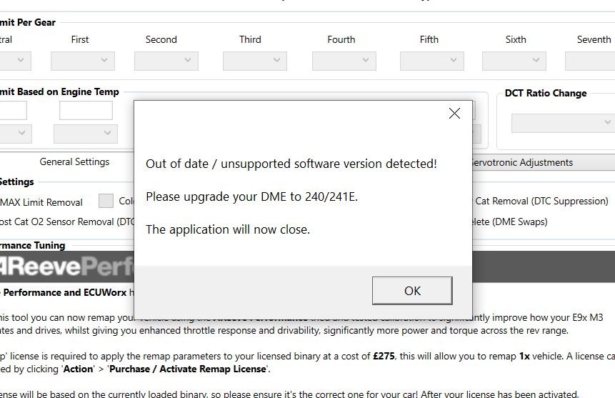

                          - Lastly, I booted up the MSS60_Binary_Modification_Tool_V1.9.5 to see my full dump file settings, and got message: "Out of date / unsupported software version detected! Please upgrade your DME to 240/241E."
                          Thanks in advance!

                            060E is very old software, which is why my tool is advising you to upgrade, clearly if you do this you'll lose your AA tune, however it will allow you to perform an RSA bypass aftwards as it'll be back to stock.
                              Do you mind sharing the 060E full read here?
                                Oh interesting that Active didn't update the software when doing their tune, the previous owner had it done only like a year or so ago at Active's HQ here in Miami (same time he had them do the full exhaust install, it was a package).
                                Slightly unrelated but I wonder if my software being so out of date and with their likely ancient tune is causing another issue I'm having with the tach warmup dial going on the firtz and getting stuck at random rpms even with the car fully warmed up (doesnt force a rev limiter though). Also I am not familiar with the software updating process, did some google searching and read a few threads but didn't seem to be a definitive guide to the process, could you point me to one if you know of?
                                Yes of course, I attached the Full Read 5120kb file here thanks!
