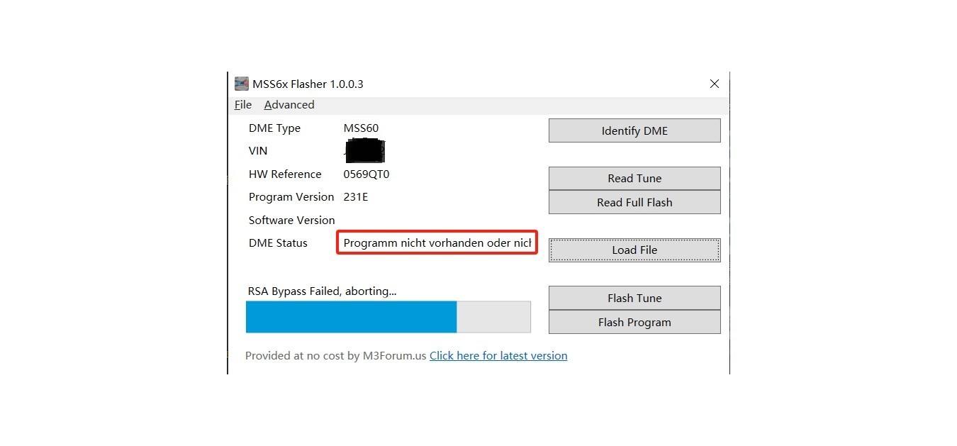

  • MpowerE36
    replied
    I think you only write a partial that is why your ecu is still locked. You need to overwrite the program to unlock it.
    Just answer to your mail. It went to my spam.

  • patator03
    replied
    Hi MpowerE36 and thanks for you quick reply !
    I already try to flash stock file with my AUTEL diagnose , seems to be OEM now , but maybe still obd locked
    I wonder if this error is due to my cable , or obd locked . You confirm it is obd locked ?
    I can write ORI file with another tool ( AUTOTUNER ) , but i'm really scare to write something without having a real backup/full read
    Do you think there is a safer way to write oem program ?
    I just bought 5 minutes ago ecuworx cable , in order to be safe and have proper flash tool
    By the way i tried to join you by mail , in order to take you tool for unlock my CPU ^^
    Leave a comment:
  • MpowerE36
    replied
    If you don't care about your current tune, you can write an oem program and tune then make your full backup.

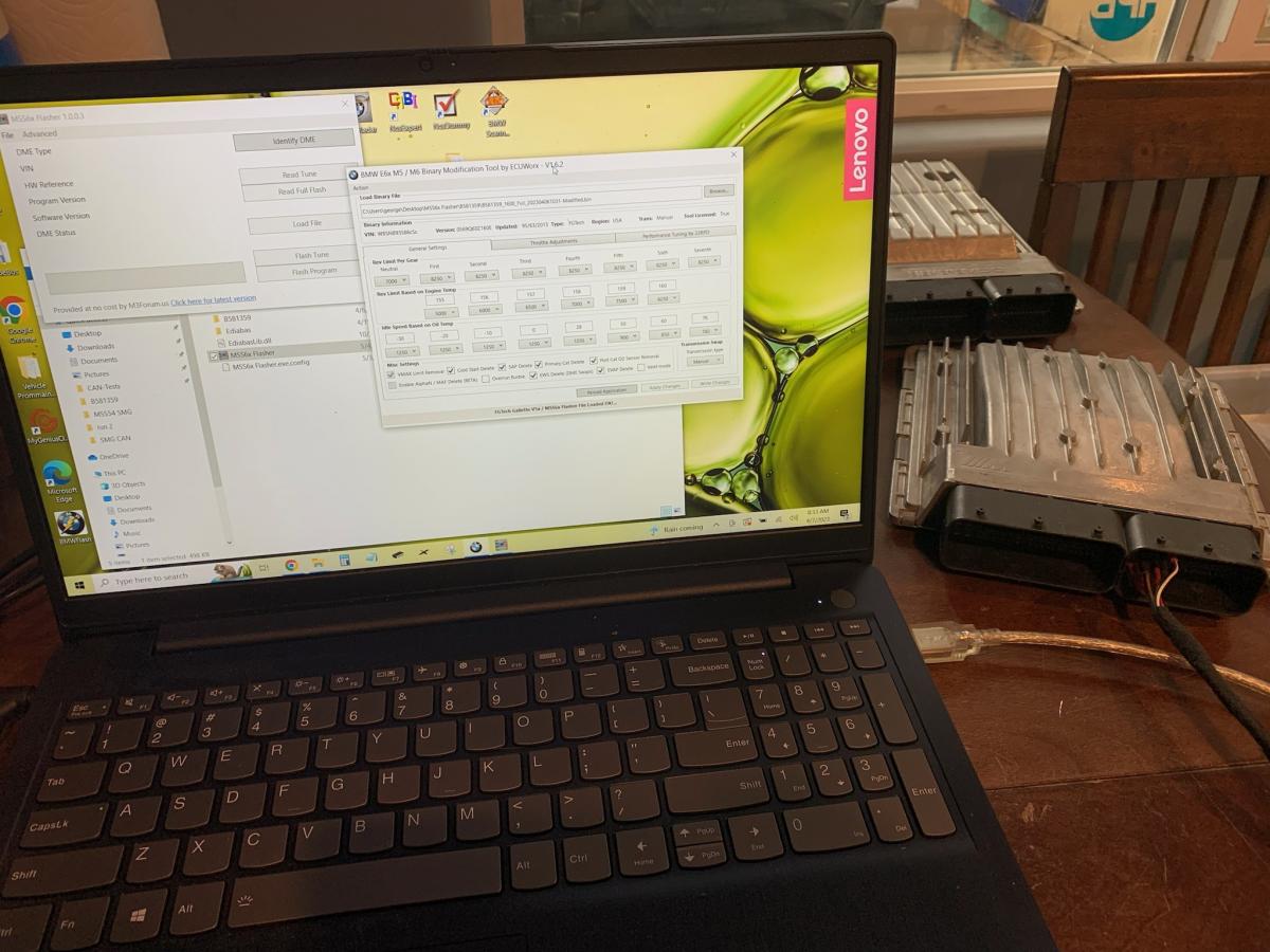

  • kaiv
    replied
    Used Terra's flasher for the first time; indent, full read, ISN/secret key, RSA bypass and reflash with edited file. All went smoothly and worked perfectly. Thanks Terra and contributors!
    Edit: Answered my own question :P

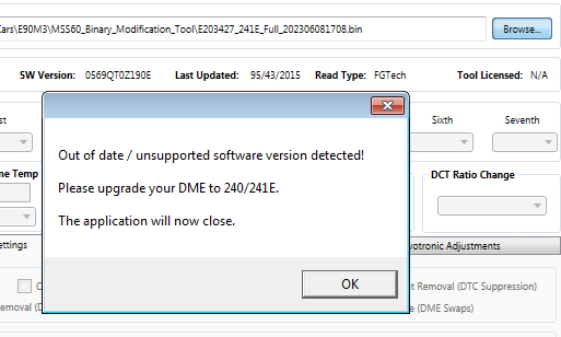

  • TANKER_WX
    replied
    Originally posted by Martyn View Post
    That's probably where I'd start.
    Do a ZUSB update to 240/241E with WinKFP to get you back to a 100% stock place and then try again.
    Sure, thx Martyn!
    I will try this procedure.
