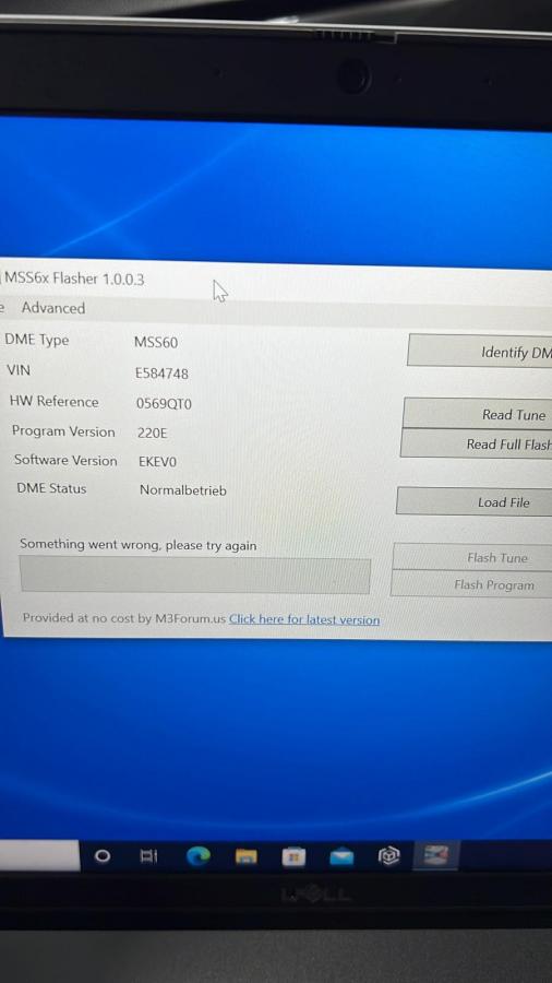

    Hi All,
    I'm from France,
    I have a 2007 M3 manual with (i suppose) an ESS map, retrieve as 240E by MSS6x Flasher but impossible to read, i have got this message "“Something went wrong, please try again” ​" when i have tried to read it.
    so with winkfp and daten V60 i have writen an OEM 241E map and program with success (car start and drive 150 km)
    after that i have done a full read with MSS6x Flasher with success (1h read time)
    i have begin to try to identify maps with winOLS but i could'nt find any values at "standards" offset (Vmax, manual gearbox ratio, ignition timings) and when i found one axis scales and datas are Inconsistent
    We have to compare the map with a friend that have an another tool (dimsport new genius) and with his car map and we find that the map are not the same size (his file 5,25Mo and mine 5,00 Mo) and the dimsport tool says there is a problem with ram size in my map extracted by MSS6x Flasher, see capture after
    I don't have done the RSA bypass write with MSS6x Flasher, is it the origin of the problem?
    What do you think or advice about this case?
    I want to do some modification with Ecuworks in the first time but if the full read is corrupted i don't want to modify it and rewrite it in the MSS60...
    I think before i write it i would be able to find "standard" value via winols at the commons offset for them
    terra and MpowerE36 and others if you have any advices, thanks
