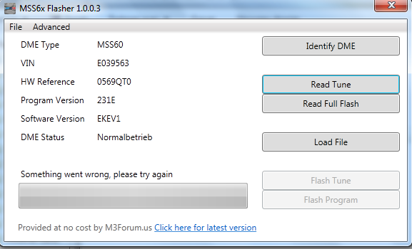

Hi,
I tried to read via OBD the MSS60 of friend which has an ESS tuning compressor on his engine but it seems to be OBD locked. MSS6x flasher succeeds to identify the ECU but when I click on “Read Tune”, I have “Something went wrong, please try again” (see picture attached). terra do you know what can cause this message ?
Unfortunately this DME (2008) is injection BDM locked, so I was only able to read the ignition external and processor memories.
Does someone have a solution to read the injection memories ? I know it is quite a challenge via BDM.

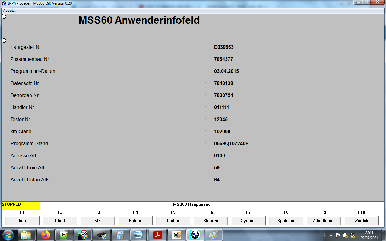

Strangely, INPA says that I have a 240E program (AIF area) but in the ignition binary it is a 231E program as MSS6x says. Is 231E program a custom program "created" by ESS tuning ? Can it causes my OBD read problems ?
