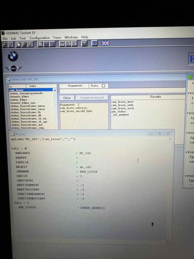

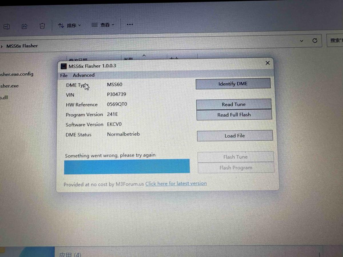

                          Hello, I would like to ask you a question. My car had ESS installed before, then removed and DME reverted to 241E.
                          I'm using MSS6X to read a full bin and I get an error after reading the RAM.
                          I read ram_leson with Tools32 and got Satz:1 / JOB_STATUS = ERROR_ADDRESS.
                          Can you help me analyze what causes this error?
                            In the argument field you should enter an address 0x########. Listed in the info field,
                            Code:
                            argument : RAM_LESEN_ADRESSE
                            type : long
                            comment : 0x000000 - 0xFFFFFF
                            argument : RAM_LESEN_ANZAHL_BYTE
                            type : int
                            comment : 1 - n ( 254 )
                            Did you do a full reflash to 241E? with bootsector update?
                              Code:
                              type : long
                              type : int
                              Can you guide me how to add this address 0x########? I am not familiar with toolset32 usage.
                              Thanks
                                I think your dme is still obd locked because you have the message "Something went wrong, please try again" in MSS6xflasher when you try to read your dme. If you don't care about your current tune, just write the correct original fullbinary with MSS6xflasher (Flash program).
