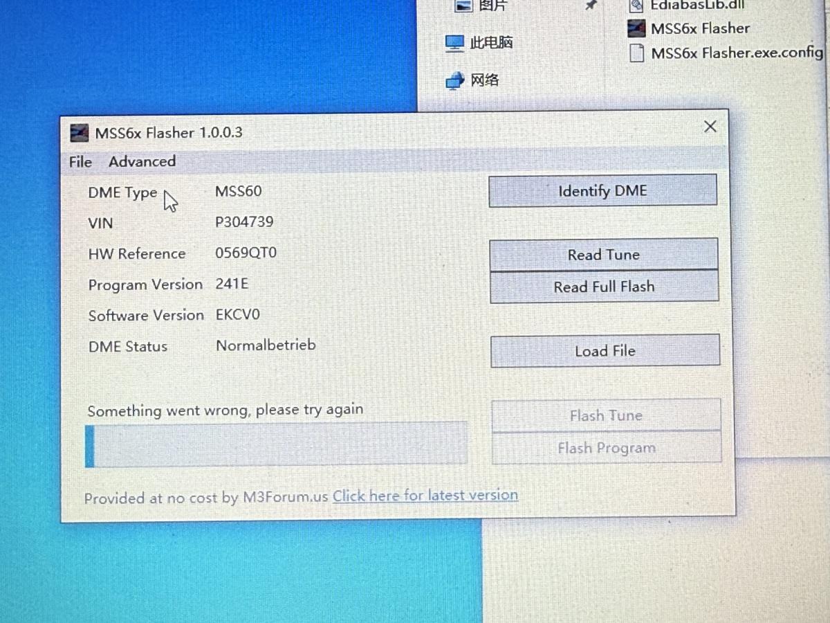

MSS60 OBD locked
    #31
    Originally posted by MpowerE36 View Post
    I think your dme is still obd locked because you have the message "Something went wrong, please try again" in MSS6xflasher when you try to read your dme. If you don't care abour your current tune, just write the correct original fullbinary with MSS6xflasher (Flash program).
    Yes, I don't care about my current tune. But I don't know how to write the correct original fullbinary.​ Can you tell me what to do? Thank you.
      #32
      Here your original fullbinary. You just have to load the file in MSS6xflasher, then clic on "Flash Program". You must have a good cable (with ediabas lib firmware) to write in your ecu. After that, you will be able to read it. I recommand to do a full backup of your ecu.

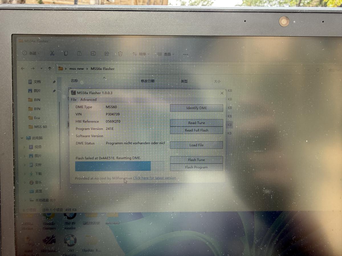

            I followed your instructions, but now the vehicle won't start. What should I do?
              #36
              It seems flash didn't correctly ended. What dcan cable did you use ?
              https://www.youtube.com/channel/UCwN...zf45mXp6PDOCzA

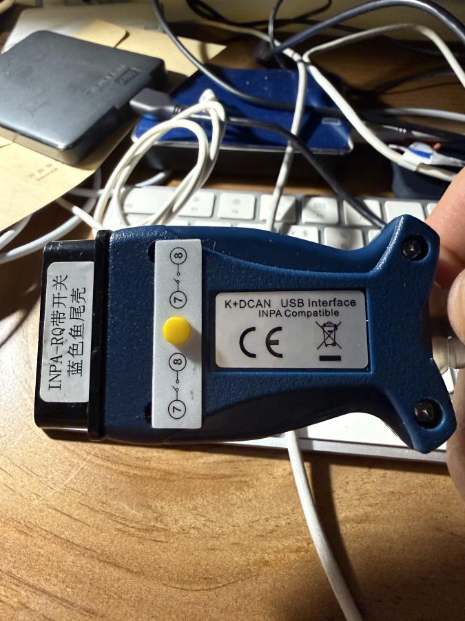

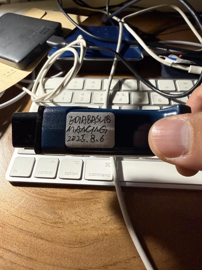

                #37
                My data cable looks like this.
                  #38
                  Sorry but I don't know this type of dcan cable.

                    The issue I'm currently facing is that when reading all DME data, the program runs normally but gets stuck reading the data and stops executing further. The longest I've waited was two hours, yet it remained frozen on a single value. Could you help me analyze what the problem might be?
                      #40
                      I've read it twice and arrived at this result, but I'm completely stuck on how to solve the problem. Could you help me?
                      “Something went wrong, please try again"
