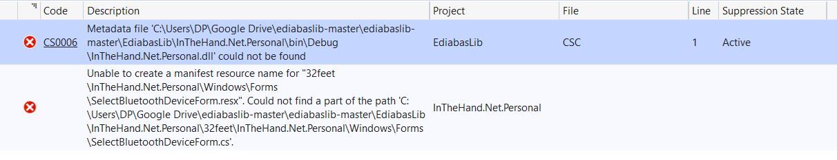

          Can I ask an unrelated question? I promise I will not bother you further with random coding questions. I've been unable to compile EdiabasLib. I downloaded it today and am using Visual Studio 2019. Using the make file EdiabasLib.sln, I am getting the following errors:
          Click image for larger version  Name:	Capture.JPG Views:	0 Size:	41.9 KB ID:	15115
          EDIT: Nevermind. I'll get the binaries.

            Try loading the ediabslib dll itself as a resource.

              thanks - I did get the binary - all is good. Would think it should compile tho.

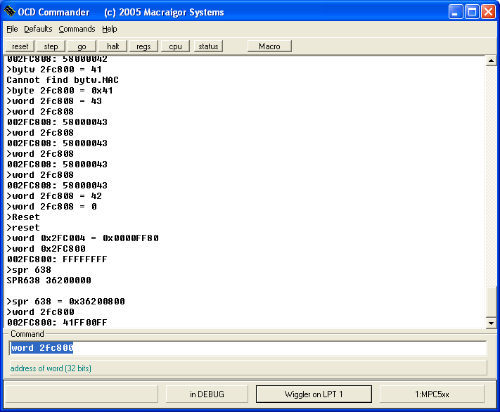

                      I got the interface working. Had to set the parallel port mode in the VM bios to "Output Only" instead of bidirectional / EPP / ECP. Doesn't really make sense to me since it seems like communications are going both ways... but who knows.
                      Click image for larger version  Name:	ItWorksIthink.png Views:	0 Size:	25.9 KB ID:	15380
                      This is my MSS65, but I'll try the MSS60 next. I guess I would just manually set the registers as noted in the reference manual
                      Edit: Meh, I clearly have some reading to do. Except you know, macraigor has literally 0 documentation. On this DME I can pretty much only do 1 command before I start getting junk or FFs back. I guess I'm running into the watchdog or something?
                      Edit: Sigh, I think I broke it. I managed to change the censor bytes from 11 to 00. But then when I tried setting to 01, all of the UC3F registers started reading as FF, and manipulating them seemingly doesn't work. DME doesn't boot anymore, and BDM100 still treats it the same as before.

                        Boom.
                        Click image for larger version  Name:	AndWereBack.png Views:	0 Size:	19.7 KB ID:	15419
                        Turns out clearing / setting the censor disables the UC3F array altogether, but you can reenable that by setting the IMMR.
                        Now I gotta see if I could make a script to automate all this.
                        Confirmed BDM100 will now read the DME (all FF'd of course). Now I'm just flashing back my OBDII backup (along with the shadow region from the MSS65 hoping it's the same here) and hopefully it will work.

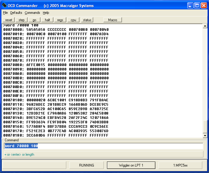

                            You have a factory unlocked MSS60 right? When you get the chance do you think you'd be able to read the shadow memory from it? CMDFlash just tacks it onto the end of the internal flash, not sure about others. I made the assumption that the shadow memory from the MSS65 is good enough (and it probably is), but I just want to be sure there isn't anything different.

                              I feel I have searched exhaustively and PM'd everyone who seemed to have even a shred of relevant information. There are few comments out there from people who thought they knew how to do it or even claim to have done it. But no one sharing any useful information or proof of the accomplishment.
