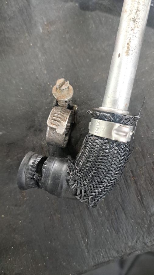

                Car runs fine now with ews off. The issue was a broken vacuum hose to to the brake booster. I tested the solution again in another car, even another ecu and it was running fine. So i knew it had to be the hardware.
                Thanks for your help and patience.
                  Kinda funny isn't it ;-). Good you solved it and posted the solution!
                  Been there too....

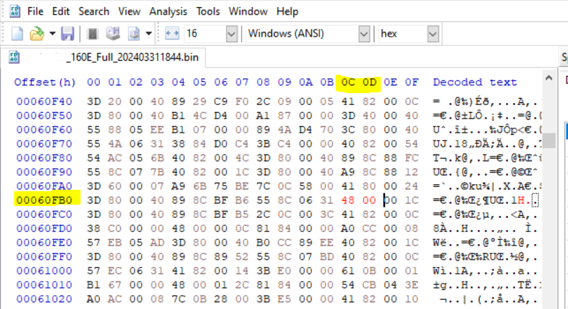

                    Did this today on my S65 DME with Software 160e. I was not able to flash the RSA-Bypass with the modified EWS-delete File. Got an error message that said the file can not be used because it is not original. So I had to use the original full-read in order to do the RSA-Bypass (I did not do a full-read after the RSA-bypass finished). Afterwards I was able to flash the modified bin file from before with "Flash Programm". When I compare the two full-read files (original one and RSA-bypass with EWS byte changed), they have more differences than only the 0x60FBC byte. That's probably normal and due to the RSA bypass? I used HDX HEX-Editor to modify and compare bin files.
